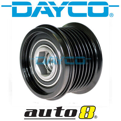

Alright so when i ordered my lightwieght water pump pulley it came with a matching alternator pulley option so i ticked yes, of course it was only when i went to fit the alt pulley i realised the fj has a decoupler pulley, basically im just wondering if its possible to swap the decoupler to a solid pulley, this would be mainly to remove the chance of the decoupler leaving broken down somewhere.
Any one who knows if its possible or whos done this please chime in

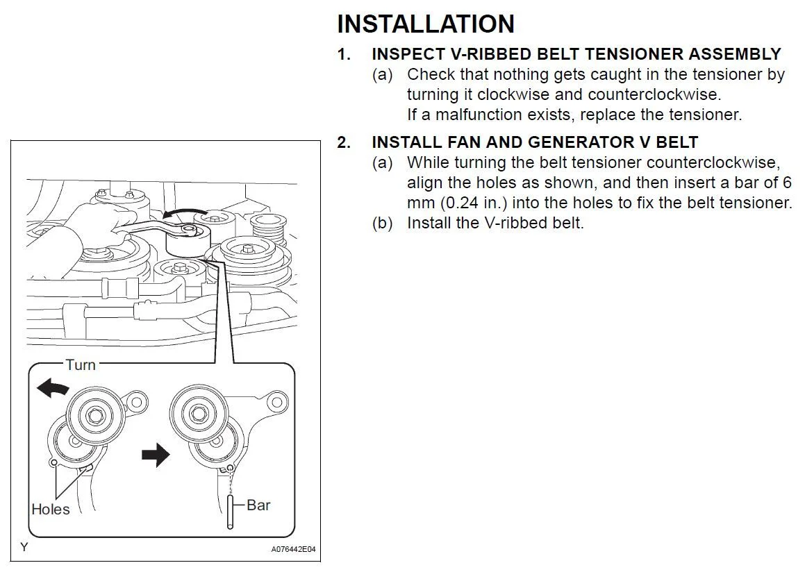

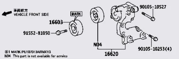

By decoupler, are you referring to the tensioner pulley?
