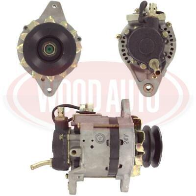

I have been thinking of trying a Toyota hilux 24v alternator. The plug is the same and comes with a vacuum pump on rear. It’s bit spendier but fleabay is littered with them. The specs are also nearly identical. Anybody on here able to convince me this is a waste of time and money?
Here is a candidate
