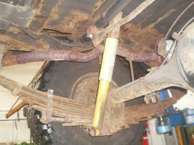

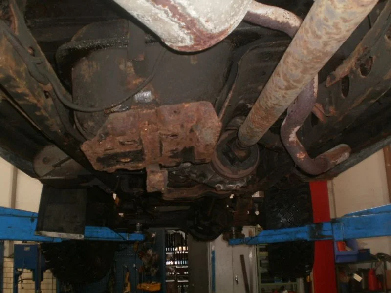

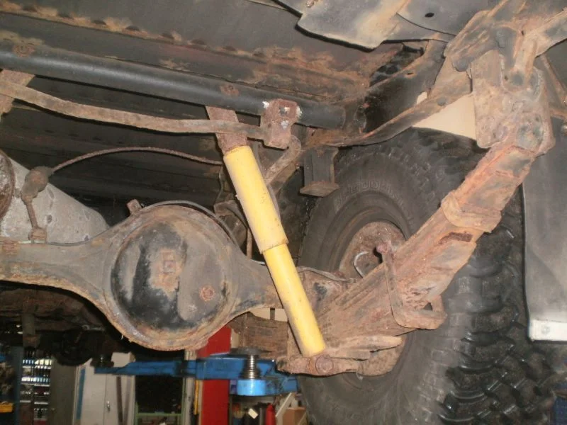

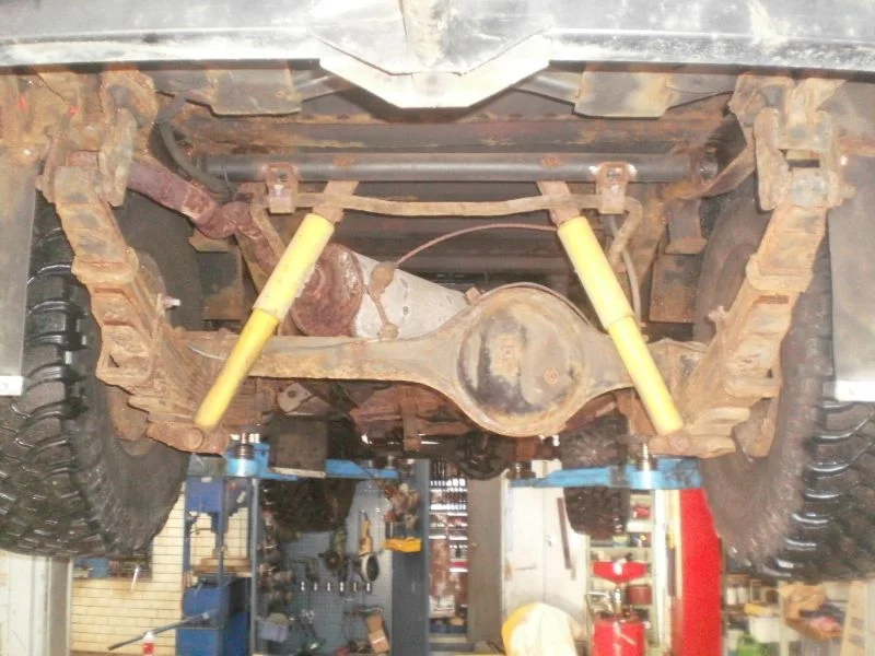

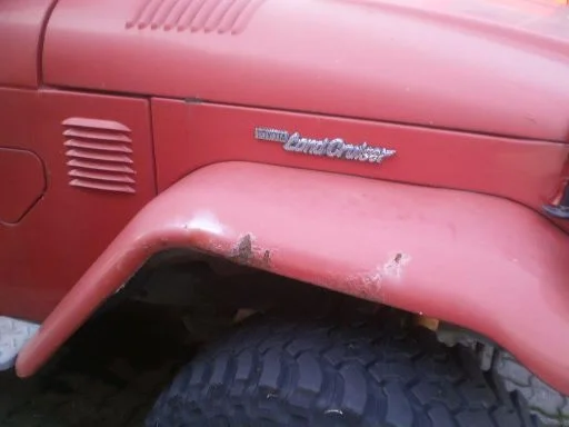

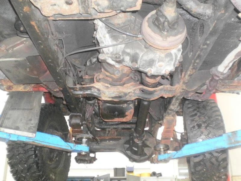

Hi all, being just a step away from purchasing a 1983 BJ45 lwb (troop carrier), having collected all possible and available information from thousands sources. Never ever restored a car, but enthusiastic enough to start now. Would love to know the opinions of all of you, experienced guys, if the attached pictures show a frame in a reasonable condition or a hopeless one, as they show the vehicle which I believe will be mine soon...
Appreciate the help
Regards
Miso
Those are mere flesh wounds. All joking aside, it is always good to actually poke around to see if anything is hiding behind the paint/grease on the underside. At least there is not a fresh coat of black paint hiding anything. How does the body look? Was this near the beach, or coastline?

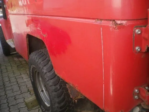

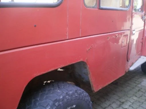

The vehicle is parked 1000km away from my place, so I have to judge the condition only by the pics. Yes, it spent all its life on an island, not too small though, but still close to a coastline. Good thing is that there is little chance of salty roads, as there is rarely snow in winter. The body looks OK according to the pics:
