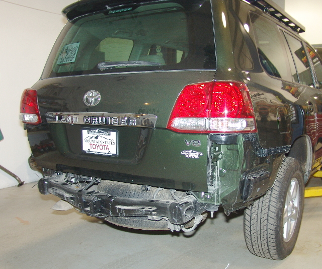

It is my understanding that in the US spec that the rear frame cross member and the hitch are essentially integral.
Here is pic I found of a 200, minus the rear bumper. You can see it's tucked up under the back pretty well. At a quick glance it looks like part of the frame. You can also see at the lower far right of the hitch is the plugin for the trailer lights that I was referring to earlier.
Thanks, that makes a lot of sense based on what I saw when I climbed under the other day - plug was in that exact spot as well.
