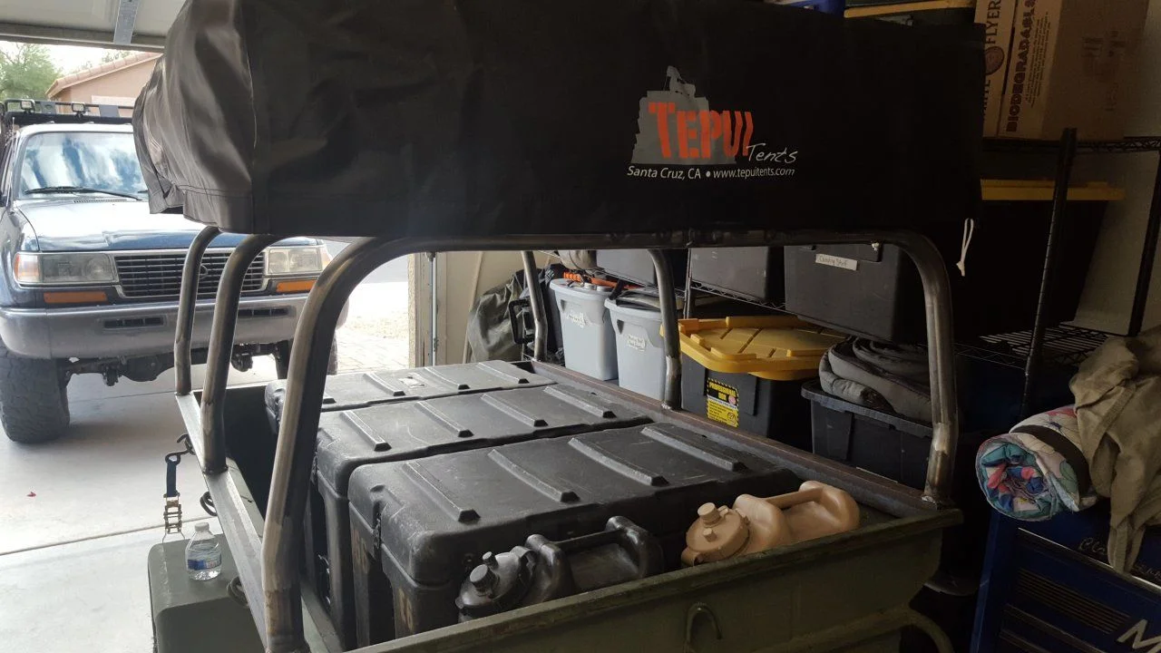

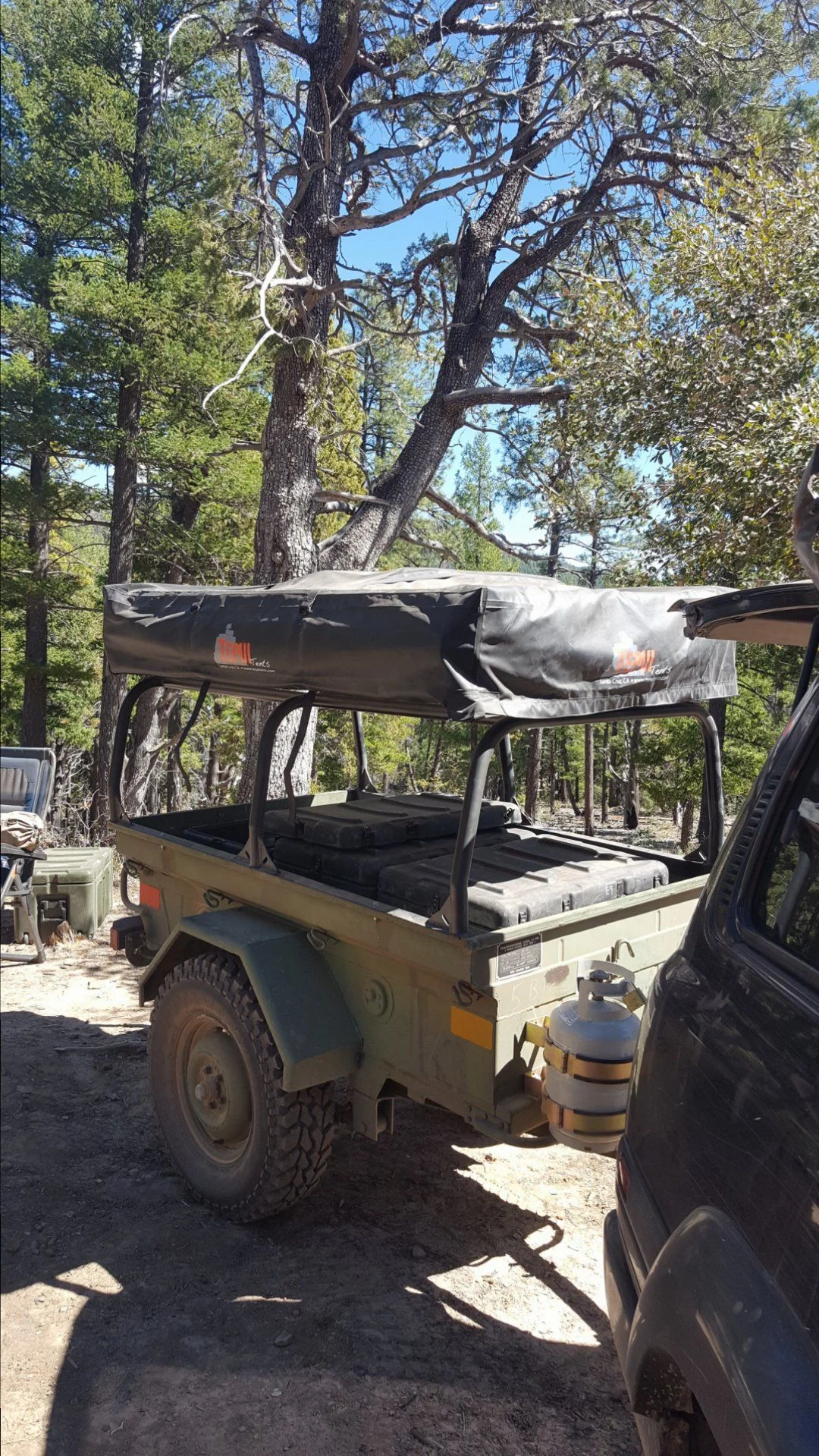

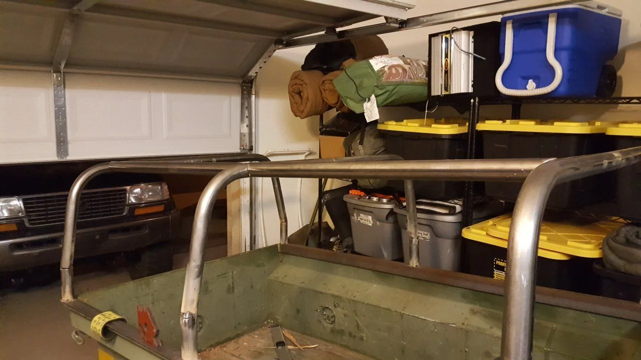

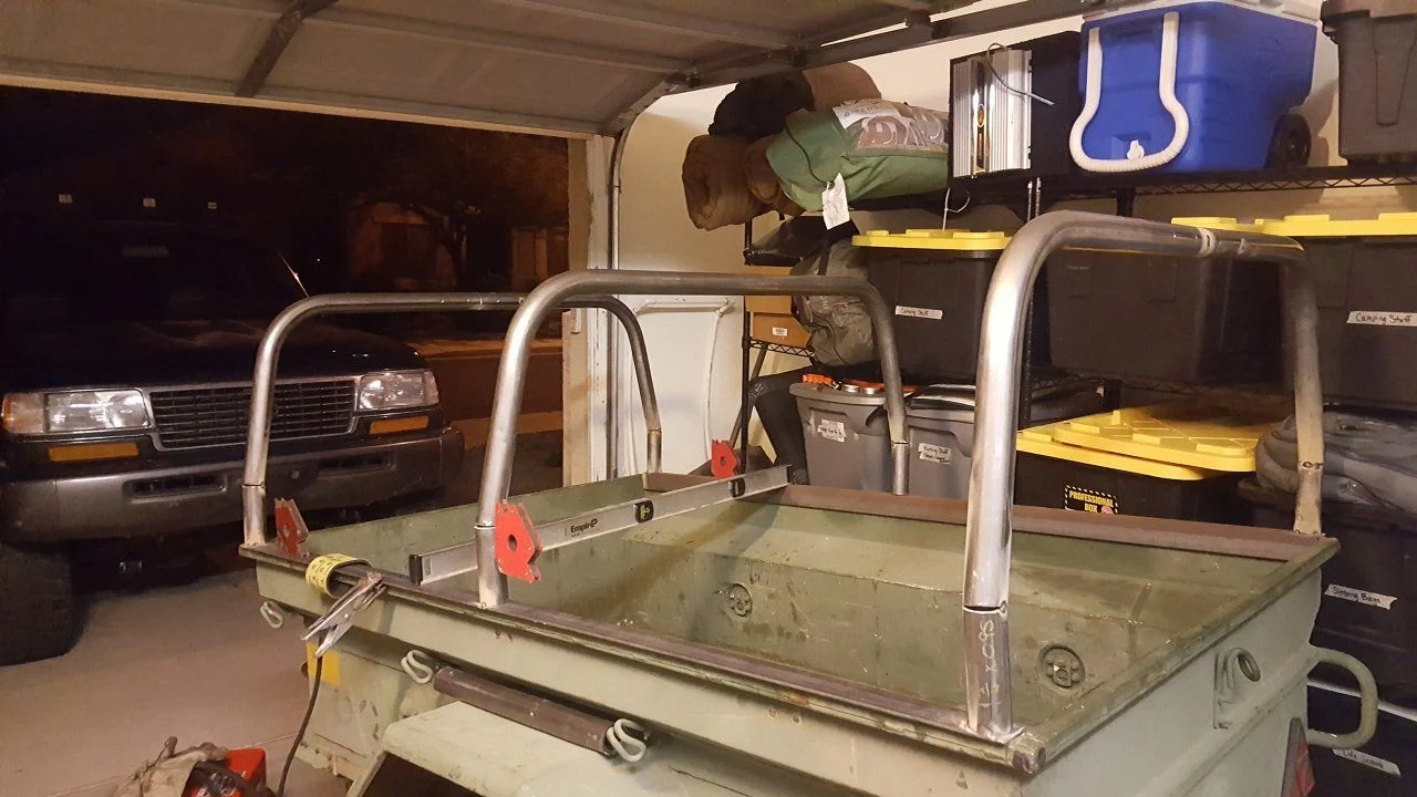

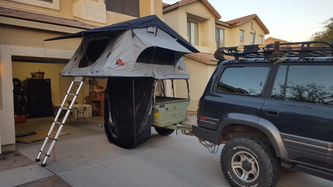

Had the trailer for about 3 years. With alot of boxrocket's help on the rtt. Finally went for it. I cloned all pros Tacoma expedition rack. Now to add all the other garbage. Hi lift, propane, co2, rotopax, kitchen sink? Lol will update as it grows.

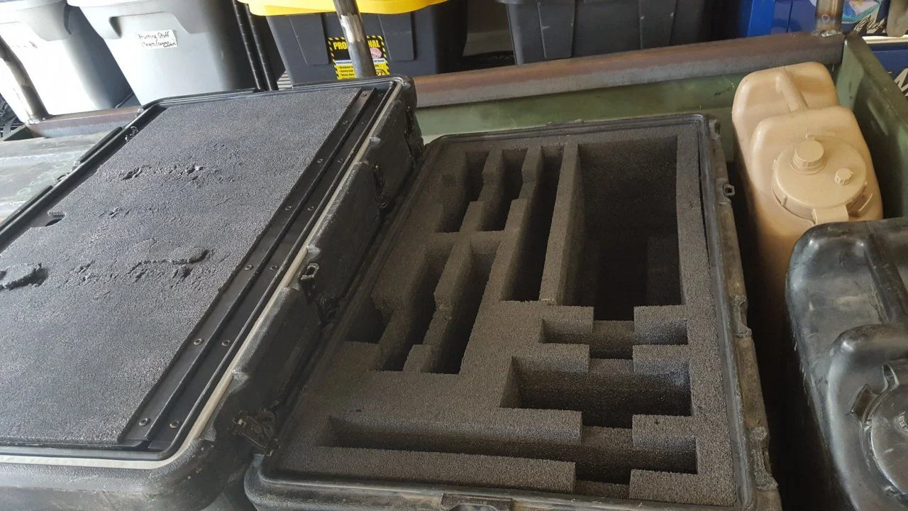

Picked up some waterproof hardigg cases today. foam can be removed thought I'd keep one for pots/pans. :worms:
I really like that tent rack. I'm gonna steal that idea! Avoids the whole lid/strut arrangement, with the height allowing easy access.
I could see a version of that with canvas sides to if you wanted to keep stuff a little bit dry or not so visible.
Pete
Pete
I had the all pro rack on my old Tacoma. Great rack and I enclosed it with tarps like you suggested..Canvas probably would have been better to use but it was temp.

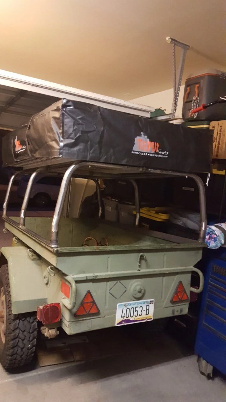

Got the tie down gussets burnt in. Really helps out strapping down items. I had 2 gravity chairs, and 2 full size coolers up top on the way out. 20miles rough road no issues. The hardigg cases I added are waterproof and air tight military cases that work amazingly well. I thought about adding a canvas cover but really don't need to with the hardiggs.
