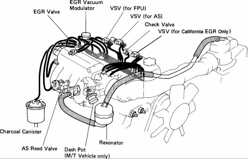

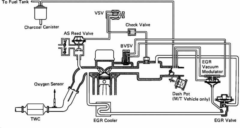

heads cut valve job whole 9 yards. put back together check timing fixed tvv valve that i broke and now still idles slightly rough and stumbles hard under acceleration. no codes checked for vaccum leaks ? what am i missing ? thanks
I think that your vacumm lines could be mixed up. Happened to me last time I pulled the valve cover off.
make sure vacuum hoses are hooked up right
check your ground strap
disconnect and plug the hose that connects to the top of your EGR valve.
then go drive it. see if its changed
if you that up wrong it will buck and miss.
then reconnect it it using the diagrams
did you make sure to time it correctly. mine did that when i did the top end and i just had the timing was just adjusted wrong. but thats my 84 22R
