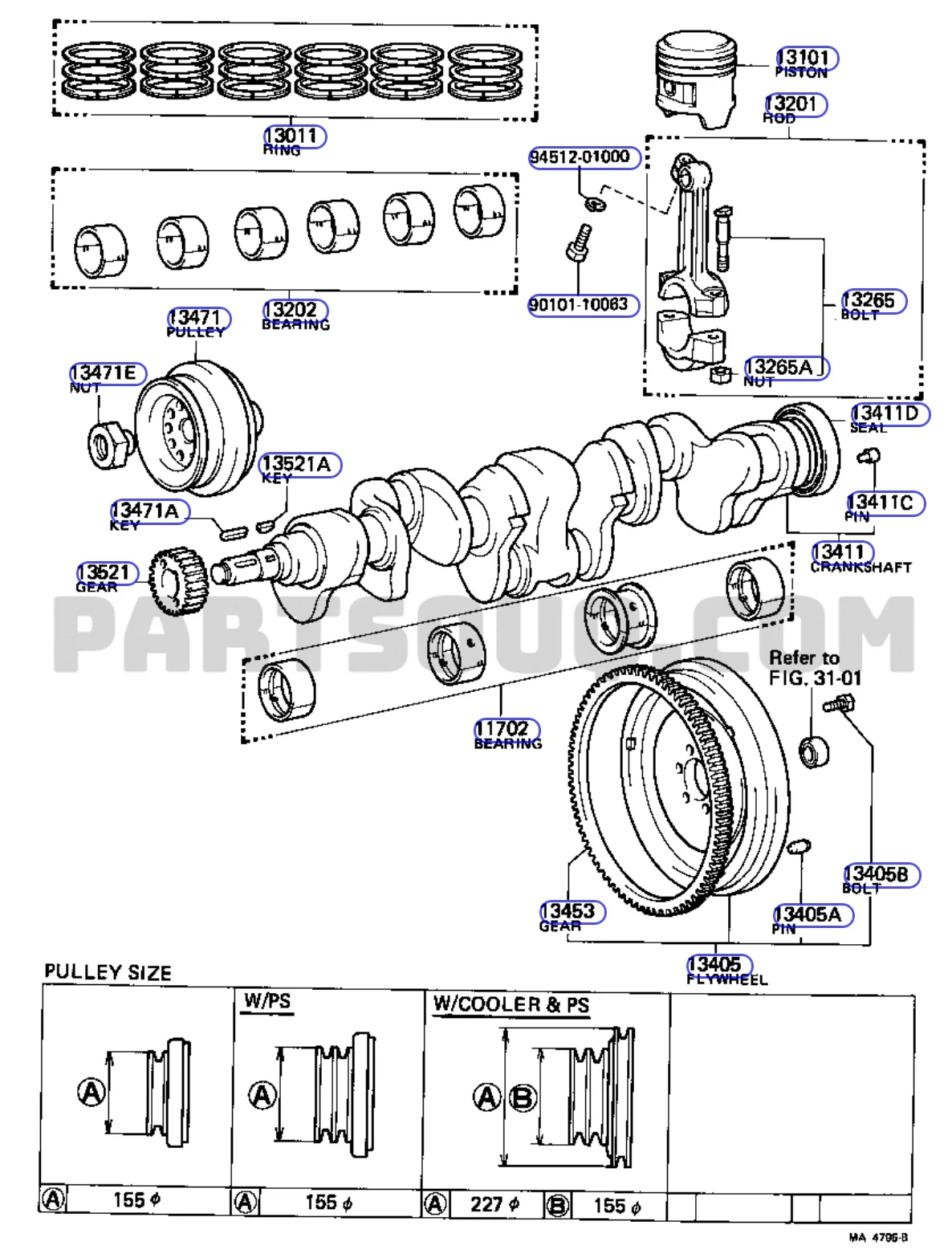

here's a diagram, it looks like its in the back off the crank area... I have another photo showing only the SQUARE one exposed beyond the timing gears. This tells me power steering one, ill check
Dan
The crank pulley key is a rectangular with rounded ends not a half moon.
However half moon keys are found not only on the power steering pulley but also on the timing gears for both the crank shaft and cam shaft.
The timing gears use the same part numbers (there is a difference in parts before/after 09/1986 but cam and crank use the same part numbers). The powersteering pulley has yet a different part number. There may be some dimensional difference that would allow you to tell. Perhaps you take the key you have and see how it fits in the power steering pump.
