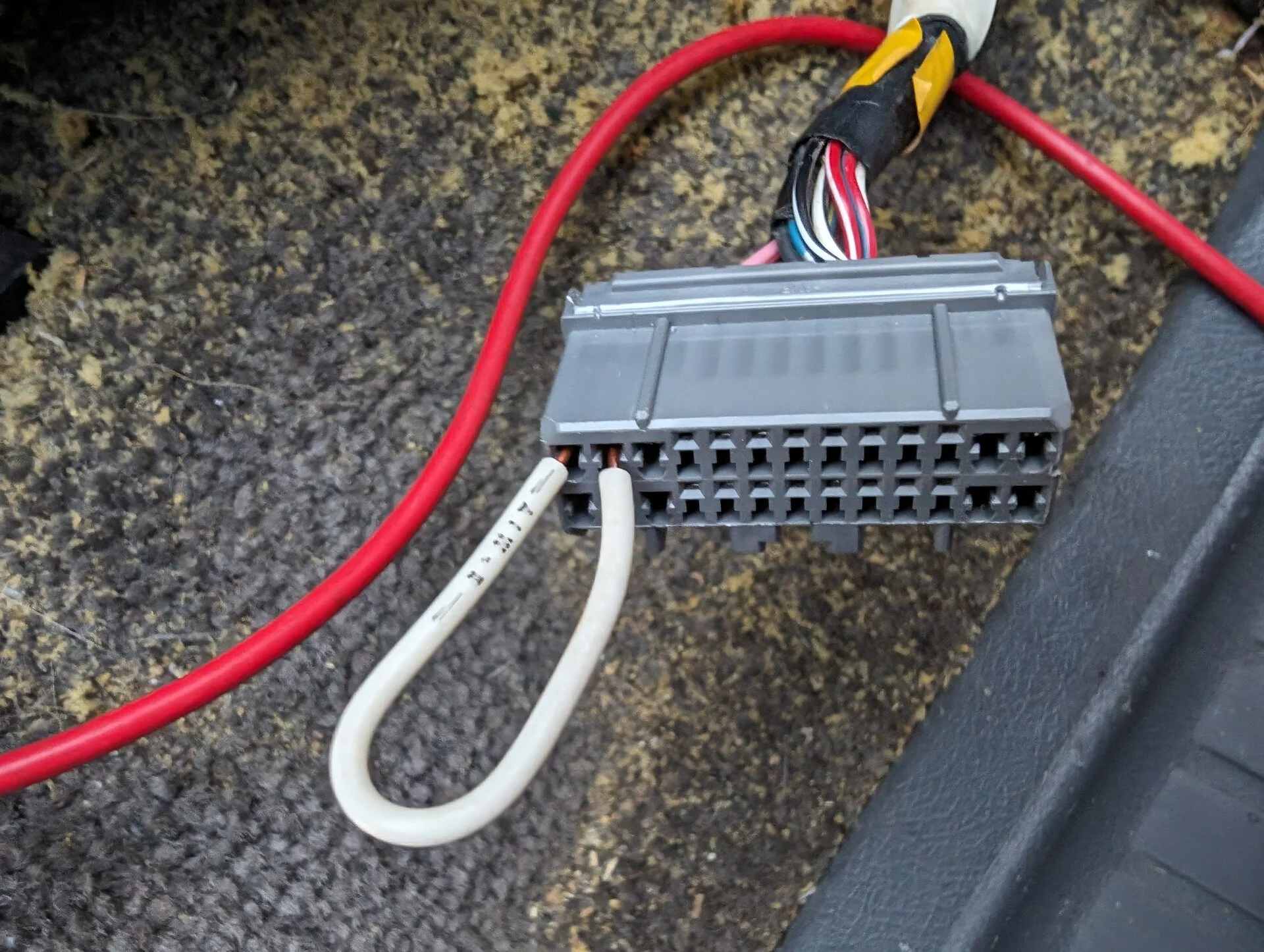

Hi there, so the alarm system on my 1991 fj80 keeps turning on by its self at random times and drains the battery completely if I dont drive it for a while, couldn't find much info on YouTube so came here, any information helps, how to fix, or how to get rid of the system, thank you for looking!

If it's the same TVSS as was in my '94, which is by no means assured, you can probably unplug the box (under the driver seat or in the driver kick panel i think) and bypass the starter cutout with a jumper wire like this.
