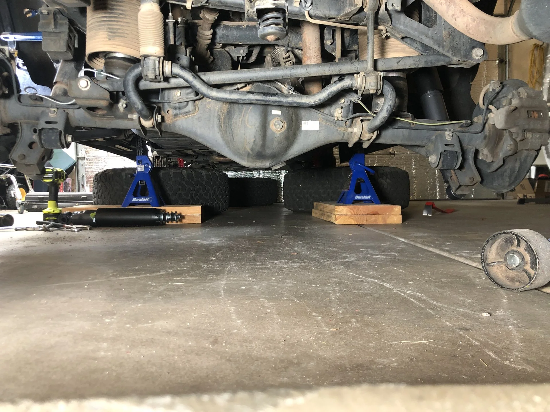

I have a mild desert run planned. What should I do to manage safety? I put the longer fcp shocks on in the back but immediately noticed the axle drooped more with them than factory. Do I need to whip up some limiting straps for the next few weeks or will I be okay if I don't go off camber hard or three wheel it? Anyone know where I can find limiting strap plans?

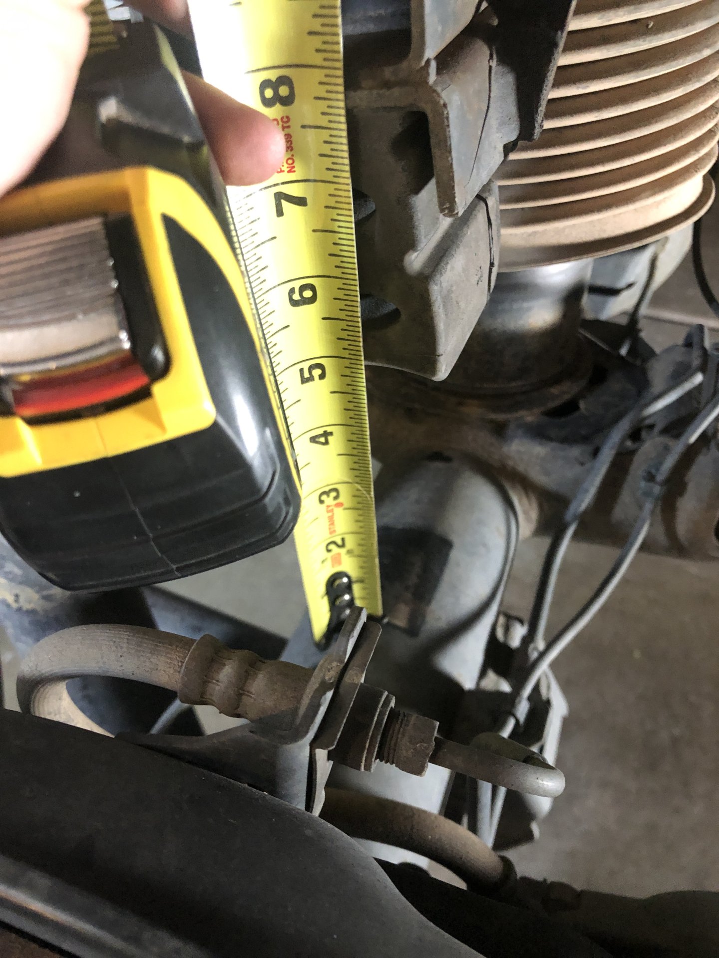

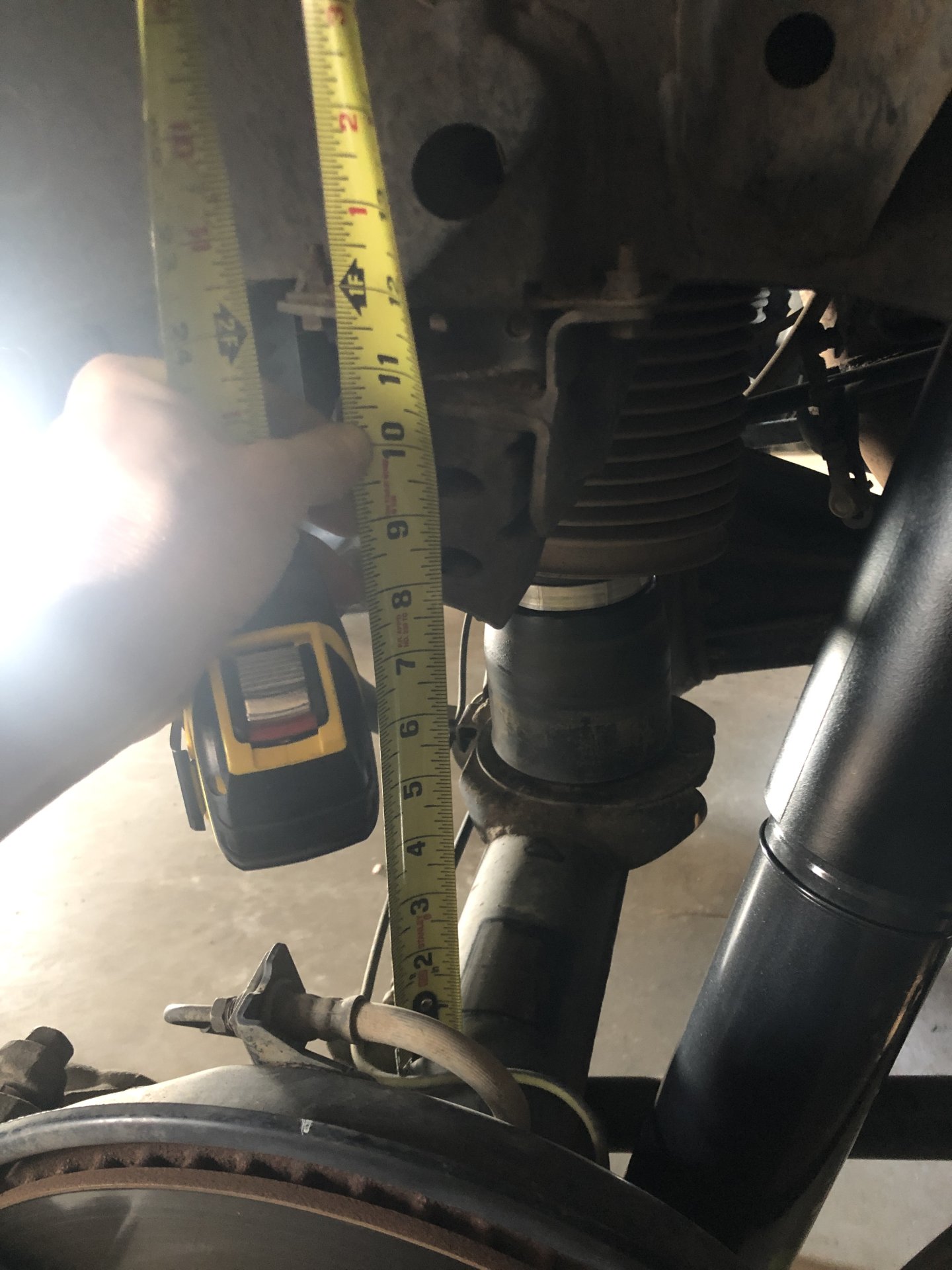

Passenger side has ironman fcp, driver still has stock. You can see the dramatic difference in droop. Its 4.75” axle to bump stops on one side and 7.5” on the ironman side. Afraid its going to rip the bags out of the mounts.
I thought putting a limiting strap on both side would keep me safe for the time being but not sure how to go about it.

You want as much droop as possible as long as it isn't hitting your shock limit. If your shock isn't at it's limit, then you good and don't worry about it. All it means is you'll get more articulation (read: suspension travel) on the trail.

With airbags? Doesn't the shock always limit down travel even with springs? The springs arn't bolted to anything so I always though the shock was the only thing keeping it all together when you de-load the axle (jack the vehicle all the way off the wheels at the frame). The problem is the airbags have a down travel limit so if I were articulated hard and the new shocks have a longer down limit, I could tear one or pop it out of the perch.
