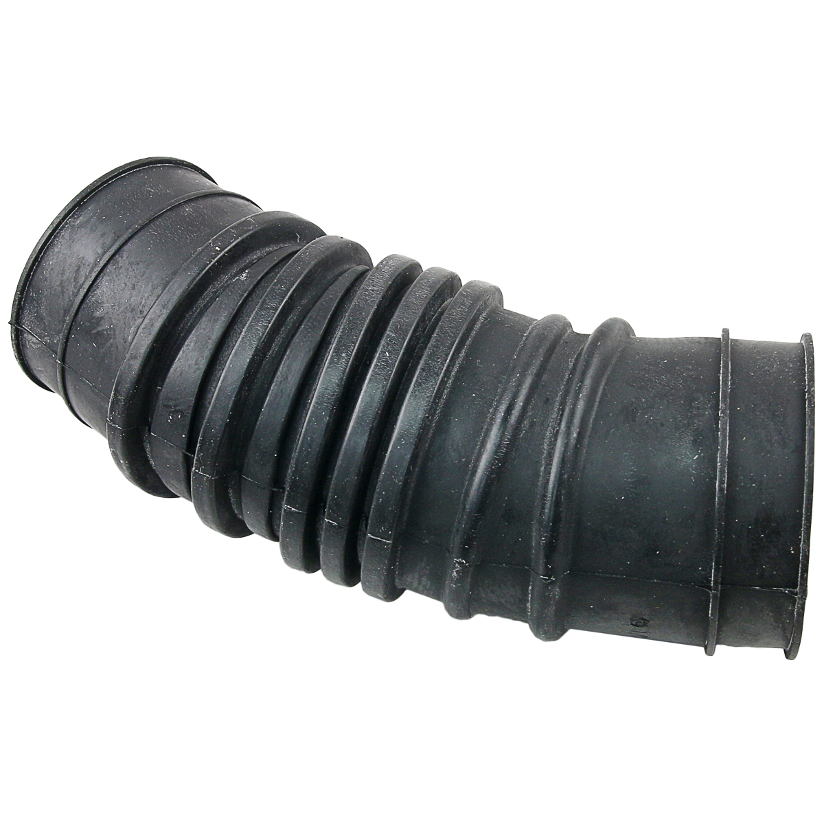

Ahhh whoops! Sorry, I was meant to say "rubber" hose not "silicone" hose🤦. I've updated my post to reflect this. The hose I purchased I can crush with my weak hand. The original one I can't crush with both hands!
Here's the one I purchased.
