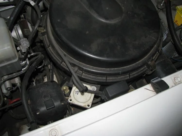

This is the FACTORY original sensor from a 98 onwards 1HD-FTE or 1HZ engine LC100. It will plug into your existing wiring harness on your vehicle, the connector will be sitting next to the aircleaner, 2 wire grey or white plug.
Ok, Thank you !!
The white square thing is the sensor, the wiring plugs in under neath it. 2 wires, if you short them you will probably activate your dash lamp(if there is a lamp in the socket)

Add your vehicle data to your signiture line, year, model, transmission etc. You will have the wiring in the vehicle already. Does your aircleaner have the little indents where the hoses would go as in the pic?
Ok, Updated profile. And Yes, my filter have two small indents (aprox. 1/8" )with small caps.
attachment.php
.... and if you find that the air filter warning light illuminates during hard acceleration, it could be that the short black hose connecting the white sensor to the filter case has slipped off the nipple. I found this immediately after a service. I guess it tells me that the air filter was inspected during the service!
