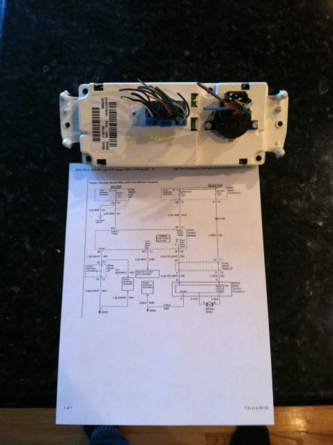

Here's the schematic for the a/c head unit:
I will be connecting 4 wires from this head unit, installing a relay to control the compressor, and also installing a way to trick the PCM into seeing freon pressure so that it will activate the compressor when called.
I just got the head unit so I will post more pictures as progress is made.

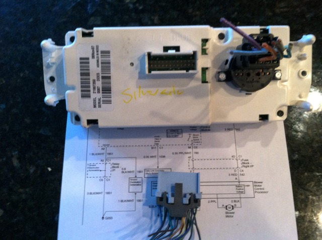

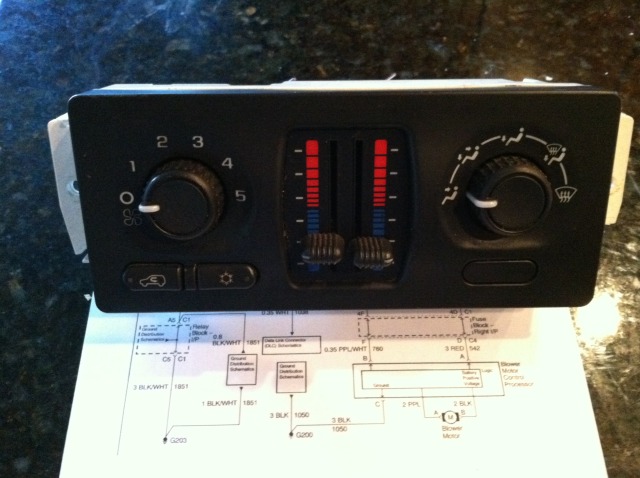

Here's the silverado head unit. Nothing fancy.
I bought this one because the ebay seller was including the connectors. Without these this project would be a lot more challenging:
I removed the connector that carries the wires I need. I will trim this down so that only 4 wires remain. The rest in this plug I do not need, nor do I need the other connector that runs to the fan motor.
