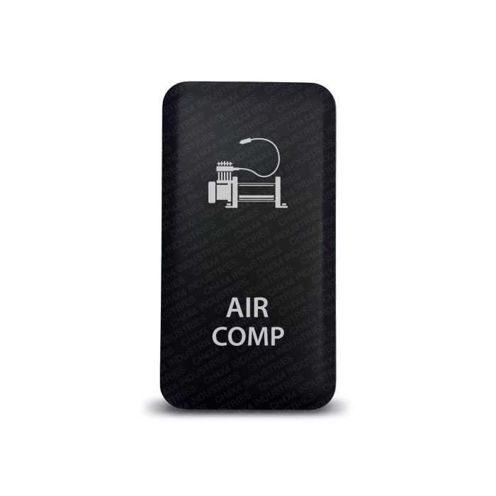

I got mine for my '16 from CH4X4, but you have to get the "Toyota Small Push Switch." They have a lot of cool (useless) graphics available, as well as useful ones.
