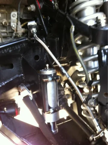

Here's what I've learned about air bumps on the FJC.
Front
1. They should be used in conjunction with aftermarket LCAs, and really only make sense ( to me ) on an LT suspension.
2. Need to custom order a 2" bump shortened to 1.5" stroke, otherwise they'll be hitting all over town, DDing.
3. Major fab is required for typical bump cans. Jounces are the only "bolt on" solution that don't require.
My opinion is, if maintaining the OE width, get TC LCA/UCAs with secondary shock hoop and run a bypass set up as the bump. Less fab, better overall results, since the bypasses allow for overdriving the platform, where bumps don't.
At least, bypasses should be factored in with bumps. At that point, may as well go LT, which cam tab, coil tower, and LCA mount reinforcement, along with a host of other "adds".
This was a pita, unnecessary in my opinion, and it's on mine.
Rear
1. The rear linkage and shock mount configuration will never be capable of keeping up with the front. Period.
2. Have to French bumps into the rear frame rail with OE width rear axle, so major fab. Jounces can be used inside the coils, or at the frame rail with drops on either.
3. Bypasses, bypasses, bypasses, and if not, coil overs.
My opinion is, bypasses set as bump stop make better sense, but still won't be capable of keeping up with the front, without relinking the rear.
The FJC ain't a frog. Axle housings are prone to bending.
Not my rear, but depicts.
Can't find the WTS ad on Mud, but FJNewb is selling SAW coil overs and bypasses set up for max travel on a Camburg +3.5" kit (would work for +2" kit ) and rear coil overs (major fab to fully utilize).
