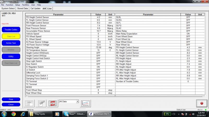

Thanks to Techstream, it appears that the pressures are as follow:
- From low to N: Front: 7.6MPa-g ; Rear: 6.4MPa-g
- From N to Hi: Front: 10.1MPa-g ; Rear: 7.5MPa-g
Based on the values given by Toyota's specs (6.9MPa [+/- 0.5MPa] for the front suspensions and from 5.6 to 6.7MPa for the rear ones), it seems the pressure from low to N position are almost within the limits but, the pressure when the suspension lift up the car from N to hi position seem much higher the limit.
What would you do?
It seems the accumulators are in good condition (difference in oil level is visible between low and hi position, as per Toyota specs).
Would you mind changing the rear springs and tighten the torsion bar?
Please find hereafter 2 printscreens from Techstream:
From Low position to N:
From N to Hi position:
In addition there is a parameter (RL after height adjustment) which keeps displaying 0 mm, would think a sensor needs to be replaced?
Thank you :)

I have tighten both torsion bars (1 full bolt turn on both sides).
Unfortunately it doesn't change much the pressure values (-0.2 MPa at the front, +0.2MPa at the rear) :(
Now the pressures are:
- Front: 7.4 MPa (Toyota specs: 6.4 - 7.4MPa)
- Rear: 6.6 MPa (Toyota specs: 5.6 - 6.7MPa)
The pressures are right on the upper limit.
Is there a way to reach the lower Toyota limit?
