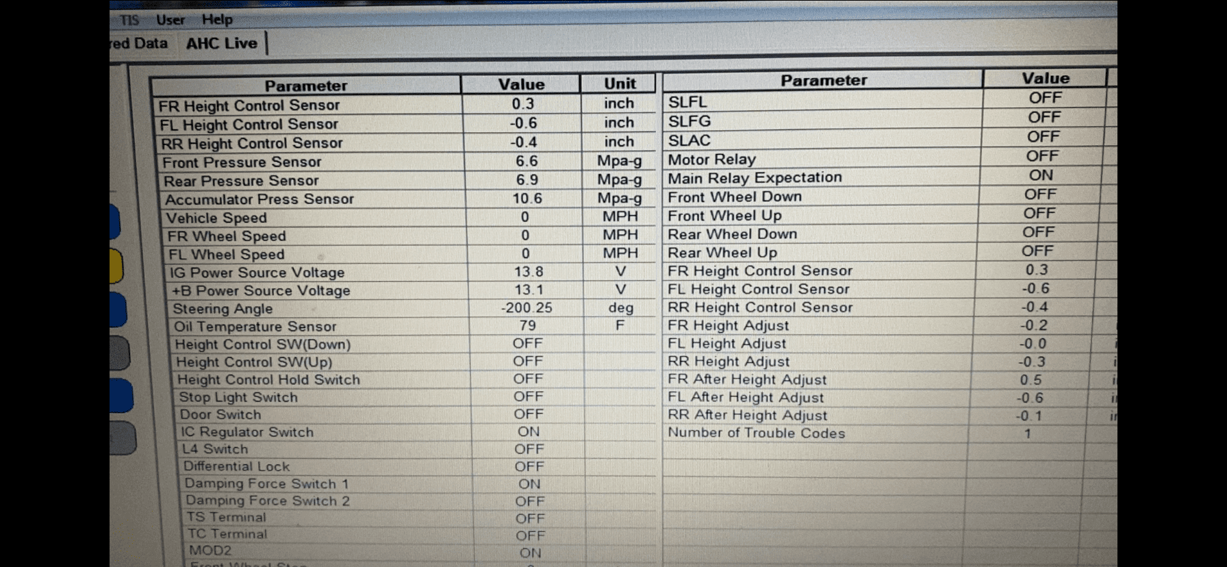

Have you done any of the AHC tests or maintenance? How many gradations do you have? Pressures? Sure you're not amputating an arm over a sprained finger?
I have done 3 flushes in the last 3 years since I owned it. The first flush 3 years ago came out like a black emulsion... did a second follow up flush and fluid was like a pink milkshake. Third flush six months ago and fluid was again dark, foamy, but no milkshake.
The last I checked the graduation, they were at about 7.5 iirc. I remember that it was on the high side, but still ok?
I measured the pressure a couple weeks ago and they were at 6.6 FR and 6.9 RR after a L to N raise. Seems to be inline? I did crank my torsion bar a bit to lower the front pressure. I think it was at 7 before.
The only symptoms I have is jarring ride, C1751 code and leaky rear strut.
