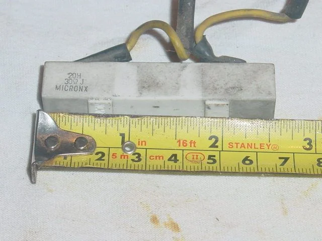

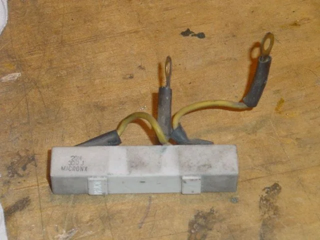

This is a pic of the OEM dropper / resistor 83145-60010.
EDIT: I just Googled for "MICRON" and found out that:
20 stands for: 20 Watt
H stands for: Lug Terminal
30Ω stands for resistance value
J stands for: +/- 5% tolerance
You can find it here http://www.audiolabga.com/pdf/FR.1.pdf on page 5
Rudi
resistor
