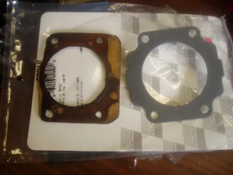

Throttle body gasket: Toyota doesn't make them so I had made one and put it in. I figured I'd left too much material so today I replaced the homemade gasket (left) with an aftermarket (right).

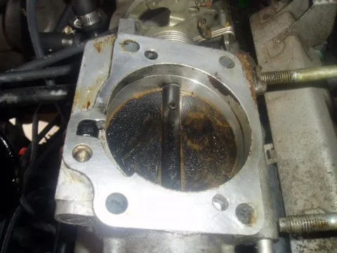

When I did this, I was amazed at how dirty the throttle body was! Seems like oil is getting into my intake badly. I just installed a new PCV valve.
Cleaned it up with new gasket. Put it together, changed the oil (ready to run).

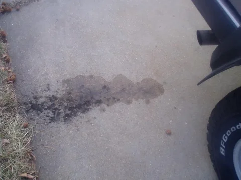

Again, it's running good except the high idle and black stuff coming out my tail pipe. I had to of screwed something up when I did the engine work in summer of 2011. Here's a pic of the ground next to tail pipe.
What do you think?
