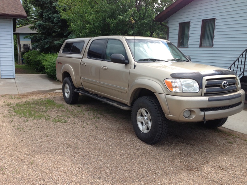

I just went from the Toyo MT to the M-55 on our tundra. I looked at the duratracs, cooper etc before my purchase. I stuck with the Toyos. I really wanted to like the MT (love them on my Cruiser) but the 255/85R16 just didn't meet my expectations.
The 255/85R16 MTs wore horribly and growled/howled more then my 37x13.5 toyo MTs. They performed terrible in the snow, even siped. 40% tread at 30k km. BOO.
The 255/85R16 M-55s are MUCH quieter but do have a noticeable whine to them. In the rain they are the best tire I have ever had on a truck. Haven't had them in the snow yet. I am currently running them at 42psi and love the ride.
M-55s are VERY popular with the logging industry out here on the west coast, a good long life, year round tire that will take daily logging road abuse, and also get you home or to town on the highway with reasonable comfort.
@ The Dude - Have to admit seeing your Tundra it is striking to see those pizza cutters when everything else today is 11"+.
