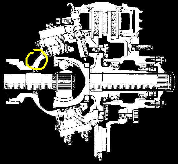

I wasn't suggesting earlier to tap thru the upper trunion. What I said was to go thru the knuckle behind the upper trunion--circled here in yellow. I think that's much easier than drilling out the axle.
right on, exactly where I meant too! The hole would have to be tiny to avoid strength issues though.
Of course, the greasing would not alleviate the issue of the axle seal going bad etc... so it may not really help that much to reduce birf jobs frequency?
E
I don't think the real problem is getting grease into the birf cavity, whether it's behind the birf or infront of it. In both cases the grease is not IN the birf. Grease stuck to the outer birf and spinning with the axle does no good. Grease piled up in there does no good. The only grease that means anything is the grease actually inside the birfield where the balls are. The only use for the extra grease in the cavity I see is so the grease inside the birf is less likely to squirt out, since the whole thing is kinda running in grease.
Drilling through the axle would be cool. You could even take off the wipers, and run solvent through that hole while turning the birf, it'd wash it out nicely, then start pumping the grease in. Still there is a problem of not being able to really pressurize the grease into where you want it, which by hand you can do.

OK, either you have good grease in there or not. If it is good, then the greasing is a moot point. If you don't then the seal is busted and need replacing. Also if you are considering Bobby's birfield, it means you are wheeling. If you break more birfields on the trail, then you can just do the service there :D
We can swap a birfield in 45 minutes on the trail. So if your only issue is to get more grease in there and you are not servicing the axle, then open it up, put grease in and close it up. It would have the net effect of pumping grease in via a hole. Except that you can make sure you are nut pumping a lot of grease into the axle housing.

PS, cool diagram. Wanted to do a real world section of a front axle when time permits.
