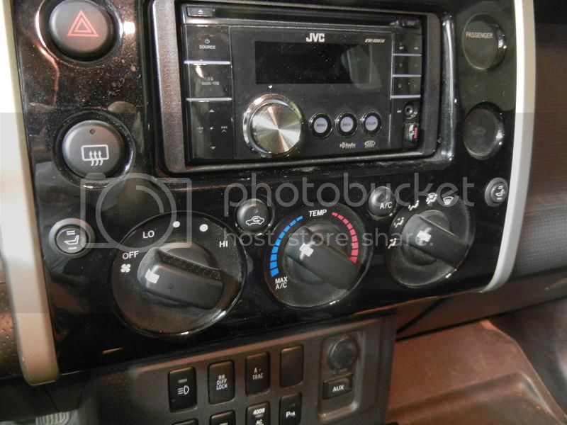

Yes, it's wonderful! I put the switches in the center console as shown in the picture below. This is the kit I used:
