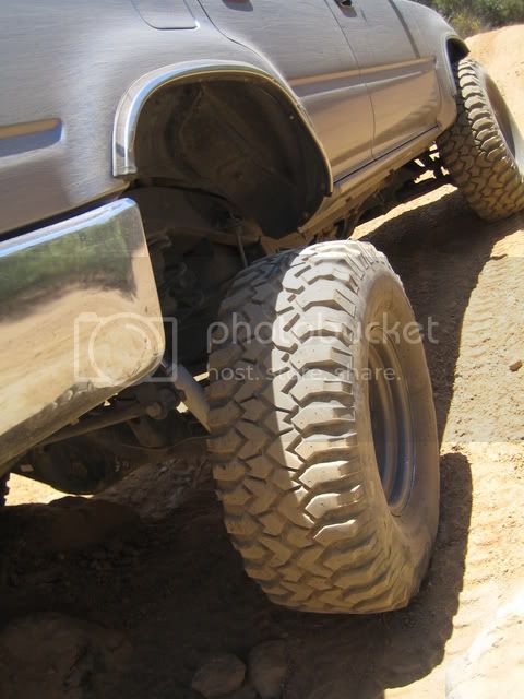

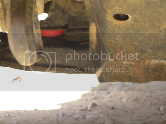

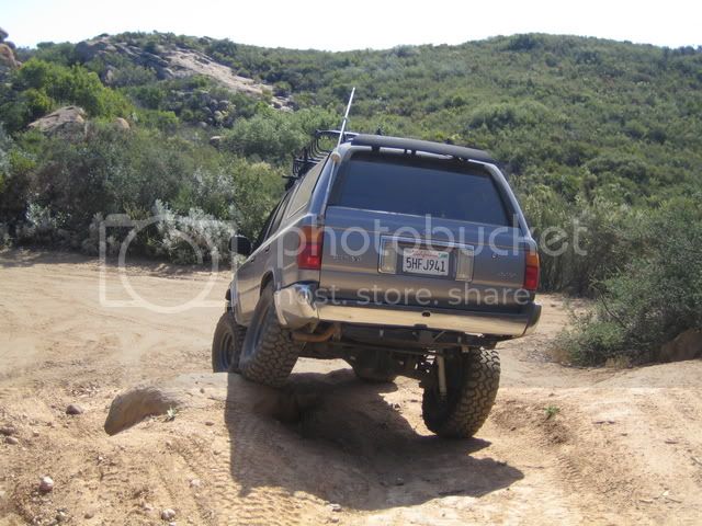

I am running this setup and have been very happy with it, especially that I haven't spent a ton of money on it. I have used it for just about everything, hard rock trails, high Death Valley, and even Pismo Dunes. The dunes was probably the only place that the aftermarket tbars may have helped.
This shows compression with stock tbars
still could compress another 1/2" if needed
cruiser coil flex
