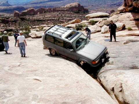

Just don't do this line. However the truck was no locked and did not get to scraped up.
sleeoffroad said:
John, got me there. But, I have some of those tracks, but they for sand only. I do have some exhaust jacks I can bring and we can inflate them and put them in the crack.
See...See...that makes me salivate for my 80. Cut frames, the thing can ROCK. It's awesome!
