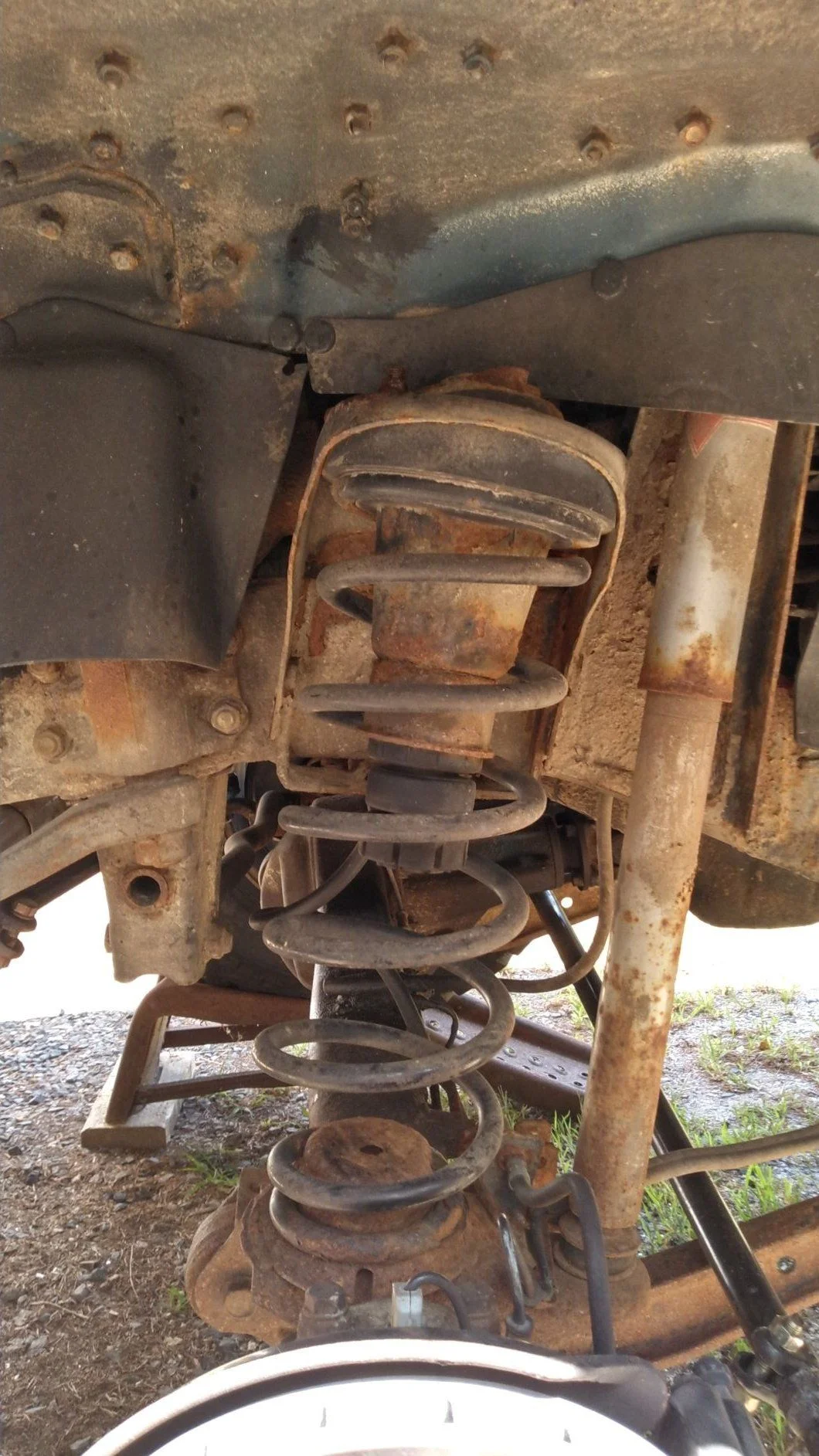

Yep, she's rusty. That's why the plow, but anyway...
So removing the bump stop leaves a rough surface at the top of the spring hanger-

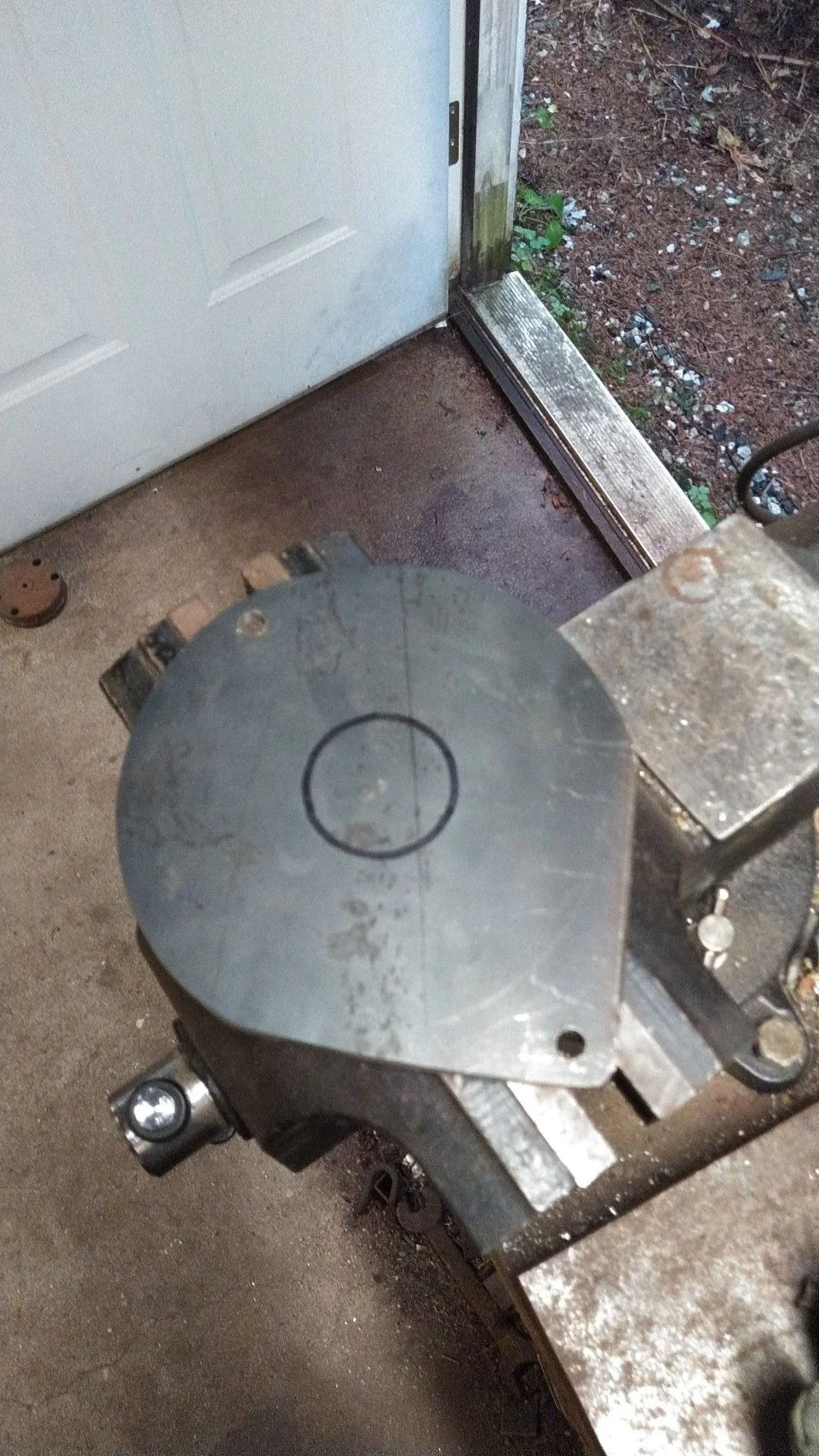

Not good for air bags. So I started to make some plates to give me a smooth surface for the top of the air bag.

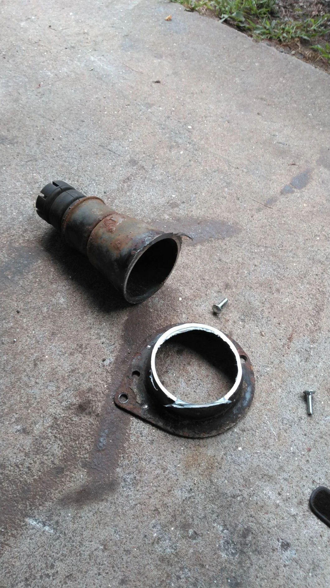

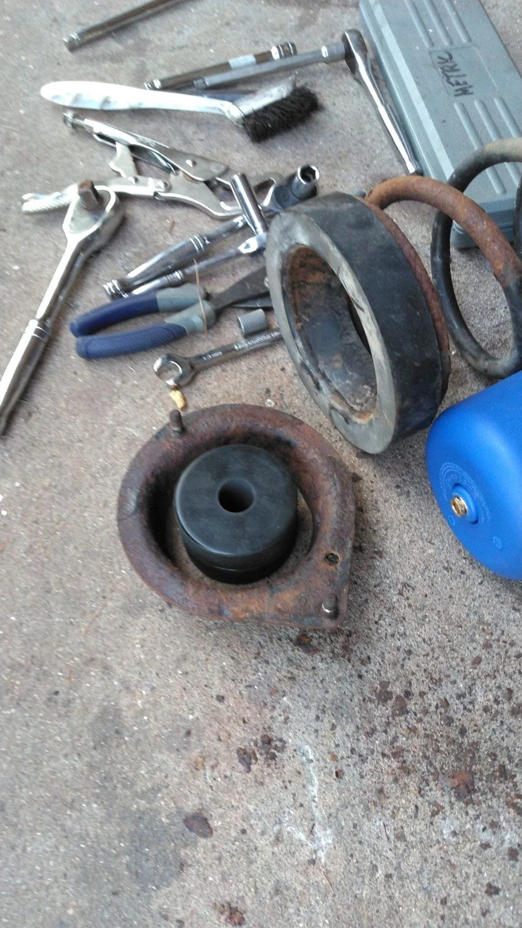

Unfortunately I quickly realized that I couldn't use them because without the bump stop to locate the spring spacer, there was nothing really holding the top of the spring in the pocket. Curses and other such comments ensued. Finally after much pondering I figured that if I cut down the bump stop and filled in the hollow center space somehow, the spring would still be retained and the bag shouldn't get abraded. So that led to this-

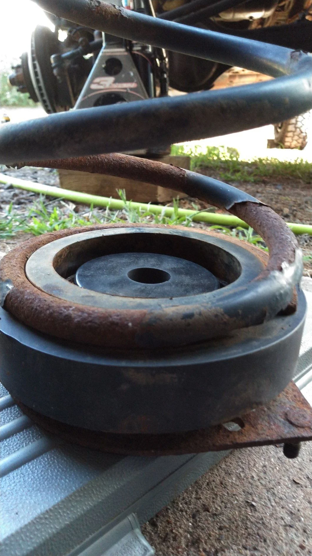

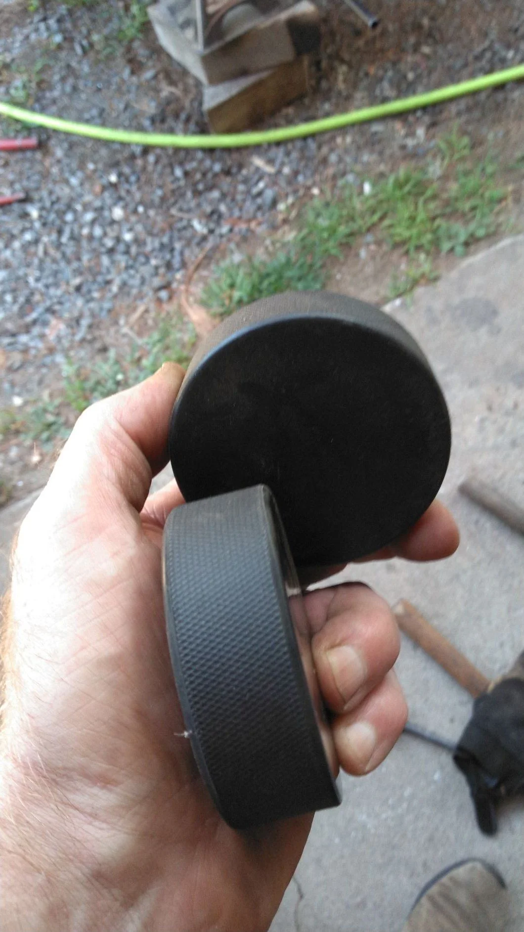

With the stop cut down to size than all that was left was filling in the hollow space. I guess I could have welded plates onto the stops and went that route, but I was worried about pinching the bag between the plate and the spring, and I already had figured out a workaround. Hockey Pucks. ( Insert Don Rickles comment here for us older folks.)
These pucks got a 3/4 inch hole drilled through the middle and a pair of pucks stacked worked out just about perfectly. The bags only take the additional weight of the plow seasonally and the pucks being solid hard rubber are weatherproof and won't deform, especially when it's cold..

The puck stack looked like this-
Just about perfect. That led to this-

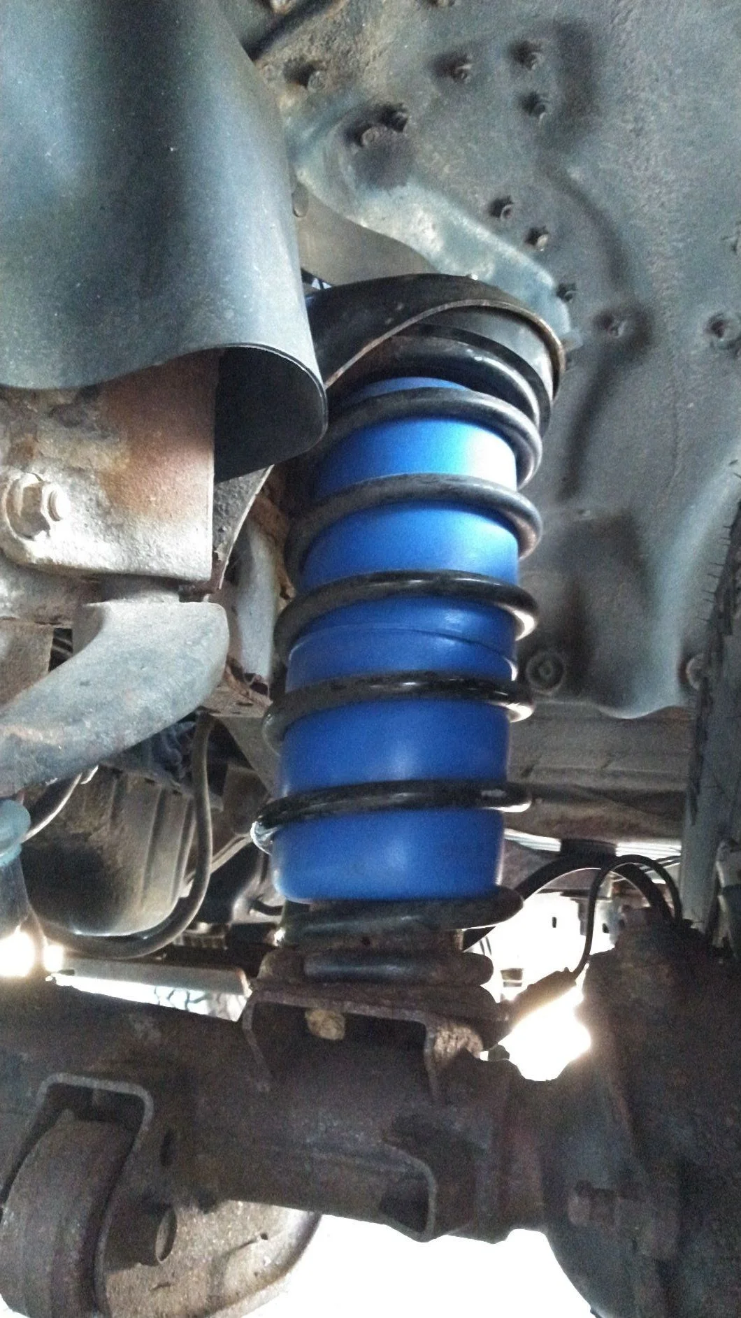

And eventually to this-
They've been in for a few weeks now and seem to be running smoothly. 10 psi has raised the front about an inch but 750 pounds of an 8 foot Fisher snowplow and headgear will surely change that quite a bit. Not sure how much air I'll end up running or exactly just what I'm going to do for bump stops at the moment, but the project progresses regardless. I'll put up the plow frame fabrication in another thread.
