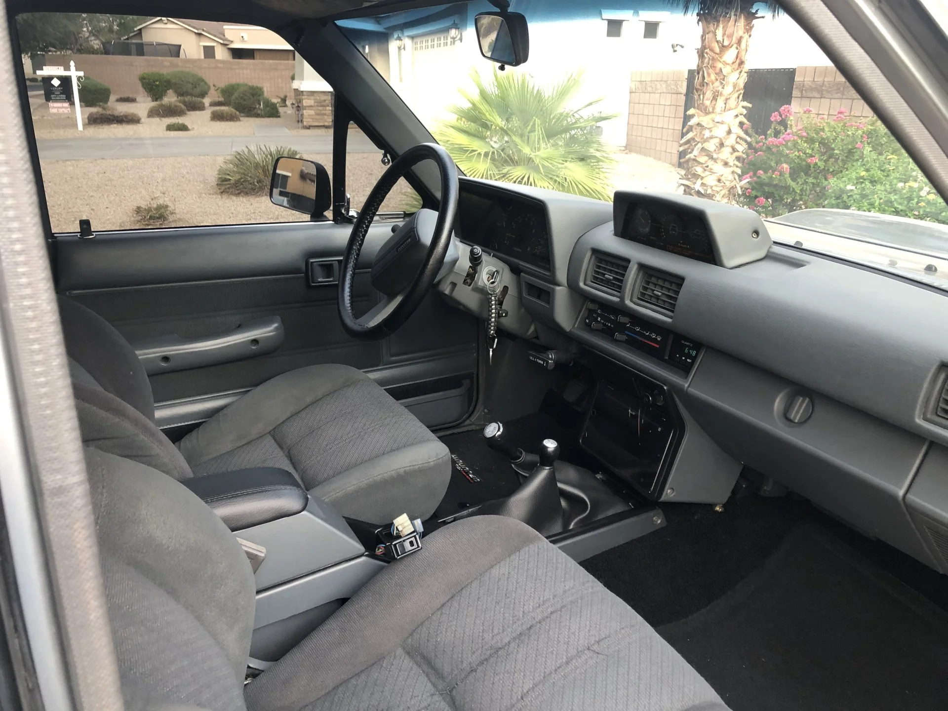

Want to fix sun-cracked dash with accu-form dash sap (https://www.ebay.com/itm/311514544877). Accu-form lists a bunch of different colors under their product page (DASHBOARD COVER - http://accuforminc.com/dashboard-cover-103) at least 5 of them are shades of gray. I was wondering if anyone ever gotten a gray dash from them or just get a black one and paint it with
Dupli-Color Charcoal Gray Vinyl & Fabric Spray Paint
pic for reference
Likely any color you try will be a little off. Why not just take it all apart and paint it all to match? It's really not that hard and it gives you excuse to replace the bulbs in the HVAC control panel (or even get a new panel front from Toyota, yes they are still available), clean everything, etc.
I have used SEM color coat paint 15163 Presidio it's a very close match to the Toyota grey. If you do paint, clean everything with a scrub brush to remove the paint in the texture, and use a good adhesion promoter on the plastic prior to painting. I don't have any pics as the truck is all in pieces and the Accu-form dash pad I ordered is still in the box.
