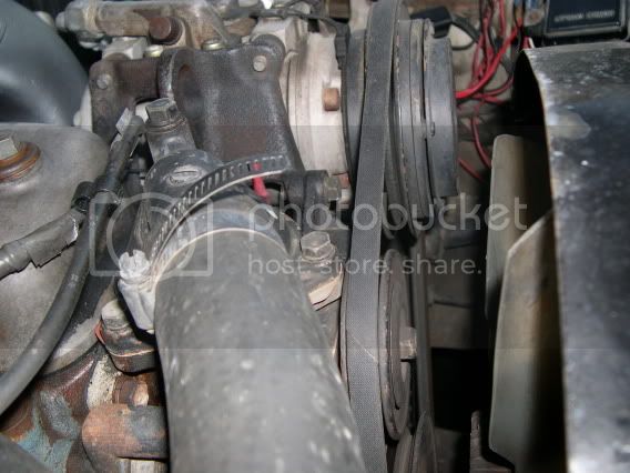

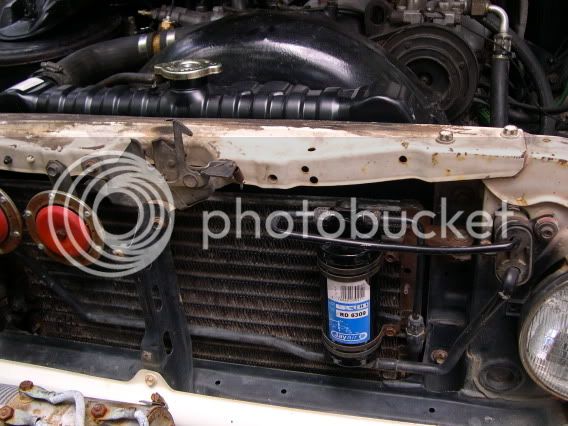

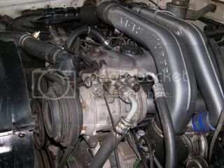

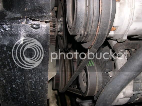

Here's a couple of pics so you can see.
compressor on a 2H.
