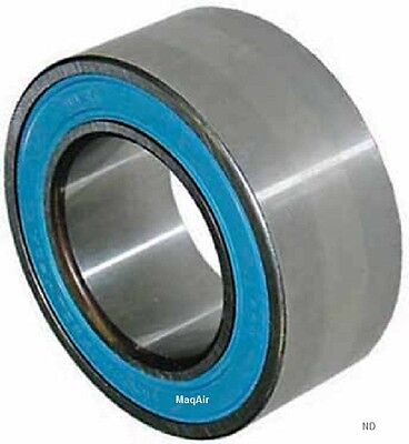

For what it's worth, i bought the NSK bearing from amazon:
Amazon product ASIN B007WEOFVM . It fit and I don't have any reason to believe it is counterfeit, but use your own judgement
This one was ebay and worked well.
Shipped from St Louis
