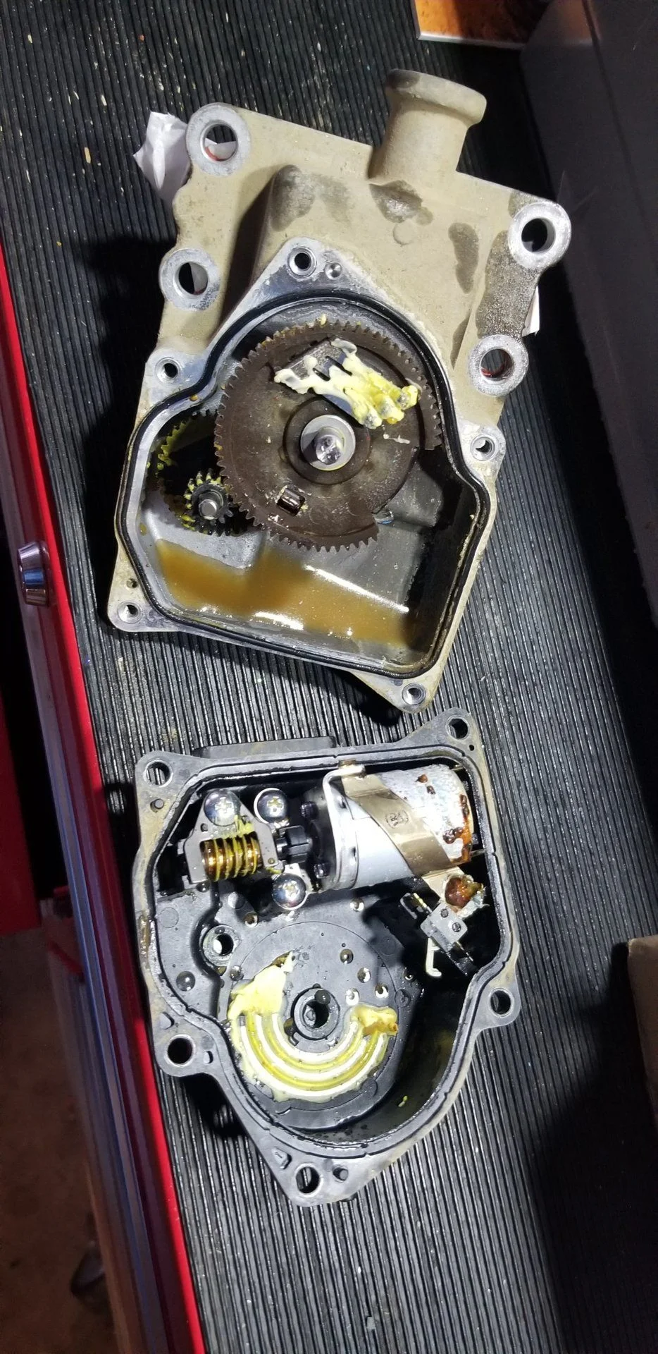

Mike just so you don't feel bad I had to replace my Front Diff Actuator, its amazing what just a little water from the Mojave River will do in the wrong place! I was lucky enough to get two more runs out of it before it completely failed. Back in business now!
Mmmmm - I've grown fond of Afton tea! Glad you got it fixed.
