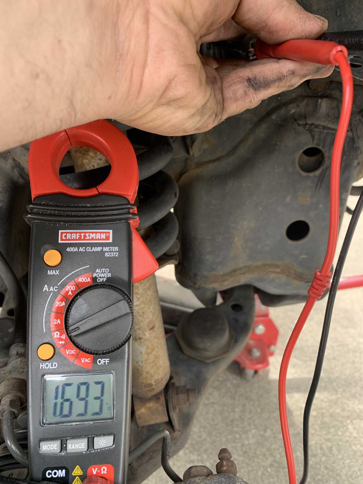

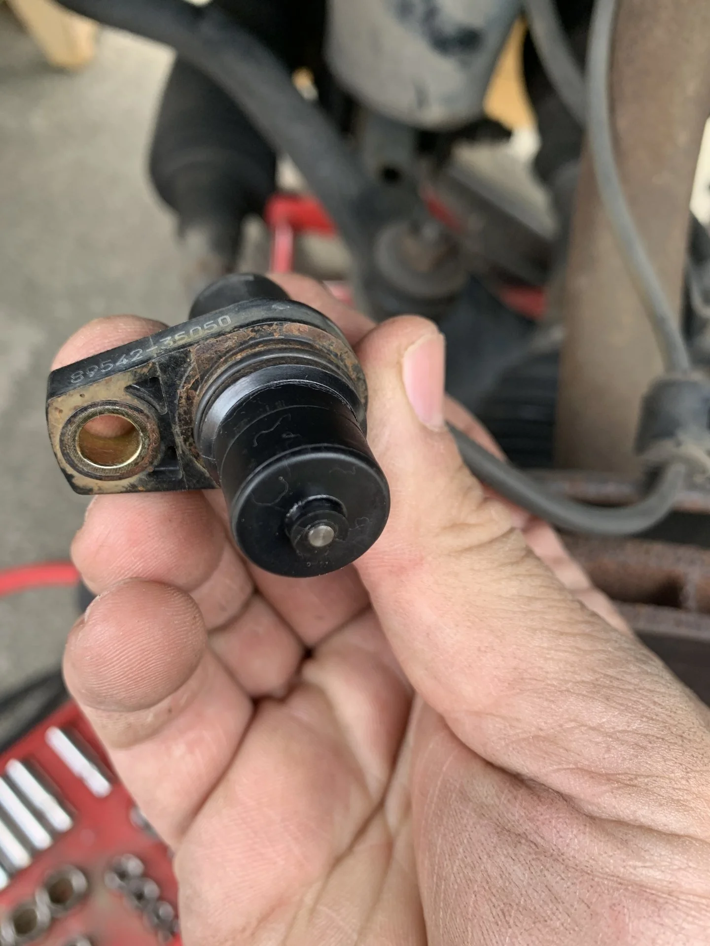

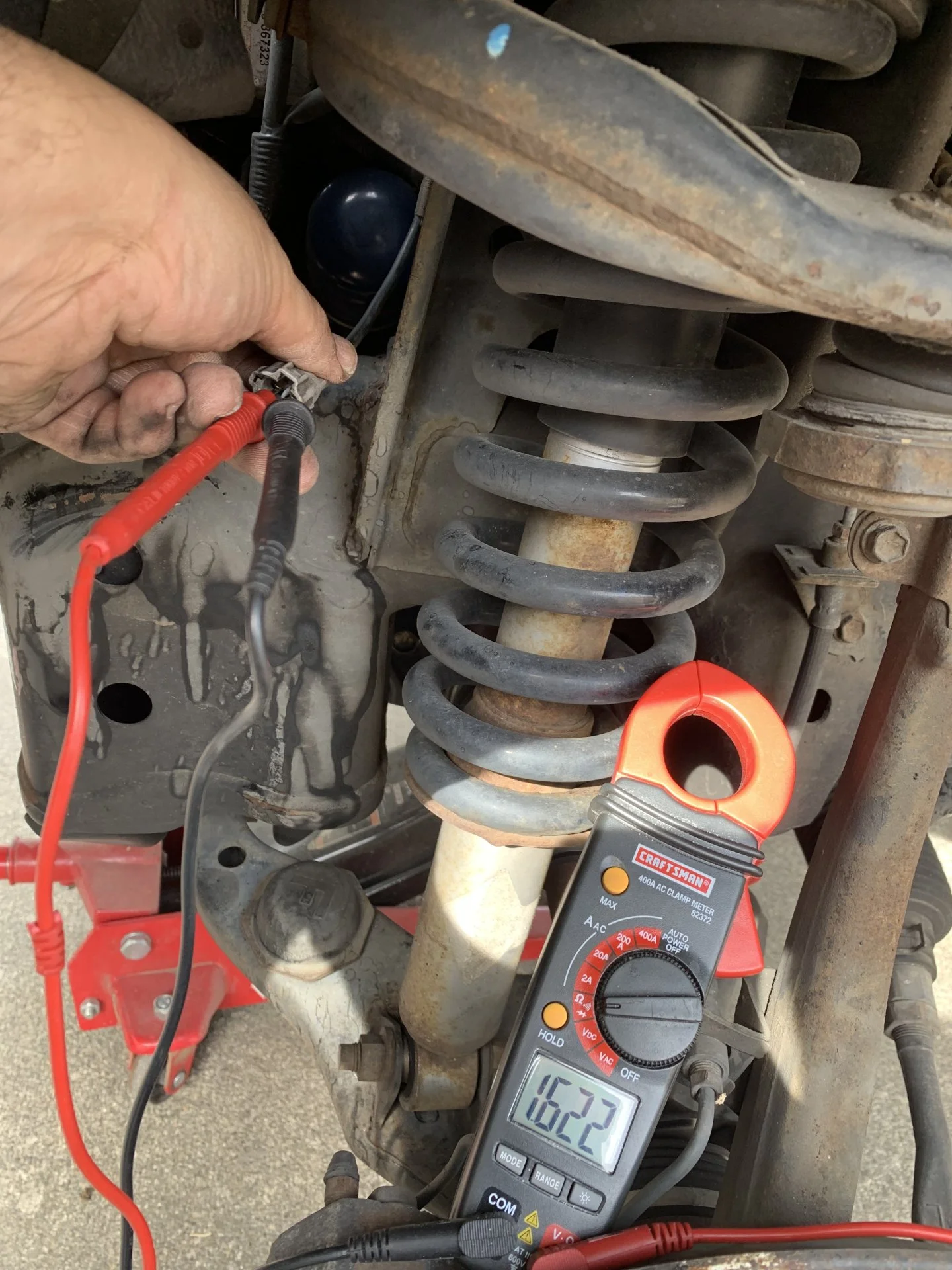

Well, I’m rolling around under this thing trying. I came across a post about testing with a multimeter the ohms at the connector. Post said front should read over 1500 which I removed them they look good and they do In fact read over that. I’m assuming they are good. Just tested the back which read around 1330 and other at 1325. In the thread someone said theirs were good reading around 1200. Again, assuming my rears are good. Moving on. Getting ready to look at the brake switch next. Not sure if what I’m doing is even relevant but hey, why not.

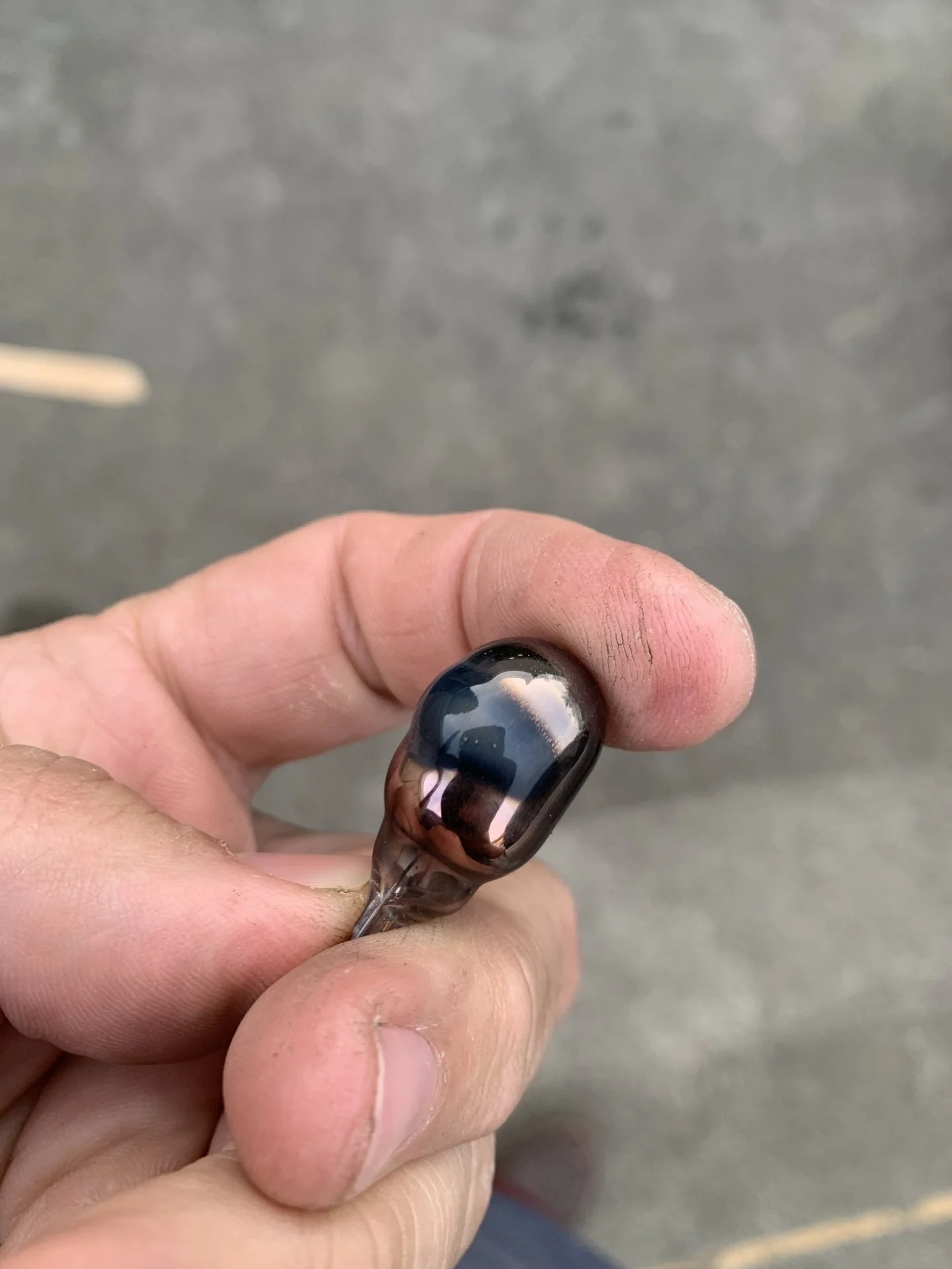

Well, I did as much as I could. I found a new brake light switch. I’m not the most savvy one with a multimeter but I try. I decided to buy a brake light switch to compare with the one coming out. They seem to be testing (ohms) about the exact same. I’m confident my switch is good but i put the new one in. ABS light was off for a bit but did come back on. I moved toward battery, alternator, voltage. Tested the battery which is good(brand new) and checked voltage when running which seemed to be good. Wasn’t sure where to go after that. Wrapped up for the day and have just been reading every post I can find. Finally found one mentioning LED lights in the 3rd brake light causing issues. Earlier I checked to make sure my brake lights were working. I didn’t even look at the 3rd light. Sure enough it’s out. I removed the bulb which was an old original bulb. It’s toast. Hoping this is the problem. Dummy me. Of coarse the only thing I have that fits is an LED. I plugged it in and went to auto zone. Got me a replacement bulb. ABS light came on on the way home. Just finished replacing with the stock one. Took off Neg battery cable while I did that. Got it all back together. No light but I’ll drive it tomorrow. Hope for the best.
Well, everything seems ok now. Got an regular bulb in my third brake light. No AbS light all day. Lessons learned on this one. Only broke two connectors and lost only one screw. Lol. Today I replace an O2 sensor. Upstream came out, down stream has stripped nuts. Not sure what to do yet. It’s ready for work in the a.m. and that’s all that matters.
