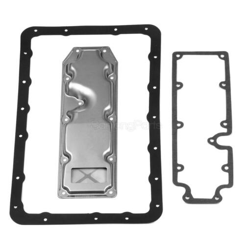

1. A gasket/solenoid kit that fits your version of the A343F. (Be careful as there are some differences). I bought these from eBay and Amazon based on visual matching and they were the right ones
HERCOO A340 AW4 Transmission TCC... Amazon product ASIN B07F2HM4W4

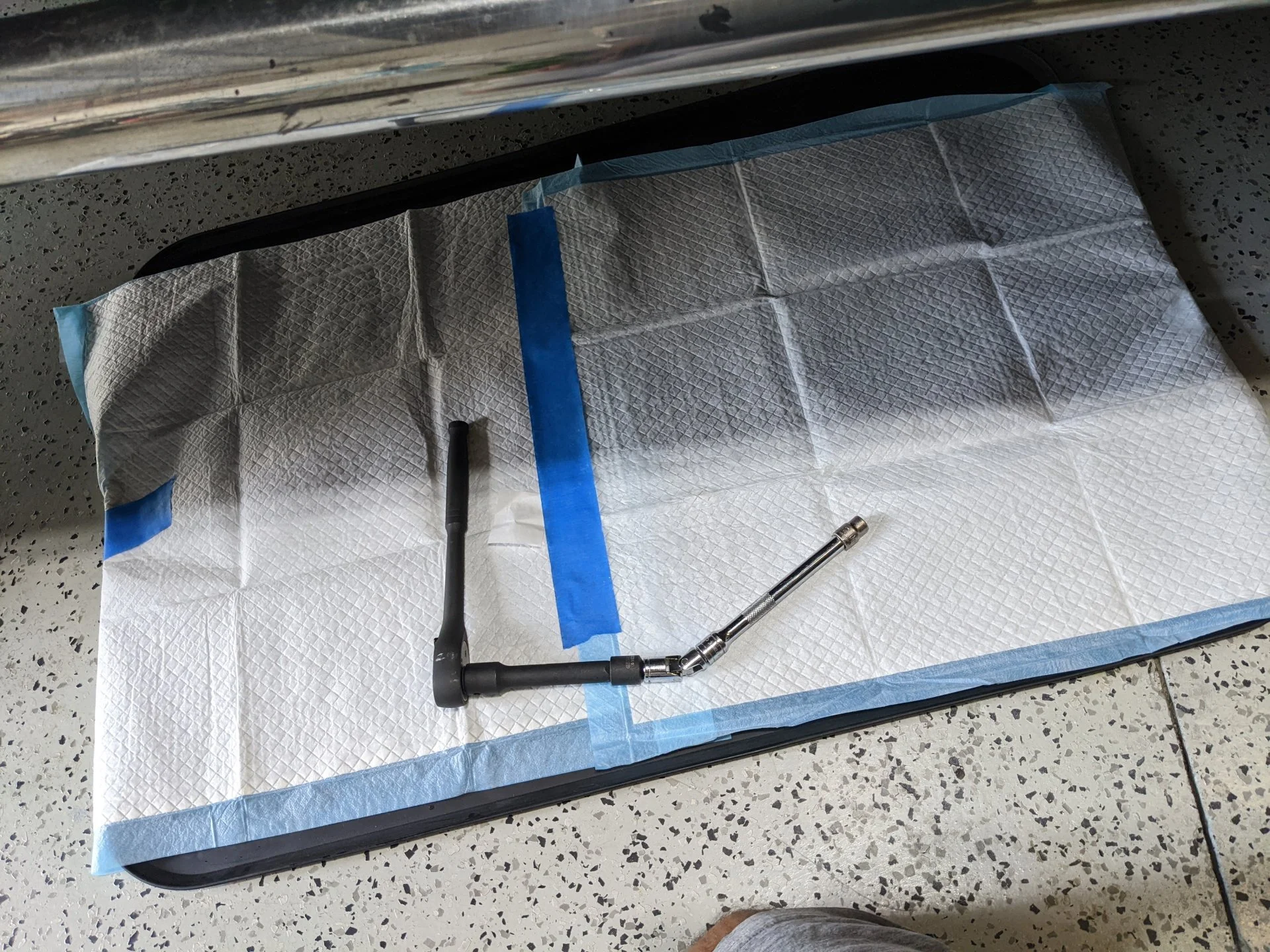

2. Puppy training pads. These worth their weight in silver!

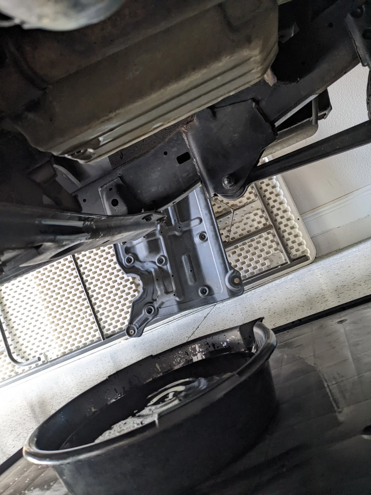

Now, check your ATF level cold. Should be within the lower two markings on the stick. Go ahead and setup shop on level ground, disconnect both negative battery terminals and remove the bashing plate under your transmission using the 12mm socket.

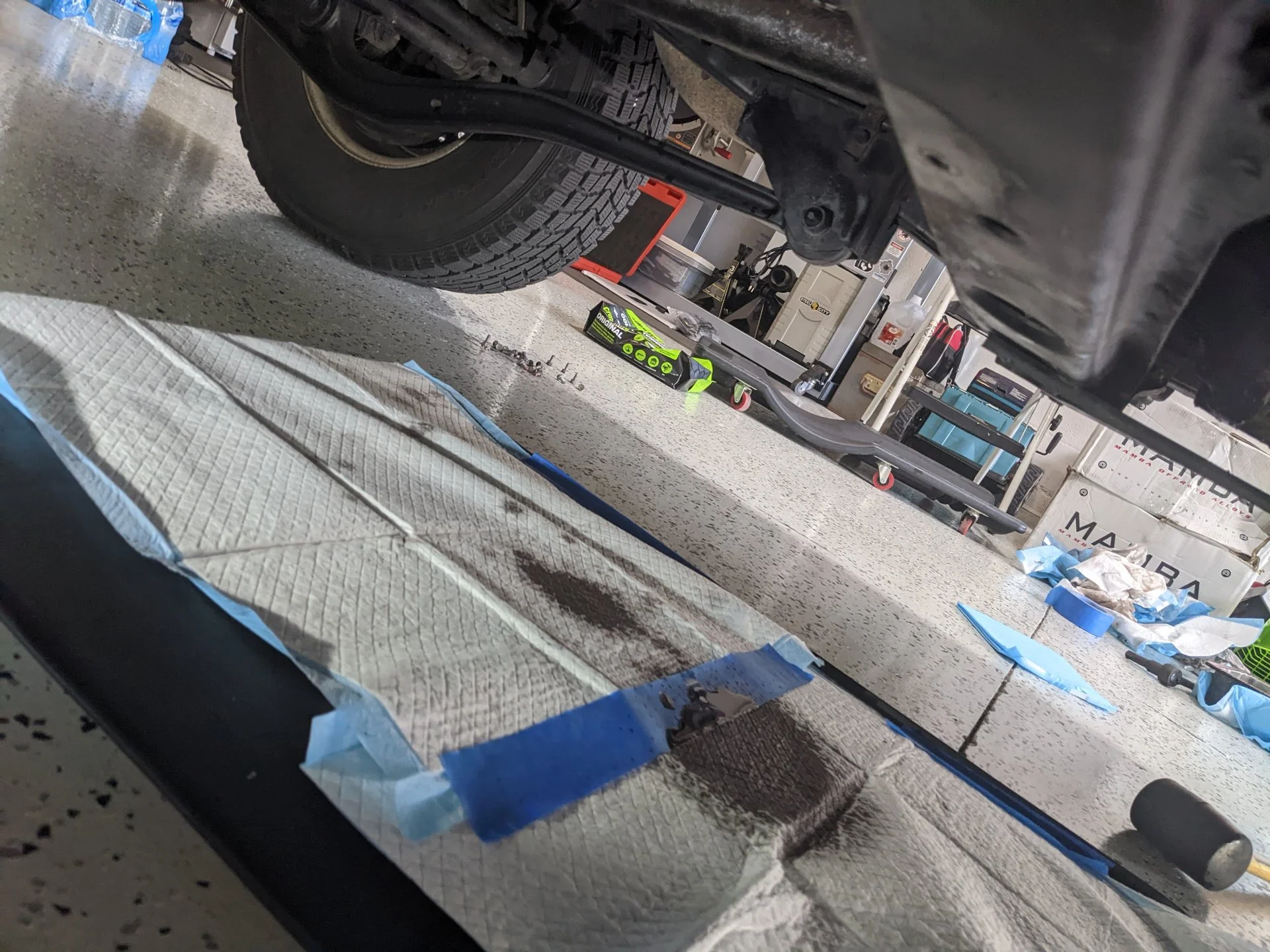

Place your oil changing tray lined with puppy pads, and situate the oil changing pan on top of the pads under the drain plug on your AT.
First (important) remove the AT dipstick as it will interfere with your efforts to drop the pan later. Using the 14mm socket, drain your ATF into the pan. Allow for extended drip time. When you feel like you've got most of what you can get out (4-5 qts), go ahead and replug the drain using a new drain washer, obviously.
Now, using the 10mm socket, remove the thousands of screws holding the pan in. Start with the harder to reach ones closer to the cross member to guage what combo of extensions would work for you early on. This is actually easy I'm just trying to be funny. When done, run your razor blade between the pan and the AT housing to cut through some of the old FIPG material (usually red or black ATV). Give the pan some gentle yet firm whacks with the mallet. And rock the pan to dislodge it from the AT, it takes some patience and more razor time but not too bad. Don't worry too much about the pan falling as it's light in weight and still sort of held up by the dipstick tubing (the dipstick tubing is made out of two pieces with an o ring in between).
The pan will come loose and this is when you book your oil spill therapy session for Monday. There will be some ATF dripping from the body of the AT, the filter, etc. Embrace the oil and use some shop towels to manage it. There are many liters of ATF hiding above but you shouldn't worry about that.
These puppy pads man! Even better than kitty litter 😆

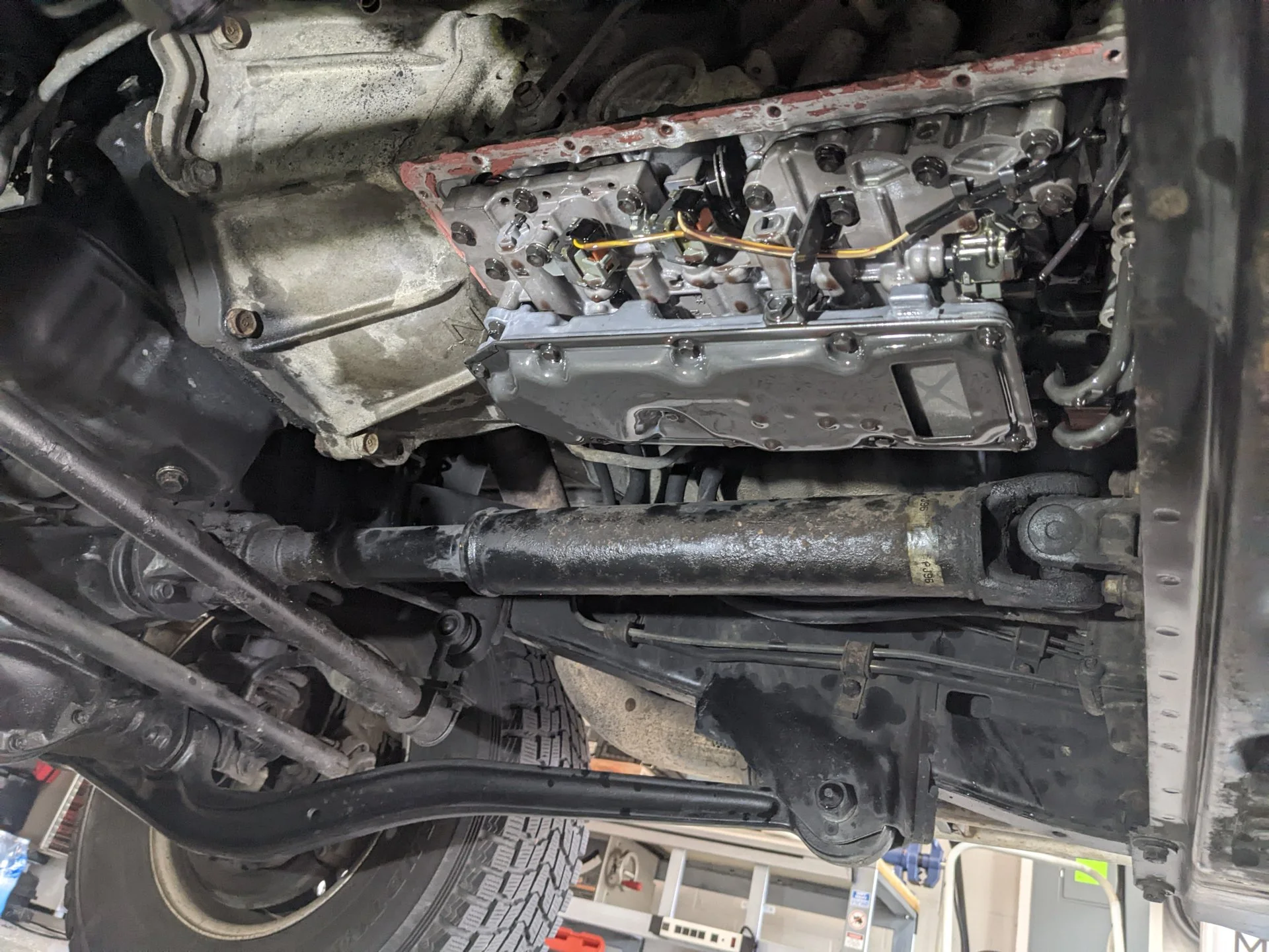

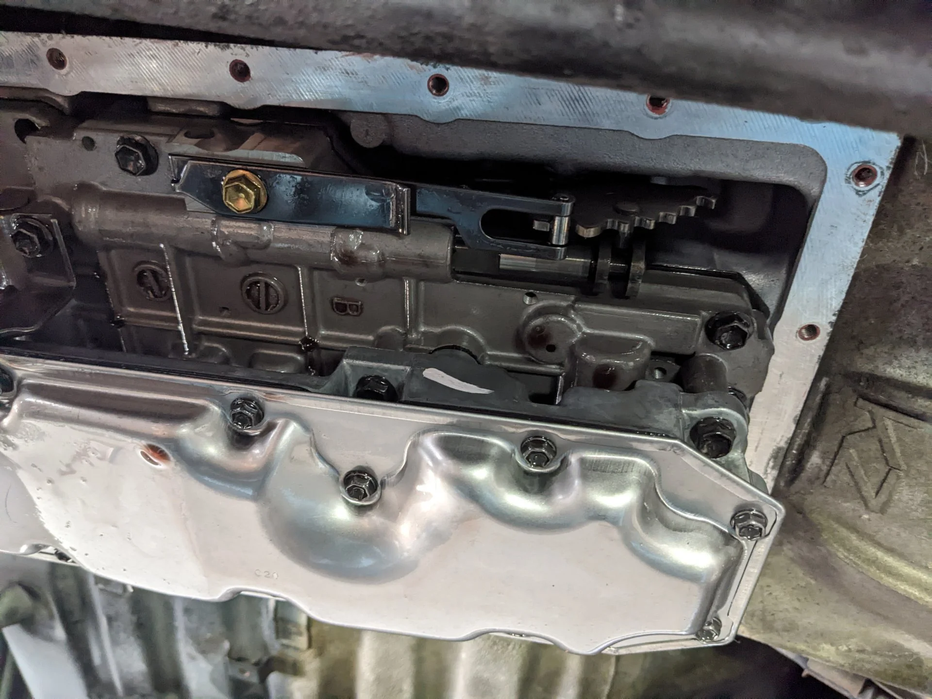

Using the 8mm socket, remove the filter screws and it will drop. and locate the three solenoids on the RHD passenger side of the transmission. You can't miss them. Each solenoid is held in place with one 10mm bolt. The solenoids are pressed (very loosely into their respective housing and are each connected with an small electrical connector. The two shift solenoids (1 and 2) are identical and interchangeable, the lock solenoid is a little different in shape so no drama in how to identify what goes where. (Remember, when you remove the filter and solenoids, some more ATF will come out, nothing much just annoying).
Fit in your new solenoids and clip their connectors on securely, and fit in your new clean ATF filter and its gasket (more of a strainer than filter).

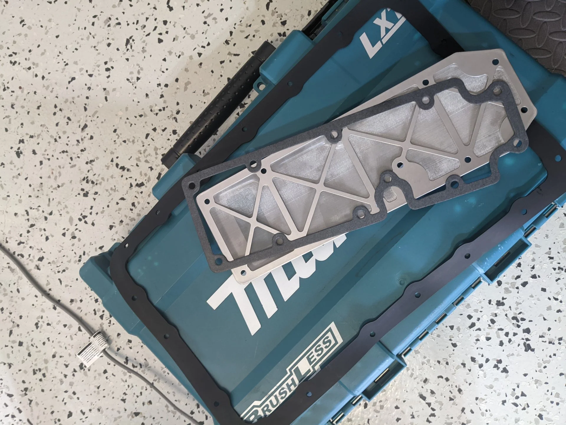

The new filter, filter gasket, and pan gasket (rubber).

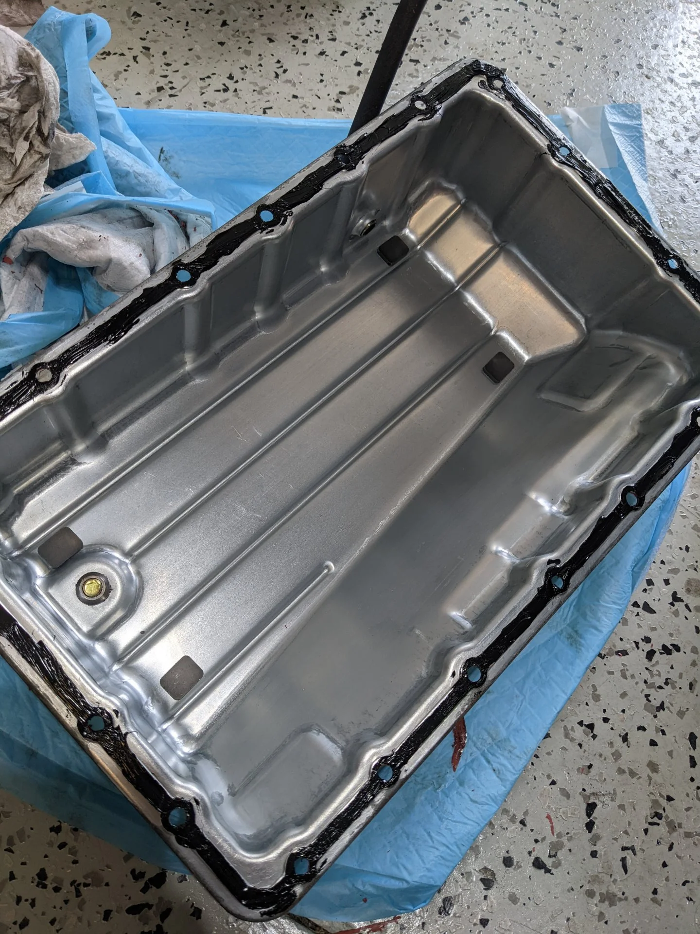

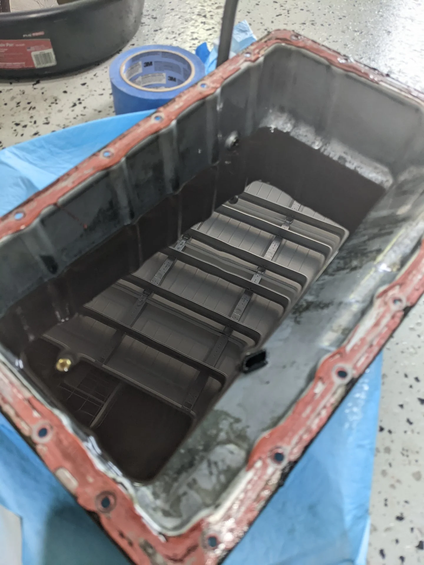

The least fun part starts now, start cleaning and prepping the AT pan by removing the old FIPG using patience and the razor blade. Take your time! Do a good job and leave nothing without damaging the mating surface of the pan. You can use the soft brass bush for some of the stubborn bits. When it's all clean and shiny, go ahead and clean the inside of the pan. Take note of the ATF residue there, the color, smell, and consistently. Mine had some sludge there but no identifiable metal shavings. There are four magents in that pan, clean them well and inspect what's stuck on them.
Tip: (when you put the magnets back, make sure the chamfered face is down towards the pan for better engagement with the pan surface as the other face of the magnet is slightly sharp and raised around the edge, which could cause the magnets to shift if it was facing the pan).
Here's the pan before and after:

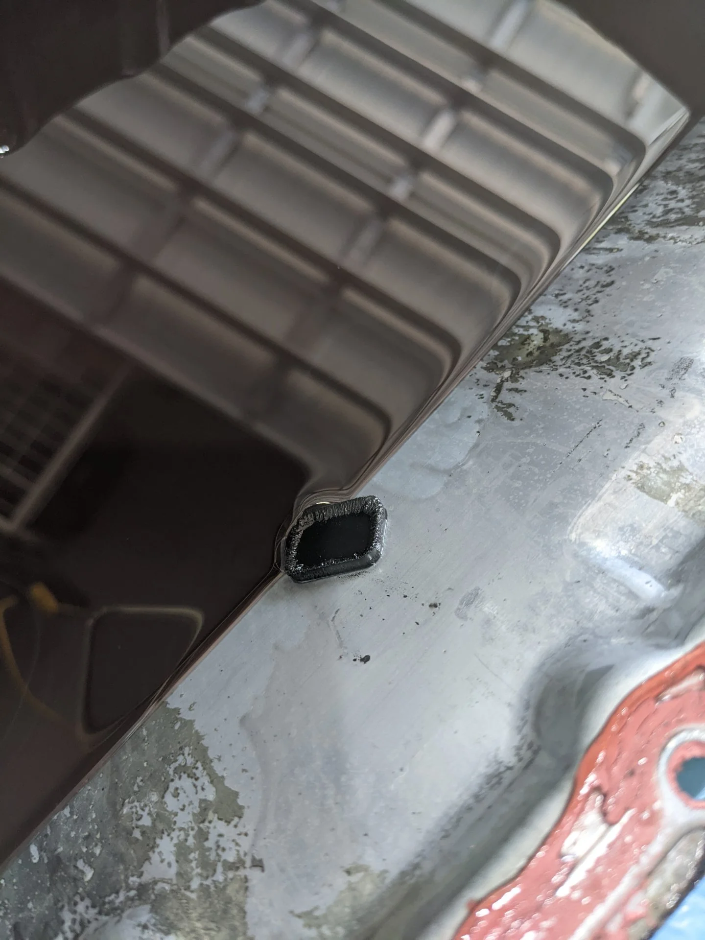

This is a close up of one of the four magents, being the one installed facing the wrong way (sometime in Japan I'd assume). You can see how it became dislodged and managed to creep up to this point. Yikes! If you're like me in not liking sticky metal object floating near the business parts of your transmission, then make sure to place them down the right way!

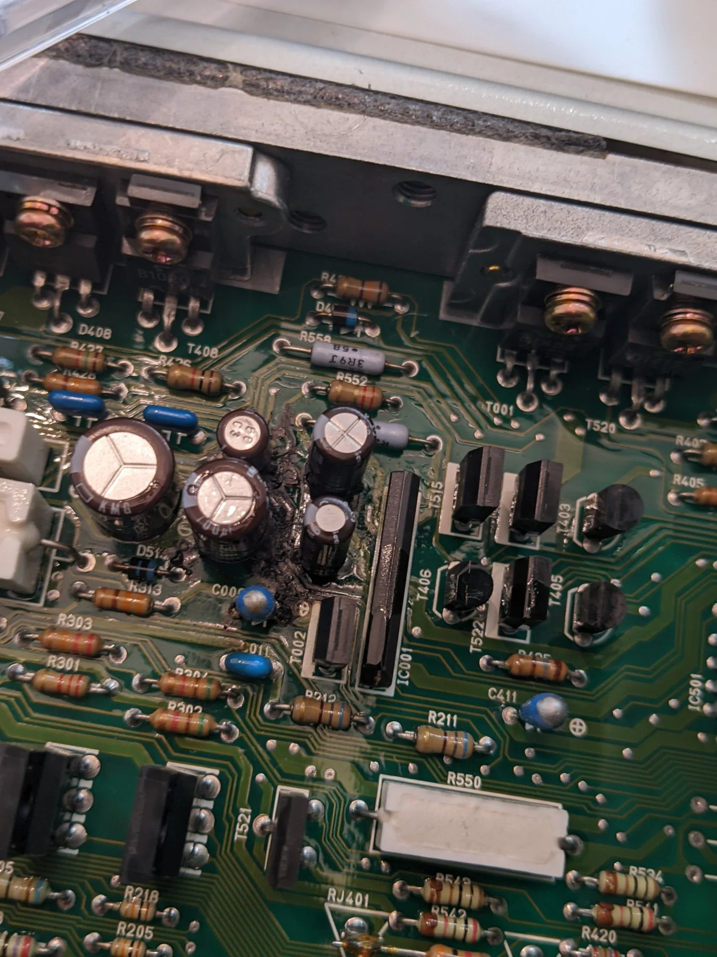

Sneak peek:

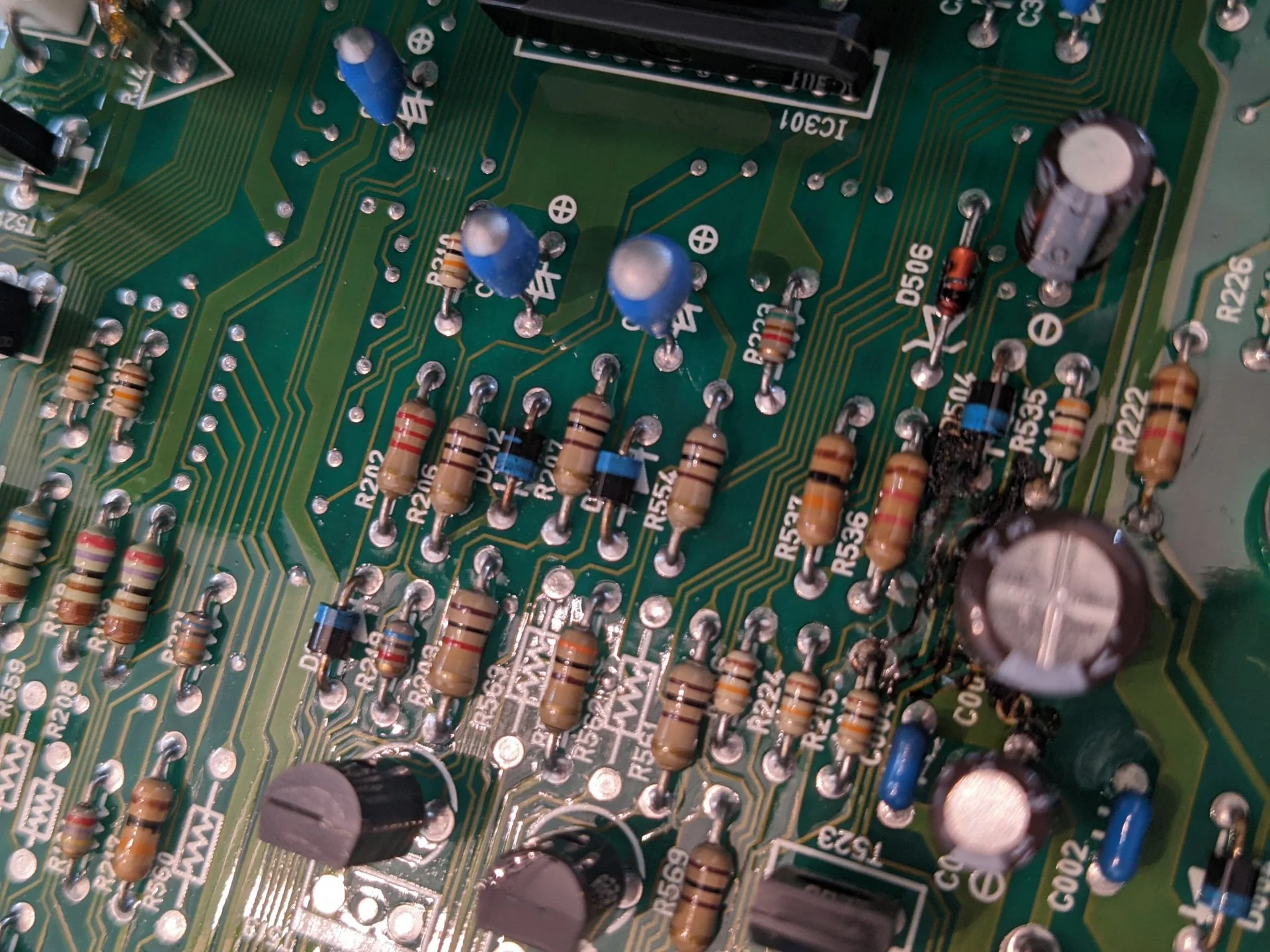

I couldn't resist the temptation to dig out my ECU for a quick surgery. Sure enough, the great plague of 90s capacitor is in full effect. But I knew that was the case before I even opened it 😆
All but one electrolytic were physically leaky (I am certain that remaining one is "electrically" leaky and/or has an impedance that rivels a ceramic resister by now. Many of the physically compromised ones had spewed up their guts all over the PCB. I have yet to properly assess the electrolytic-caused trace corrosion but I think the traces are within the restorable range.
