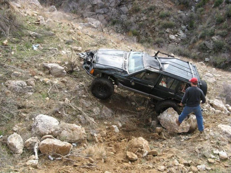

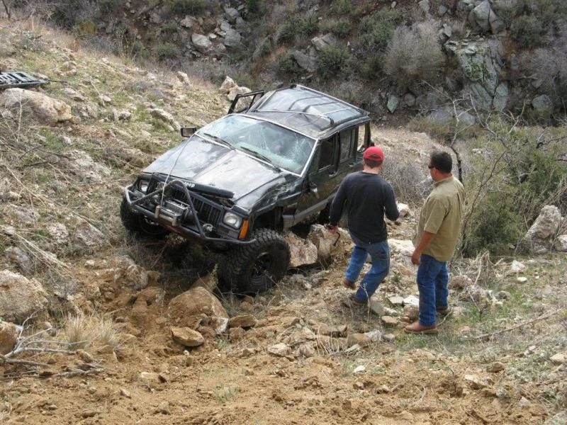

Here are some pictures of a friend's misadventures on the backway to Crown King. I wasn't with them, but received a phone call asking for a tow.

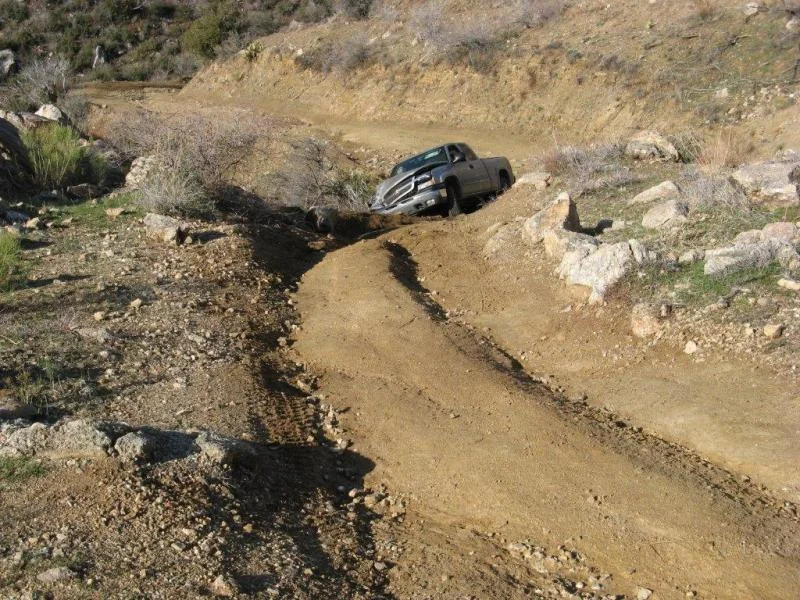

Friend 1 was trying to winch Friend 2 up the hill that you see the Silverado (Friend 2) sitting at the bottom of. Friend 1 had his vehicle in park, with the parking brake on and the tires chocked with rocks, but did not have his truck anchored to anything nor did he have his foot on the brake pedal. The parking pawl snapped and Friend 1's Jeep proceeded down the hill. Friend 1 had to jump out of the way.

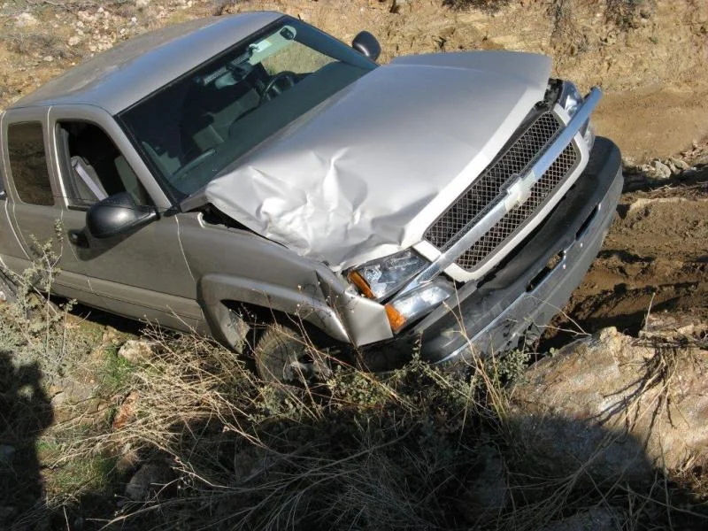

The huge dent in Friend 2's hood is from Friend 1's passenger side front tire rolling over the top of it.
Friend 1's Cherokee then went end over end down the hill you sitting it at the bottom of. It rolled at least twice lengthwise. Interestingly he was able to drive back up to the trail from its resting spot.
The Silverado has several thousand dollars worth of damage (bumper cover, core/radiator support, passenger front fender, hood, radiator). The Cherokee is obviously a total loss.
No one was hurt - Friend 1 was out of the vehicle, Friend 2 was in the Driver's seat of the pickup.
I took my 80 out and helped tow them back. I found Friend 2 (Silverado) towing Friend 1 very slowly back down the mountain. They were using river water in the Silverado's leaking radiator to keep the truck cool. The Silverado was able to get out under his own power (with the help of additional water I carried with me). I towed the Jeep, which was stuck in 4Low, all the way back to Carefree Highway.
Forgive my ignorance, so the parking pawl is the part in the tranny that keeps the car from moving while in park?
That part broke, and his parking brake didn't hold, causing the Jeep to roll all the way down the hill?
The point of all of this is don't be lazy like my friend was! Stay safe.
As a good learning experience for winching and recovery newbies like myself, what would be the correct procedure?
I would guess it's anchor the rear of the Jeep to a tree or large rock. Leave the tranny in neutral, and no need for rocks to chock the tires. Sound correct?
Winch from inside the vehicle, with the tranny in neutral and your foot on the brake. That way you have control of the winch and the vehicle, and you can stop winching the instant something starts going wrong. It has also been suggested by someone that you have the hood open to catch the cable or hook if the cable snaps. There are (many) other good techniques that should be followed, but keeping your foot on the brake is one of the most basic.
Yes. It is what you feel if you put a vehicle in park without the parking brake.

Old thread, but to answer your question he couldn't see the other truck over the head wall from within the truck (crest of the hill).

The driver side door is nor bent or damaged the way it would have been if it was open as the rig went tumbling down the hill. So I am going to assume that he closed it behind him as he stepped out of the rig.
Personally I don't see doing this is you are getting out for a moment to take a look and then getting back in to continue winching.
So he was probably operating the winch from outside of the rig, expecting the parking brake and "park" to keep the rig in place.
And the rig had to have been winching while still sitting on the downhill slope as well.
All in all the problem is not that the rig was not anchored, but rather that the people involved made more than one mistake, either through ignorance, lack of forethought/attention/planning, or most likely a combination.
