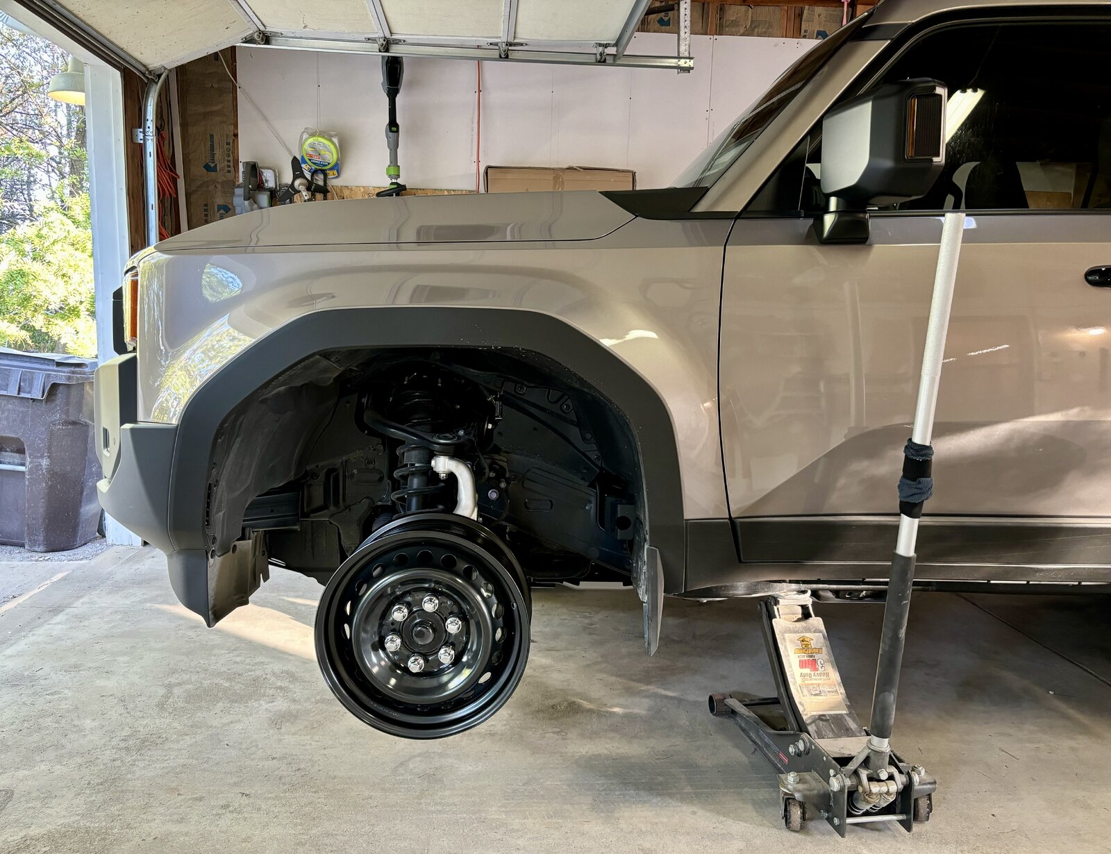

You were wanting the middle-east steelies. No help there.
But here's someone who test fit the Tacoma base steelies. They look pretty good. But the offset could be an issue. 24 (if that's true) is too little. Should be more like 40 to work properly.
Looking forward to a common sense build. But boy, those factory tires are just about the saddest thing on these rigs. Glad they are being replaced.
I feel like they should be fine? GCC spec trucks come with those black steelies. I’d eventually like to go for the silver steelies, but they’re not really available yet (made for base spec Tacomas)
Saw this same post and was really hoping they were higher offset. Can't seem to find any specs published about them anywhere.

Very cool pics! Are those the new Tacoma OEM wheels?
Yup - these are what ship on the base SR5 Tacoma. I really dig the OEM+ look, and I wanted to avoid any poke. I'll prob switch to base Tacoma steelies down the line when they become available in silver. But very happy so far with this set up, and the fact that they're ready available as cheapish takeoffs.
