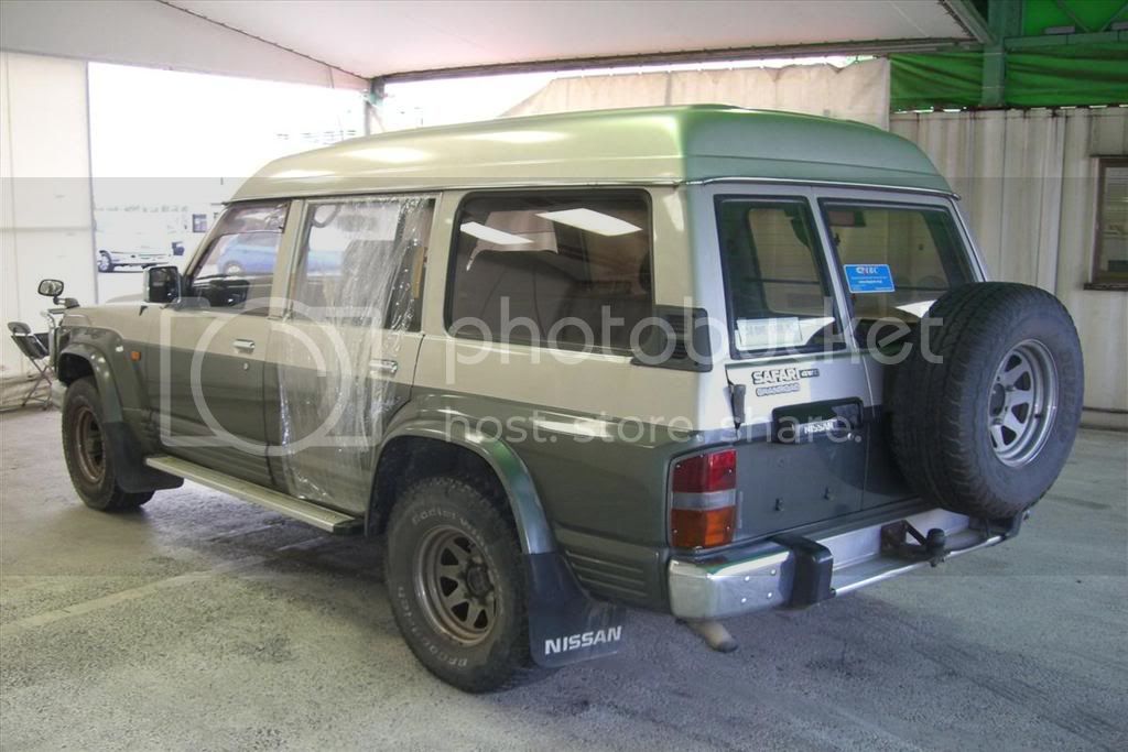

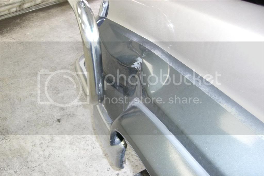

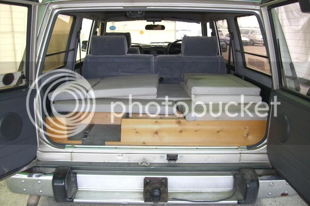

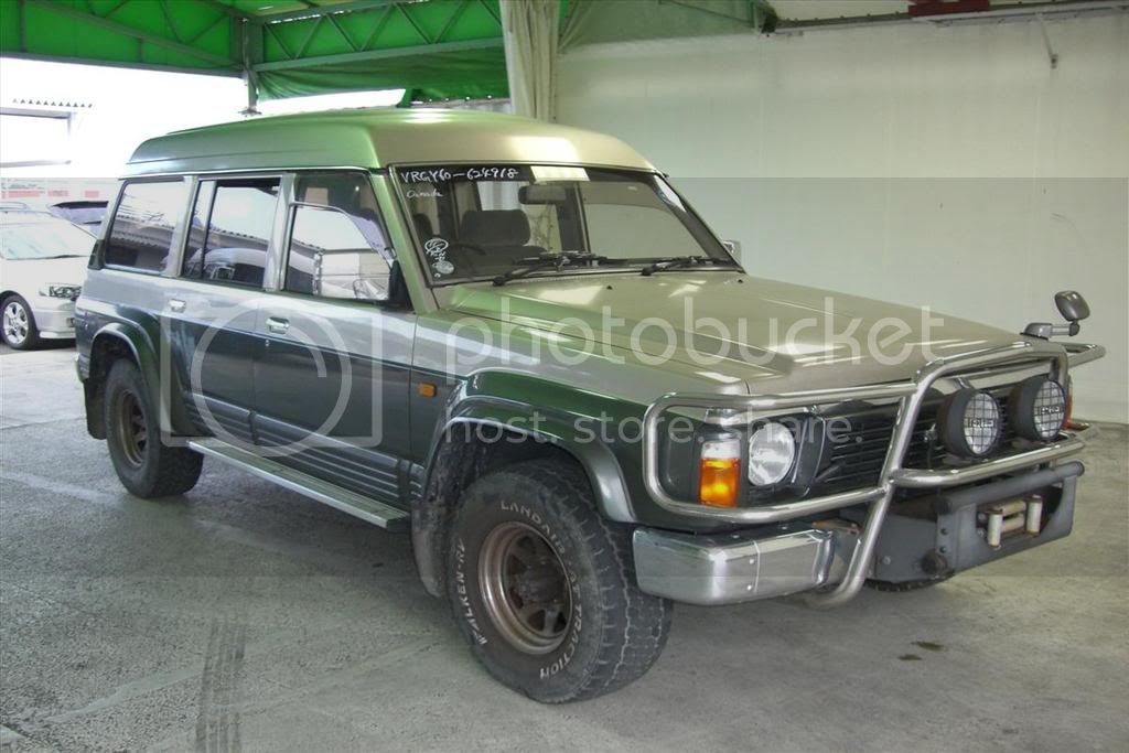

It needs a few things fixed but nothing I can't handle (I think). Here's a few pics:
Damage:
Okay back to working on the deck - really.:rolleyes:
I guess that dent made it a right-off :lol::lol::lol::lol:
GG
The dent, a scratch on the RHS, and an the electric window that doesn't crank (had some practice there) and it was considered the bottom of the pile. Somebody shipped a whole bunch of vehicles but only had part payment. There is a nice shopping cart 2.4L Surf in the lot with lots of leather and bling if someone is interested. The vehicles have been sitting for a while and the Japanese company has to sell them, ship them back or the Canada Customs crusher (note - small "c"). I still need approval from the accounting department. :eek: I am sure she will see the light ($ saving/making) in this deal. ;)

Turns out the "damage" on the door is a stupid splash sticker. :) I was amazed she fired within a couple seconds after sitting nearly a year and a half. Beside the obvious collision damage, the paint is immaculate. The engine and drive train are nice and dry with no sign of any leak ever. After leaving it on idle up most of the afternoon and then the drive back to Abby she still stayed dry. The window regulator on the plastic wap door seems to be okay but the door is missing the window glass. :bang: One rear tire was loosing air. Tried to pump it up only to discover the valve stem was rotten. Good thing there was a spare - oh, but it was rotten as well. Okay, the tires were the same size as on my black rig, so put my spare on the new rig. We hit 91 south and before I knew it Ben (the guy selling the vehicles) is pulling over and telling me it feels wierd. I remember seeing the tire wrench and some extra wheel nuts on the seat and then remembered the notch in the rubber of the rear bumper. It occured to me that this rig probably had 33s on it and they took them off before shipping. Checked the wheel nuts and sure enough they all were very loose except the spare I had just put on. The buggers didn't bother to tighten up the wheel nuts.

I got the grill and bull bar off but first had to grind off one of the foggies which was rust welded on to the bull bar. Nearly 2 days of WD40 soaking did no good. I have another mount so both foggies will go back on. Next to come off is the stock winch bar. The LHS chrome bumper wing is bent back about an inch. There is no buckle in the chrome so I think the "L" mounting plate for that wing was bent back when the PO had the fender bender. I'll take the plate off my spare stock winch bar so I can get Lordco machine shop to press it back to the right angle. The spare I plan to mount on the Black one. After that, its just a matter of fixing the two rear window regulators, setting up the DRL, putting in the new glass and she will be ready for the OOP.
I pulled back the carpets last night. It looks like no one ever entered that rig with shoes on. No dirt and no dust. Also, I had a good look underneath. All the suspension and steering bushings and body mounts look like new rubber. Next thing to check when I get time from work are the wheel bearings and brakes. Hopefully, it will be on the road for the next club meeting.
