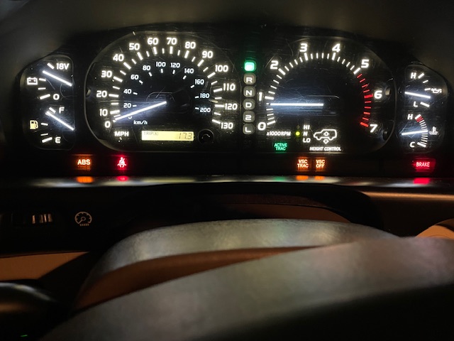

A new problem… ABS, VSC TRAC, VSC OFF, Brake, and Active TRAC lights all on…

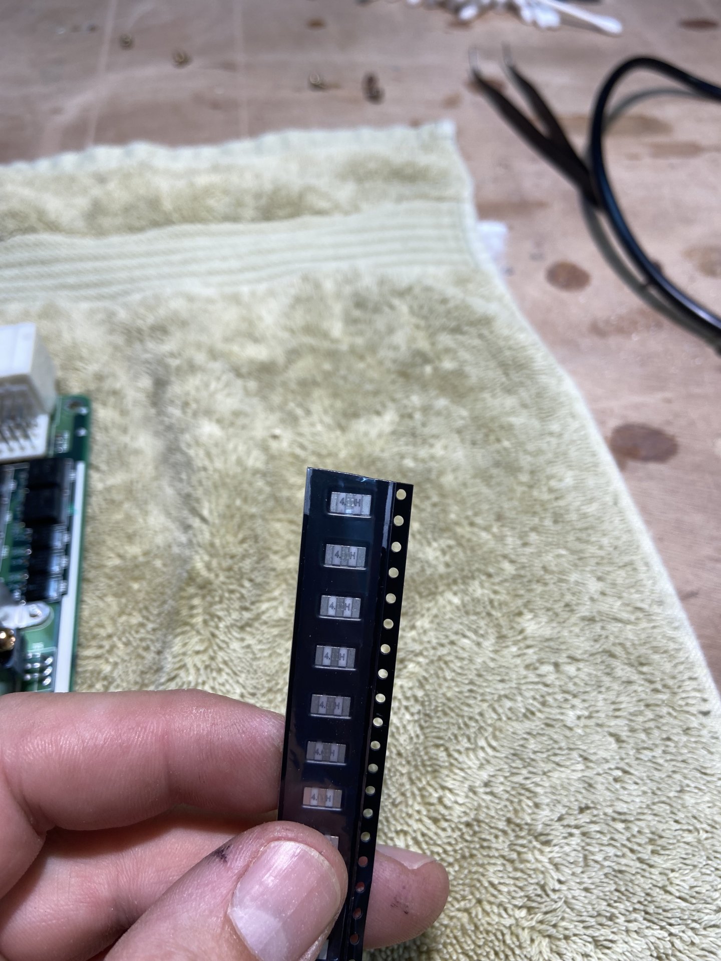

I ordered up the parts and equipment that @FJRyder recommended, as well as a tube of tacky flux and a tube of soldering paste from Chip Quik. The new resonators (I bought a lot of 25 of them) arrived on Saturday.

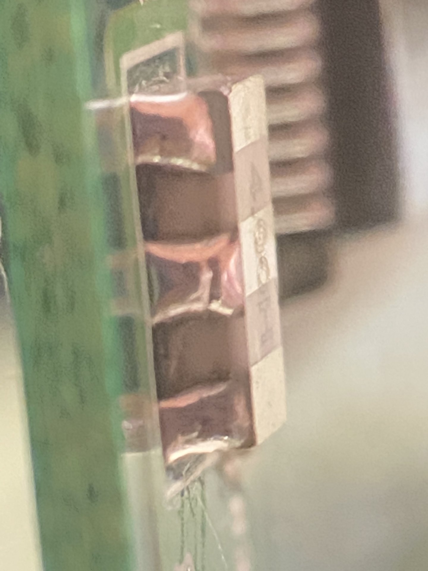

Removing the resonator was more difficult than I anticipated. First of all, it broke apart in several pieces as I was heating it. Finally, after about 4 minutes of heating, I was able to remove the baseplate from the PCB. Then, I carefully scraped off as much of the water-resistant coating off the board near the pads, and thoroughly cleaned the area with IPA.
There wasn’t a lot of solder left on the pads, and I was concerned about a good connection. So, I spread a layer of flux over the pads and then applied six dots of soldering paste, one on each end of each pad. I positioned the new resonator and heated the paste, ans it resulted in some pretty solid connections.

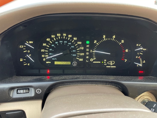

♥️ I love this forum. This just happened to me this evening. I'll be ordering my Techstream cable and running some tests. Thank you all!

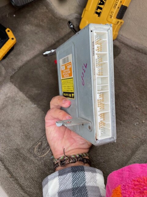

After a couple of failed attempts to load (on my kids PC) the Techstream software I picked up from Amazon, I bit the bullet and took my rig to a local mechanic for diagnosis. He confirmed with his $10k scanner software that it was in fact the ABS computer.
I was able to source a used unit from an online auto wrecker and it will be here this week. My current situation won't allow me to be down a vehicle so I haven't pulled the current computer to inspect the board. My plan is to get the original fixed and have as a backup.

3 weeks and $350 later my lights are reset.
I plan on cracking open the original unit and see if I can visually tell where the problem is. Would be nice to have a backup unit for future me.

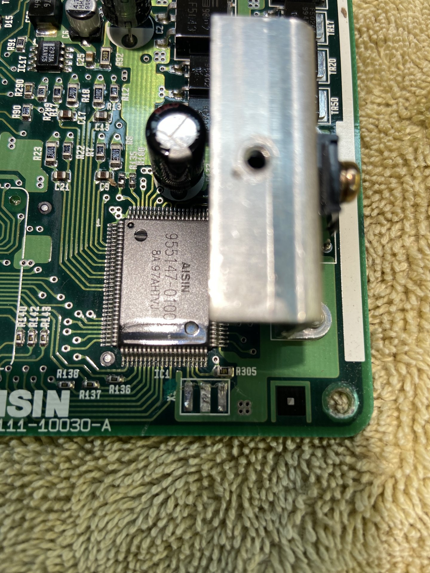

You won't be able to physically see the problem. Its microscopic fractures in the resonator under a tiny metal lid.
The best method to diagnose is measuring the resistance between the pins.

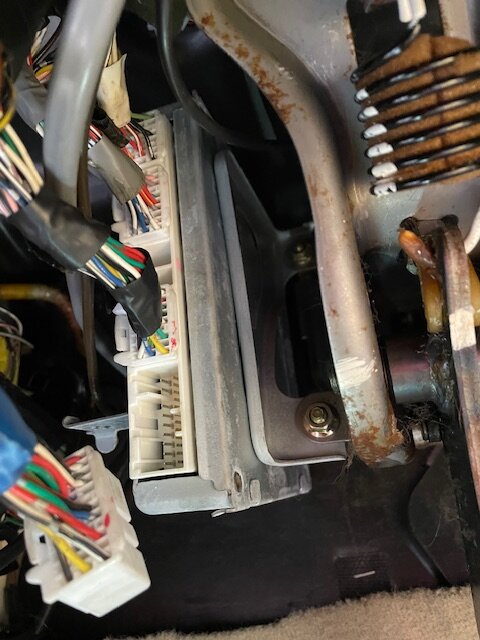

What's the part number on an ABS computer?
To be certain, You will have to go under and see what yours says. Snap some pics with your phone, because it’s tucked under there a bit. Took me 15 mins to swap it out.
They changed depending on the years. 97-02 was mine (I think)
These are the guys that I ordered mine from. Mine was shipped from Canada.
