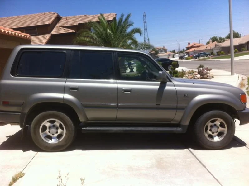

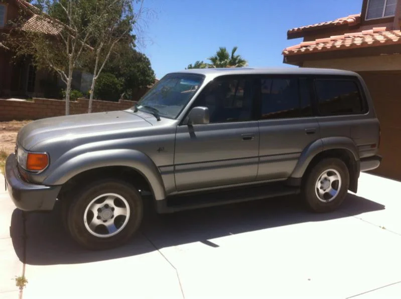

I just got my 97 TLC 40th anniversary. I feel I got the base model. There's no CDL switch or button & there's no front or rear locks... Any help? Any info?

What color is that? I like it.

Looks like Moonglow Pearl. Reminds me of the one int he driveway.

No roof rack or spoiler in an awesome color is a nice find.
