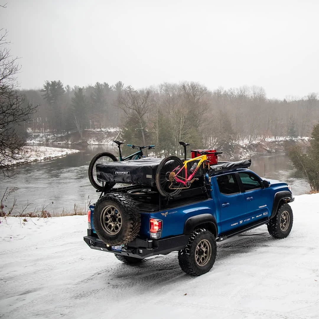

Hi everyone, my name is Daryl and I'm co-owner of Victory 4x4. This is my 3rd gen Tacoma.
This build actually started in 2016/2017 but I wanted to start at the beginning here to bring everyone up to speed. As this was my first modern Toyota build at the time, I learned a lot and have made some changes. I will document everything I can here moving forward.

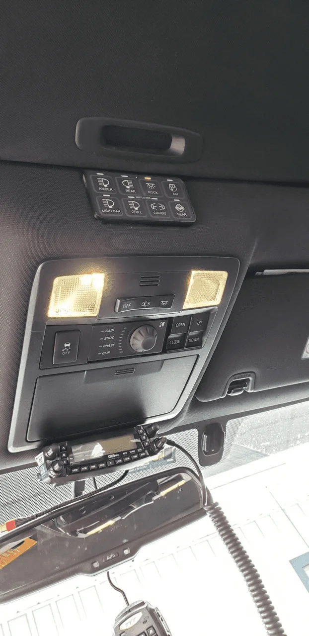

  • Switch-Pros SP-9100 Switch Panel

  • TYT TH-9800 Quad Band Ham Radio

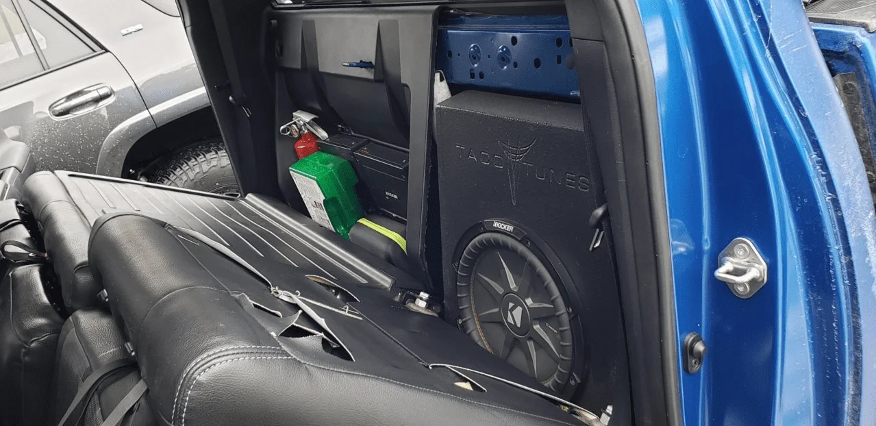

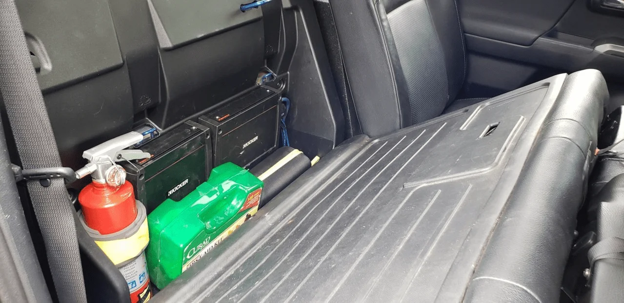

Had some questions elsewhere about the audio setup, adding it here as well.
My setup:
Let me know if you have any questions about wiring or setup. Sorry, the truck is a dirty mess.

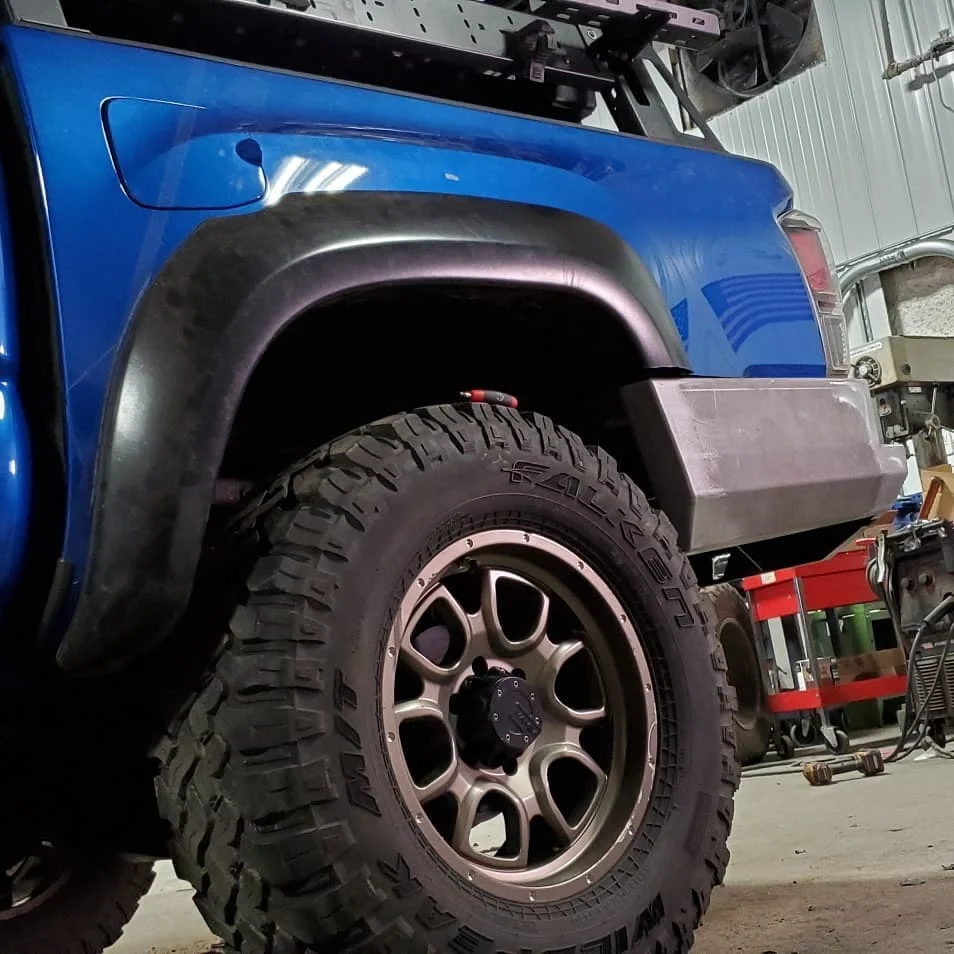

Then mocked up the OEM spindles with the BDS uppers and factory lowers to check tire clearance at full compression at 3-4 degrees of caster. Gonna need more in the rear fo sho.

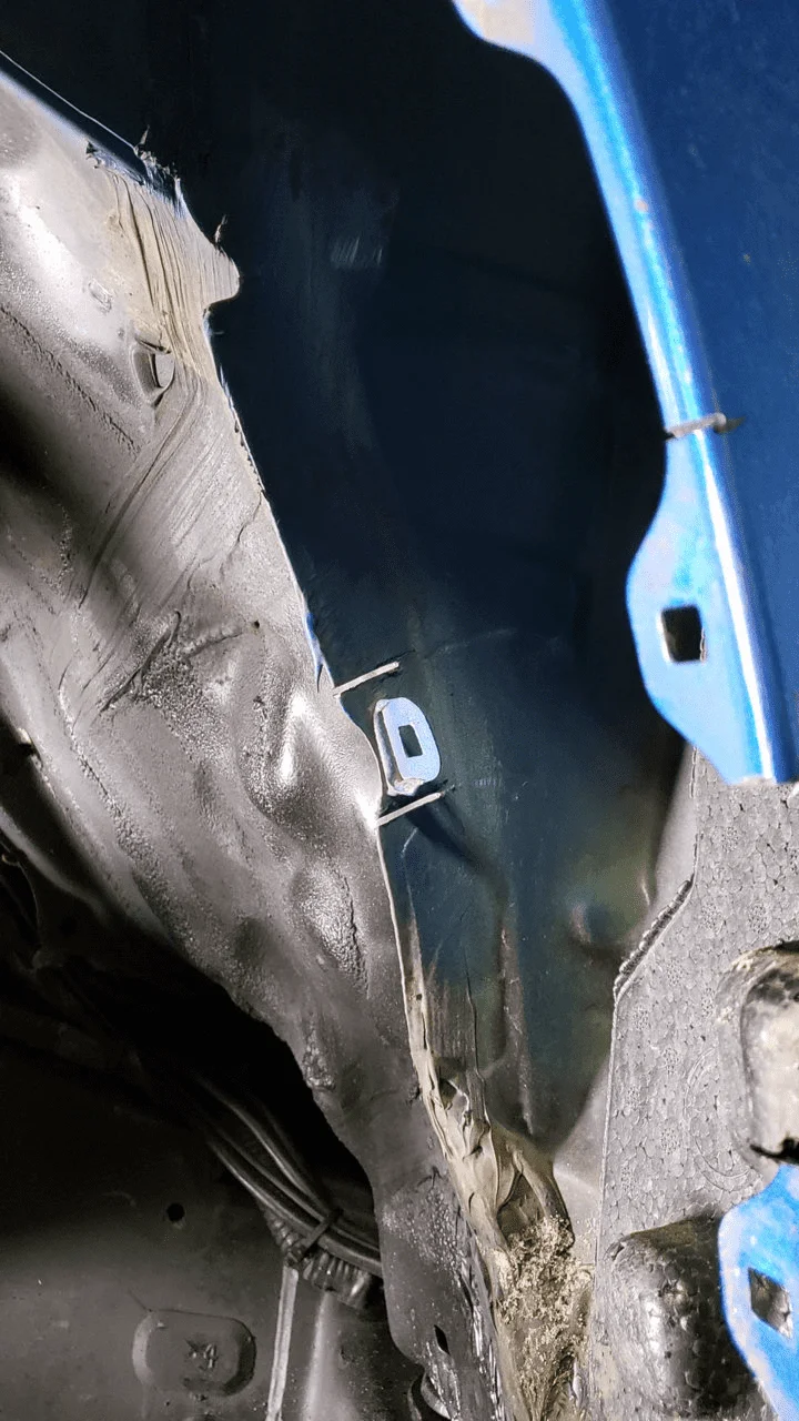

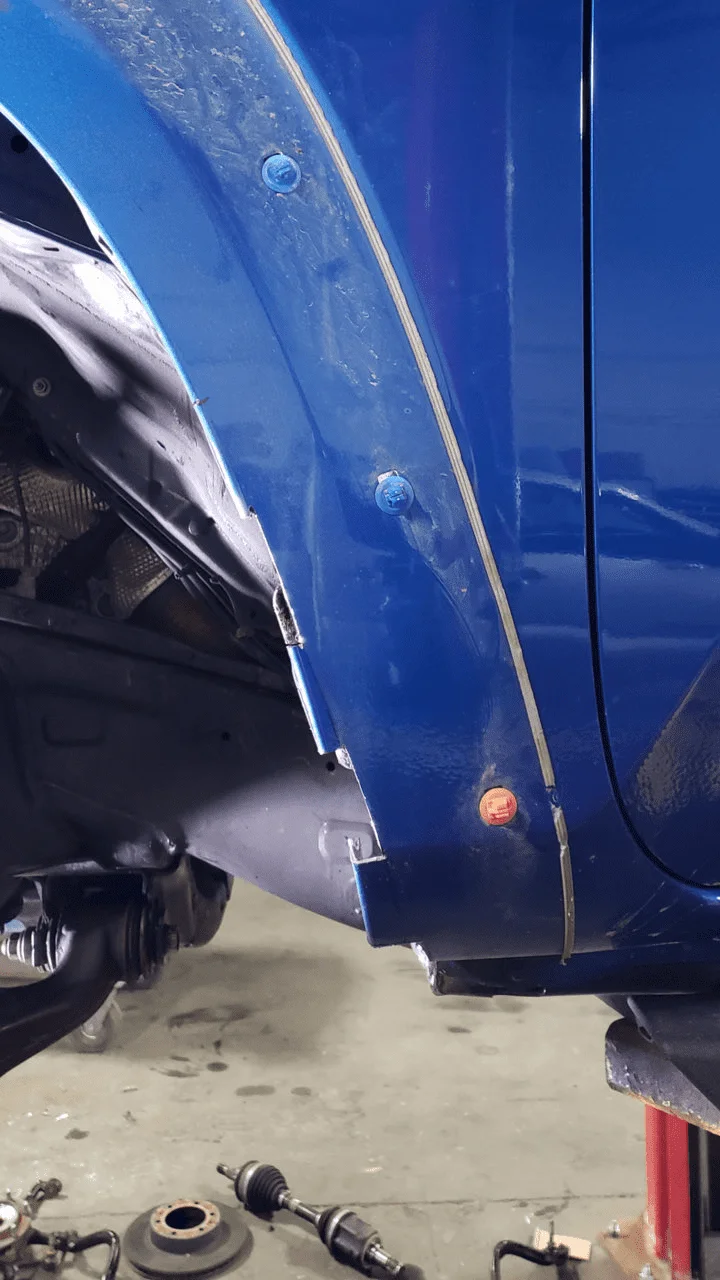

Time for chop chop. My cab mount chop from a couple of years ago is still good, but I was into these fenders even crawling with the 6" kit, so something had to be done.
I still wanted to mount the fender to make it look factory, so I cut like this.
Then I flattened the mounts parallel with the fender.
Then bent them again at my cut line.
Same deal with the inner pinch weld, but I used the cuts to make it easier to hammer over. Also cleaned everything up with sanding disc.
Note the holes I drilled in the lower two fender flare mounts to accept some 1/4" nutserts to mount the fenders.
Painted with metal etch primer.

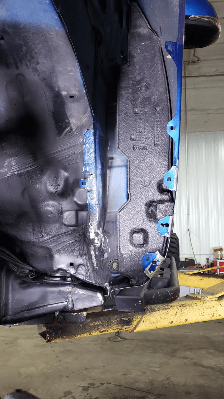

Then added a **** ton of seam seal over the pinch weld and finally some spray-on bed liner over the whole wheel well. This is really the only thing that spray-on bed liner out of an aerosol can is good for
:rofl:
Also bolted on the rest of the new suspension.
Bolted the fender back on and it looks factory. There is about .5" more to gain here if I can figure out a way to bend the flare back more without distorting the heck out of it... Heat gun maybe? I may also try to get an aftermarket flare to see if that helps. What I gained is barely enough at 3degrees of caster. But more (even with the cab mount chop) would be good.

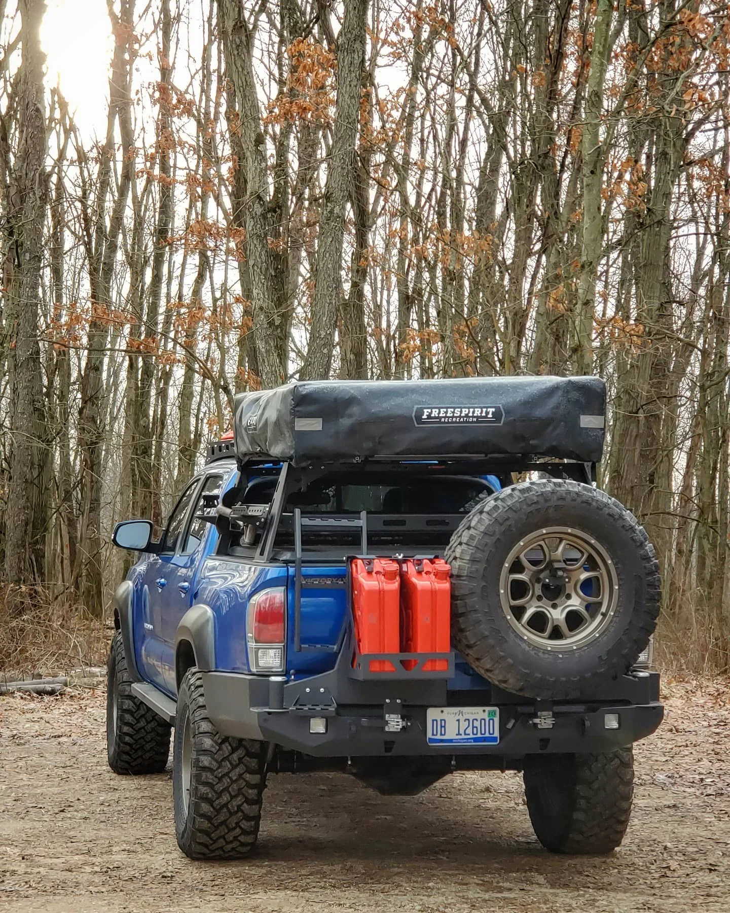

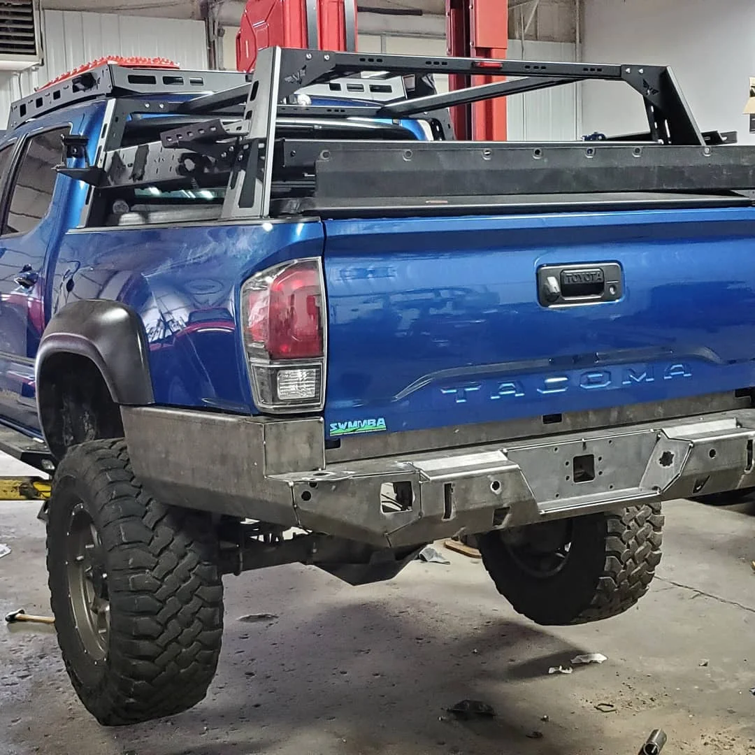

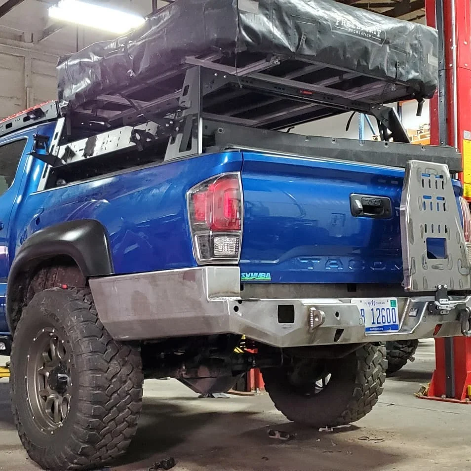

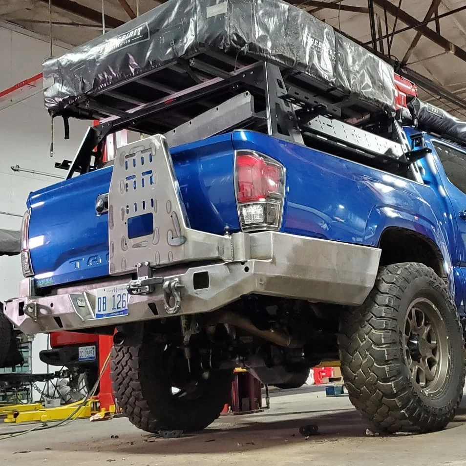

Added our new full height bed rack and roof rack plus some dual jerry cans with the Front Runner mount.

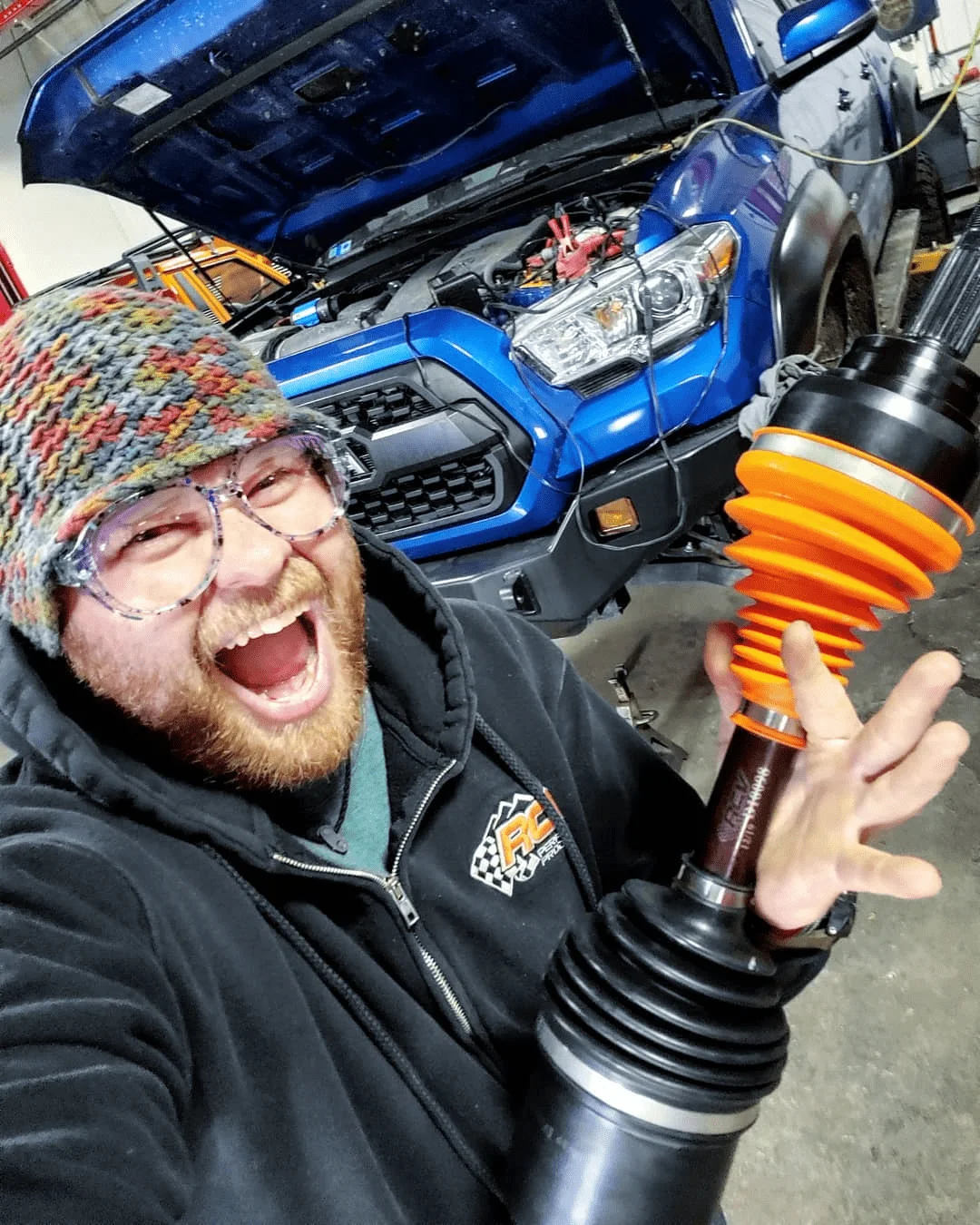

When I added these RCV's I was doing some testing for a new design for them, so I couldn't really talk about them. They have been working fantastic and they have since replaced them with the production version featuring orange boots. They are huge. No longer worried about hitting that front ARB switch
:thumbsup:

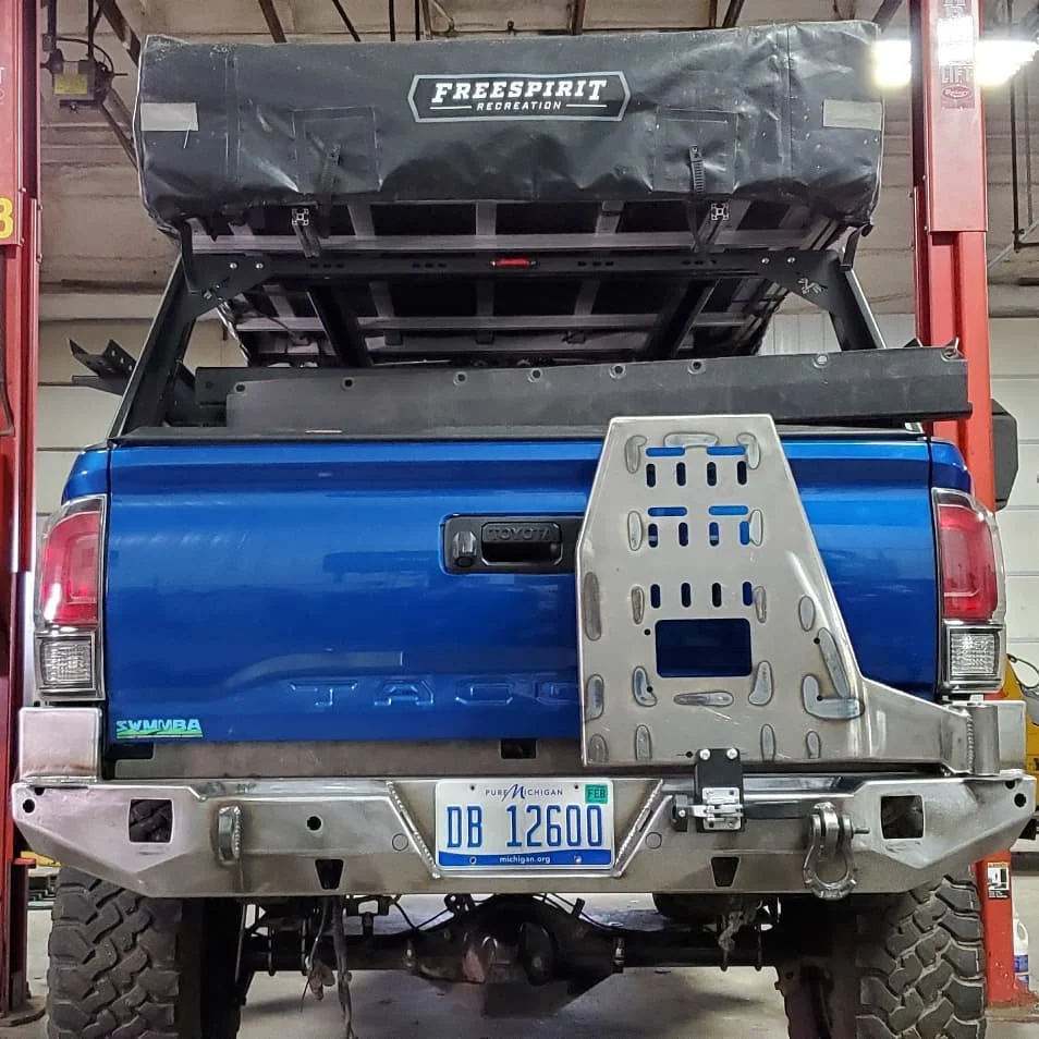

Looks good! Does that rear bumper retain the cross traffic sensors? Also, why do you use SAE fasteners instead of metric?
It does not retain the BSM sensors no. They cannot be blocked by metal of any kind and need to be exactly in the orientation they are stock. Makes for big ugly bumper ends and a big ugly liability for us as well. We use SAE when we can for two reasons, availability and cost. We have way more choices of grades, finishes, and types in SAE in America, and they are cheaper. If we were higher volume we could spec fasteners like the OE, but since we aren't it just makes sense to use SAE where we can. Maybe one day the US will flip totally.
