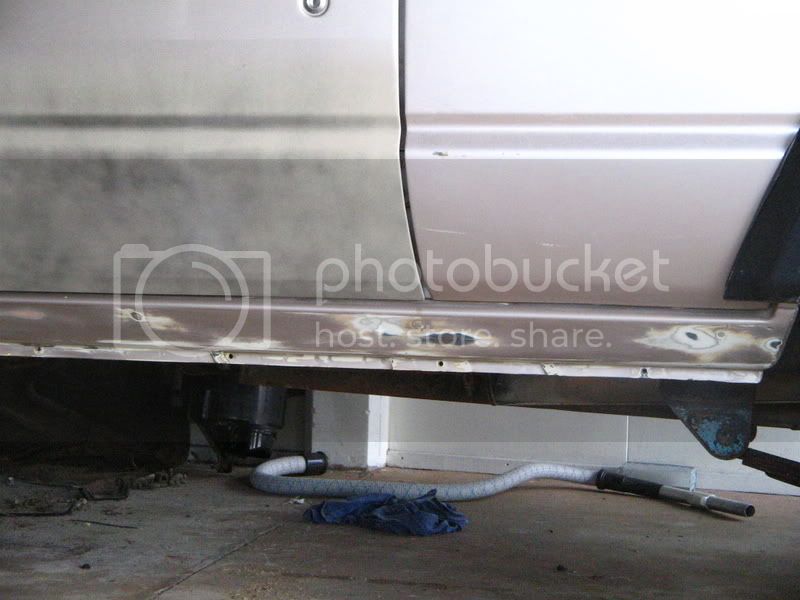

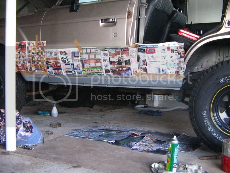

i started by pulling out the old plugs left by the snake blinders and after sanding back around the holes and cleaning the area i bogged them up, once the bog dried i sanded the crap out of the whole panel. once the line i wanted was taped off i put 3 coats of primer down and a hell of alot of Septone stone chip guard down on top of it, tomorrow i'll paint over the previous grey paint with a few coats of black.
rocker prepared for painting:
with stone chip guard on:

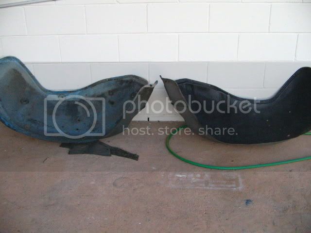

i also have the insides of my front fenders out for painting, the local auto store doesnt stock beige rattle cans
so the engine bay side is still unpainted but i coated the wheel side with cheap black spray paint, this paint will get chipped reasonably easy but at $2.50 AUD a can who cares.
