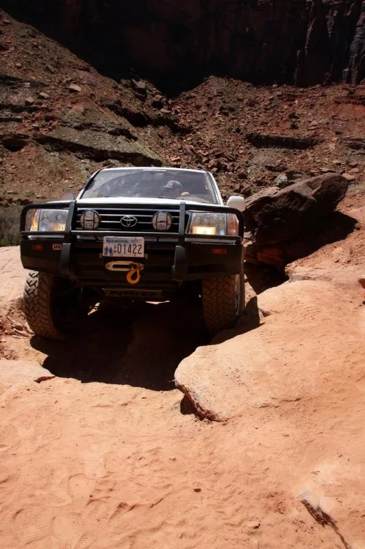

This is a build that we did a few years back at Just Differentials using many parts from Nitro Gear and Just Differentials. This is the only vehicle in the Nitro /Justdifferentials fleet that was around since the beginning. Its been the platform for all types of new products from gears, suspension, etc. Its also daily driven and sees 20K annual road miles along with numerous trips around the northwest, Moab, Colorado, and more. Really a Do-All vehicle.

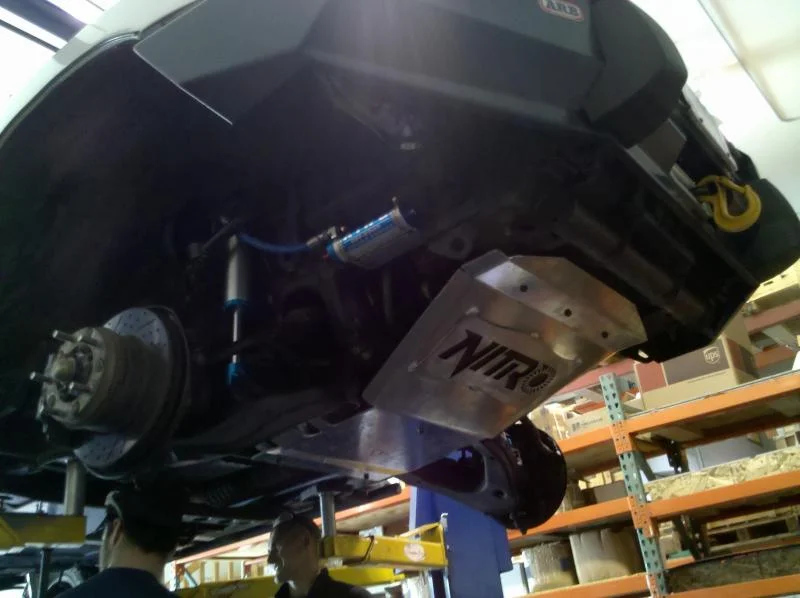

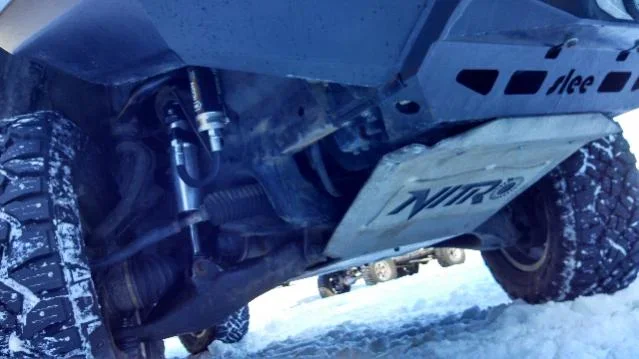

We installed our Super Deluxe Suspension System with ICON 2.5" Remote Res shocks and Uniball UCAs on this build:
You can see the difference between our UCA and the stock UCA here:
(note, the new version now uses a ball joint!)
We went with 2.5" ICON remote reservoir CDC shocks, which we developed with Icon to use in our Super Deluxe kits with longer travel UCA's
Prototype Ball Joint Style Upper Control arms, specifically designed to work with Extended Icon shocks for maximum travel and ride quality
Optional ICON Vehicle Dynamics Billet lower rear control arms with our suspension system:

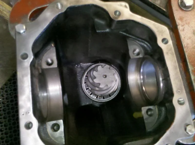

Even though the 4.88's do the trick to re-gear the LC for 35's, we wanted a to have a little more power. Enter a 10 injector TRD Supercharger from an 04 tundra, and a Unichip ECU:

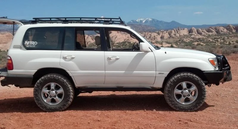

What size 35's are those? Are they on 18" rims?
295/70/18 Nitto Trail Grapplers
Currently 295/70/18 Nitto Trail Grapplers in the photos. 275/70/18 studded in winter, have run 315/75/16 in past.

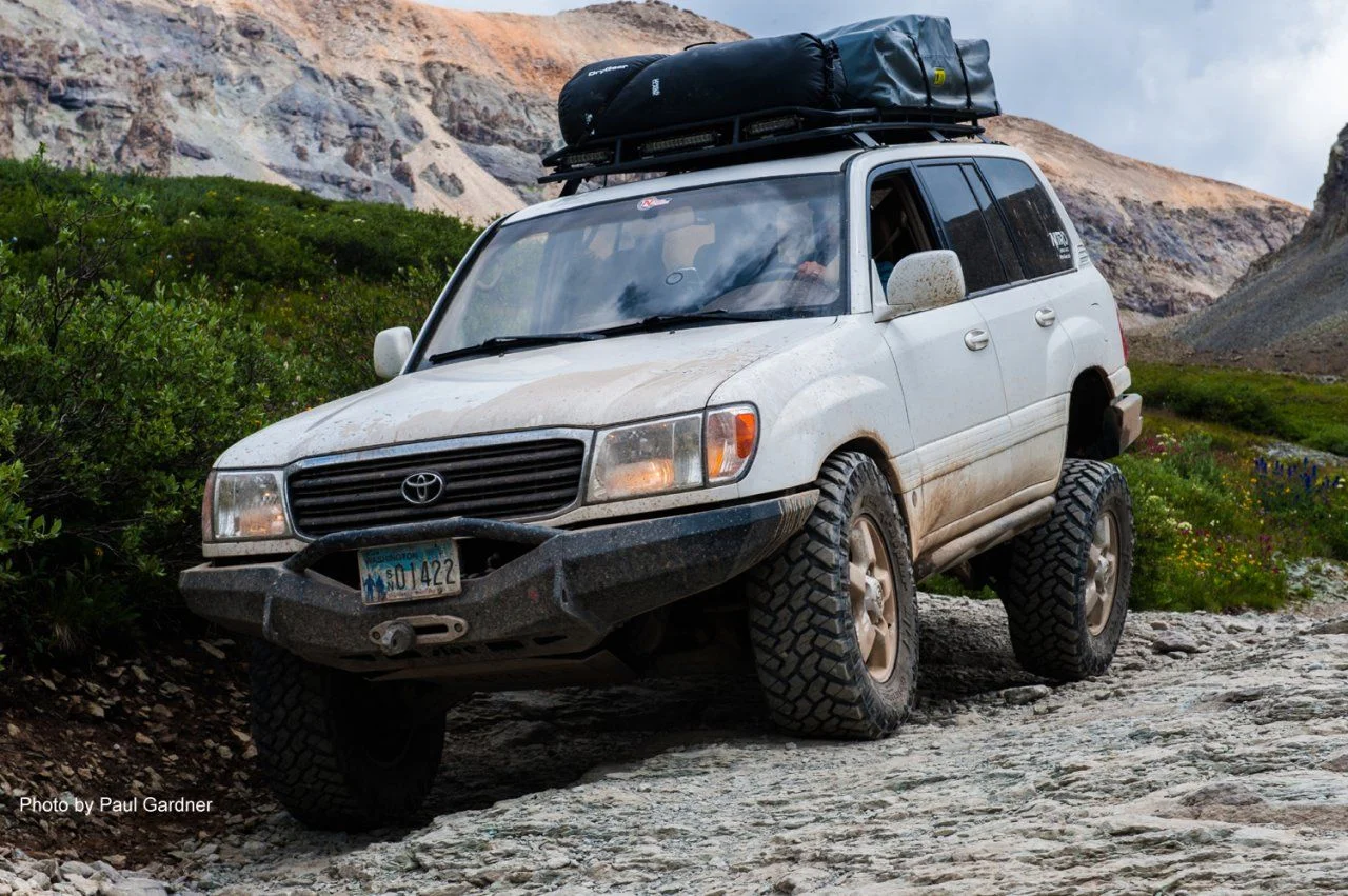

Gobi Rack install
Finally added a rack to the 100. I went with the Gobi rack. I really love these facts:
-Low profile (no higher than oe rack and thule snowboard carrier)
-Sunroof remains fully functional via quick release panel, actually runs as quiet as stock if not quieter because of the included wind fairing
-Pre-wired for lights
-Strong, can support plenty of weight, RTT, etc (200 lb shop guy in pic)
-Direct bolt on to OE mounts
-Lightweight, no noticable body roll, etc
GOBIGLC100STL GOBI LANDCRUSIER 100 Stealth Rack (MUST SPECIFY, SUNROOF OR NOT) PRICE INCL TRUCK SHIPPING TO US48 $1499

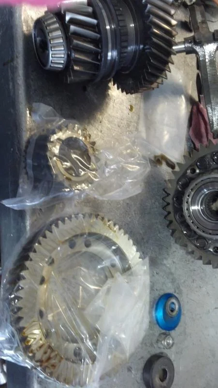

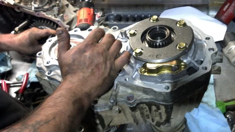

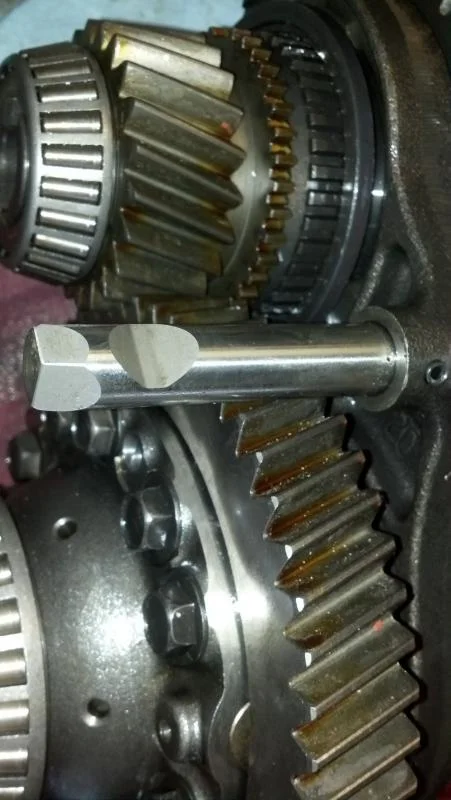

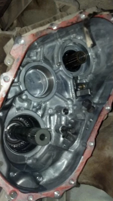

3.12:1 Low Range Crawler gears for 80 & 100 Transfer Case
Also added before Cruise Moab this year:
These gears replace your stock 2.488:1 low range ratio with a 3.116:1 ratio! The end result is a 25% gear reduction for your FJ80, FZJ80, or 100-series Toyota Land Cruiser, which combined with your automatic transmission's torque converter, results in almost a 75% total reduction for awesome Rock Crawling No replacement bearings, seals, or gaskets required. Installation is simple to accomplish using standard hand tools, shop press, bearing splitter, and grinder. Requires silicone, thread sealant, and replacement gear oil. Your automatic transmission fluid does not need to be changed
Made in Japan, OE Quality. Fits all 80, 100, 105 series Landcruisers.
  • [FONT=&quot]1 - Differential Low Speed Gear[/FONT]
  • [FONT=&quot]1 - Idler Low Speed Gear[/FONT]
We just installed these in our 100 series before Moab last week. Results are excellent. No change is made to high range, but the heavy Landcruisers really benefit from the lower-low range.
Retail $799 for the set.
Viscous Coupler Land Cruiser 100 series mod
Mine's a 99 so with the 4 speed Auto, it pulls very hard on the 2-1 downshift if you stomp the throttle at say 10mph. This would cause some torque steer and have a tendency to burn off 1 front tire in loose or snowy/icy conditions. I noticed it pulled much straighter with CDL engaged. I installed the back half of an FZJ80 Transfer case to get the viscous coupler. All a direct fit, just had to shorten the driveshaft 3". Results are much nicer overall tighter feel, more controlled acceleration, much better traction in unlocked high range in snow.
More shock options! Our friends at Icon Vehicle Dynamics contacted us to help develop some shocks that are specifically made to fit with our super deluxe kits. We recently fitted these and have experienced great results. Now available.
We also added the icon billet adjustable lower rear control arms. Build your own kit here: http://www.justdifferentials.com/mobile/Product.aspx?ProductCode=JTOTLC100-SUPDLX
NOW AVAILABLE - BALL JOINT STYLE UCA'S FOR 100 SERIES (ALLOWS EXTENDED SHOCKS FOR LONGER TRAVEL)
Follow this link to purchase as full kit form. Several options listed. We also offer everything seperately:
http://www.justdifferentials.com/JTOTLC100-SUPDLX-D-p/jtotlc100-supdlx.htm
The uniball type were very good, there was a general perception that they required maintenance, and that the 100 series crowd being more into oem like components. For this reason, we redesigned them to use a ball joint. I've run the prototypes for 3 years with no servicing, other than normal preventative grease,as the upper bushings and the ball joints are greasable.

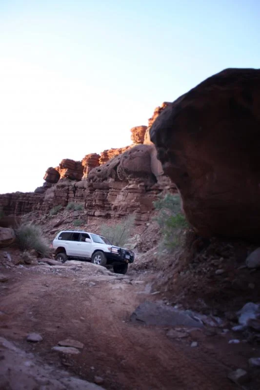

FYI, the rear shocks are also extended length. We get asked a lot. They are as long as possible, while still keeping the coil captive. This pic is not quite at full flex.
