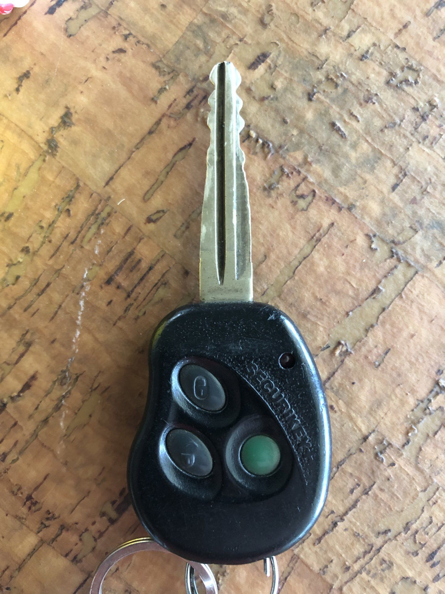

That keyhead unit is interchangeable with the little boomerang shaped remotes Toyota had...I've seen them on older Camrys before...I'll look for some pics.
Here we go....I've seen them labeled as Audiovox, Prestige, Pursuit, Pro...etc....but they're all the same interchangeable remote.

eldgenb, does your key fob have this imprinted on the back - "FCC IDELVAT 6B"? I'm beginning to wonder if I purchased the wrong fob. My old one is all worn out and I cannot read the back.

My 97 TLC came with one Securikey+ remote (key and plastic all together). It has the same "FCC IDELVAT 6B" that you have on the back. I found a crowd off of eBay (www.keylessride.com) that sell just the black plastic part with the buttons and I ordered one (I also ordered some blank keys off eBay - still waiting on those). The remote arrived today and I followed the instructions to program it. It worked for me.

This works. Thanks @keithf. Bought my key fob here at Fred Haas Toyota: TOYOTA OEM 00014-S0260 SK+ REMOTE

Any fob with a matching FCC ID will work after programming using the above instructions. I picked up a new fob off of eBay. It's a 5 button fob but I only programmed 2 of the buttons. I have the truck in valet mode so it just acts as a keyless entry vehicle. I have also bought the original key fob but without the Key and they also worked great.
