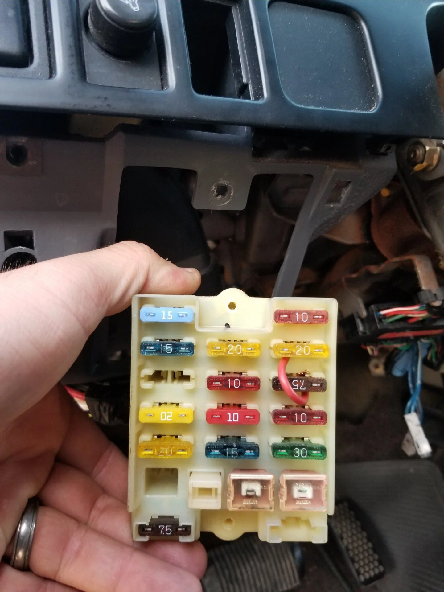

Have you checked the ignitor? That is the one item in the system you have not mentioned. I'm no expert, just looking @ the FSM for my '91... Good luck!

Could be fusible link, old malfunctioning alarm, etc. Mine did something identical once and I found that I had no power to the ecu fuse. Just ran a jumper to it until my fusible link arrived. In the meantime I ripped out the alarm. Replaced the fusible link and then all was good. Are you sure you have power to this fuse
