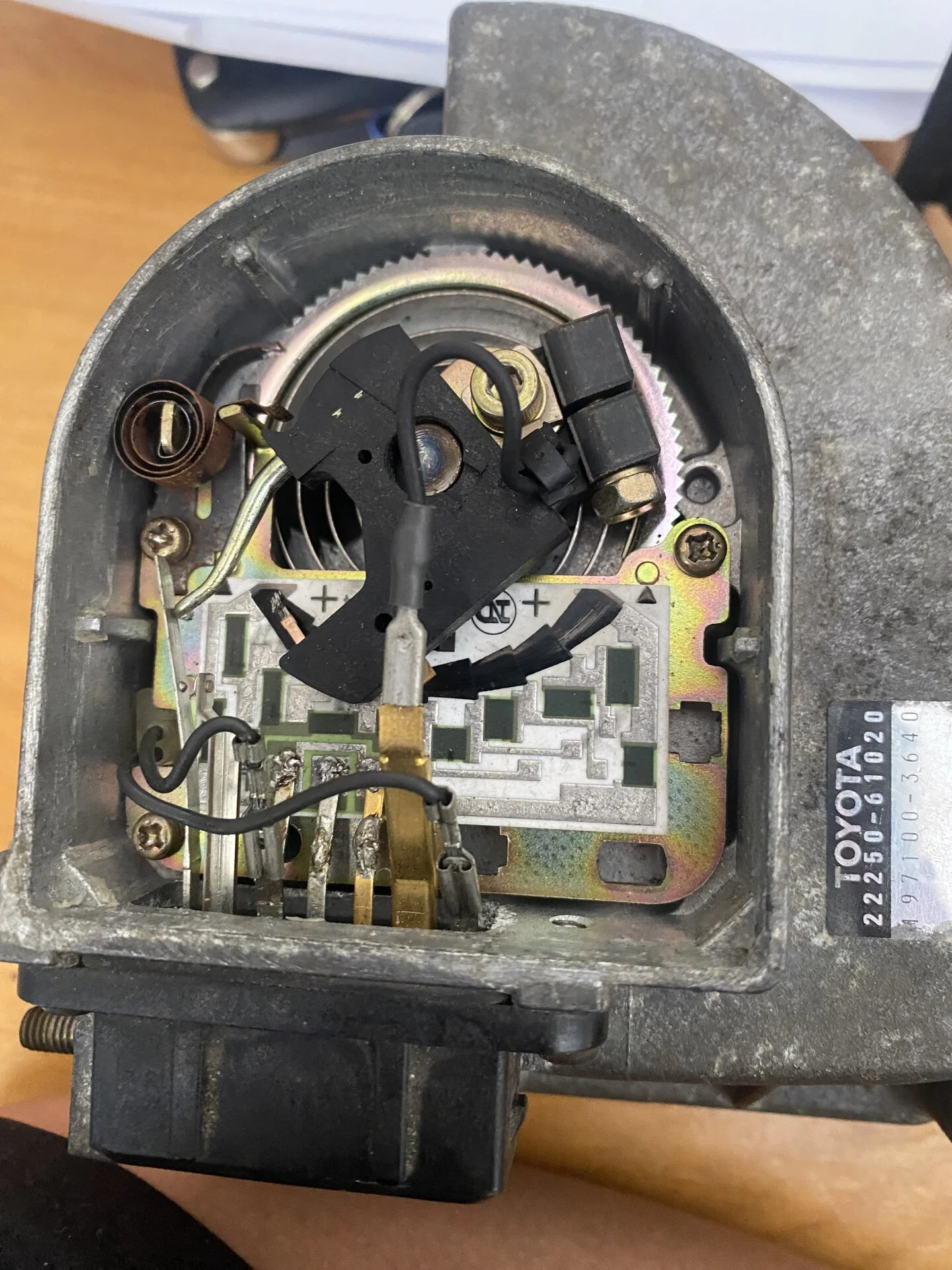

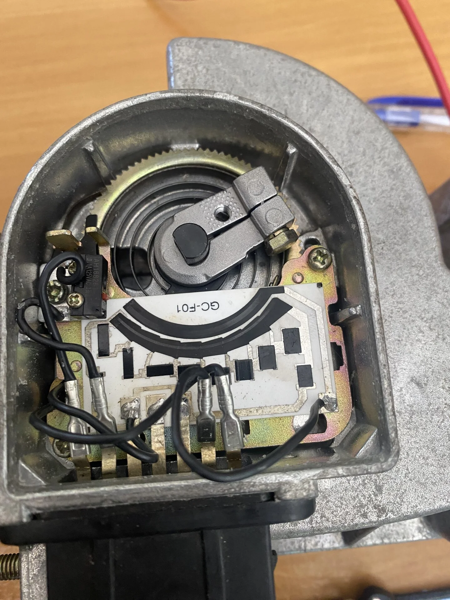

I also believe the internals may be abit different to the original too. Aleast mine was. I have a few photos that show it better.
As you can see I also had to solder the original aswell. And has surprisingly been okay and is now within spec. The other one from ebay looks abit different with 2 different tracks and a switch instead of the mechanical metal. (Ebay VAF does normally have the same ish rod in the middle)
My guess is they are just cheap products from china from people trying to make a few bucks without actually doing the correct testing.
So yeah I would try start looking for a new original. Or if your abit of a tinkerer like me try get your old one within spec 🙃
