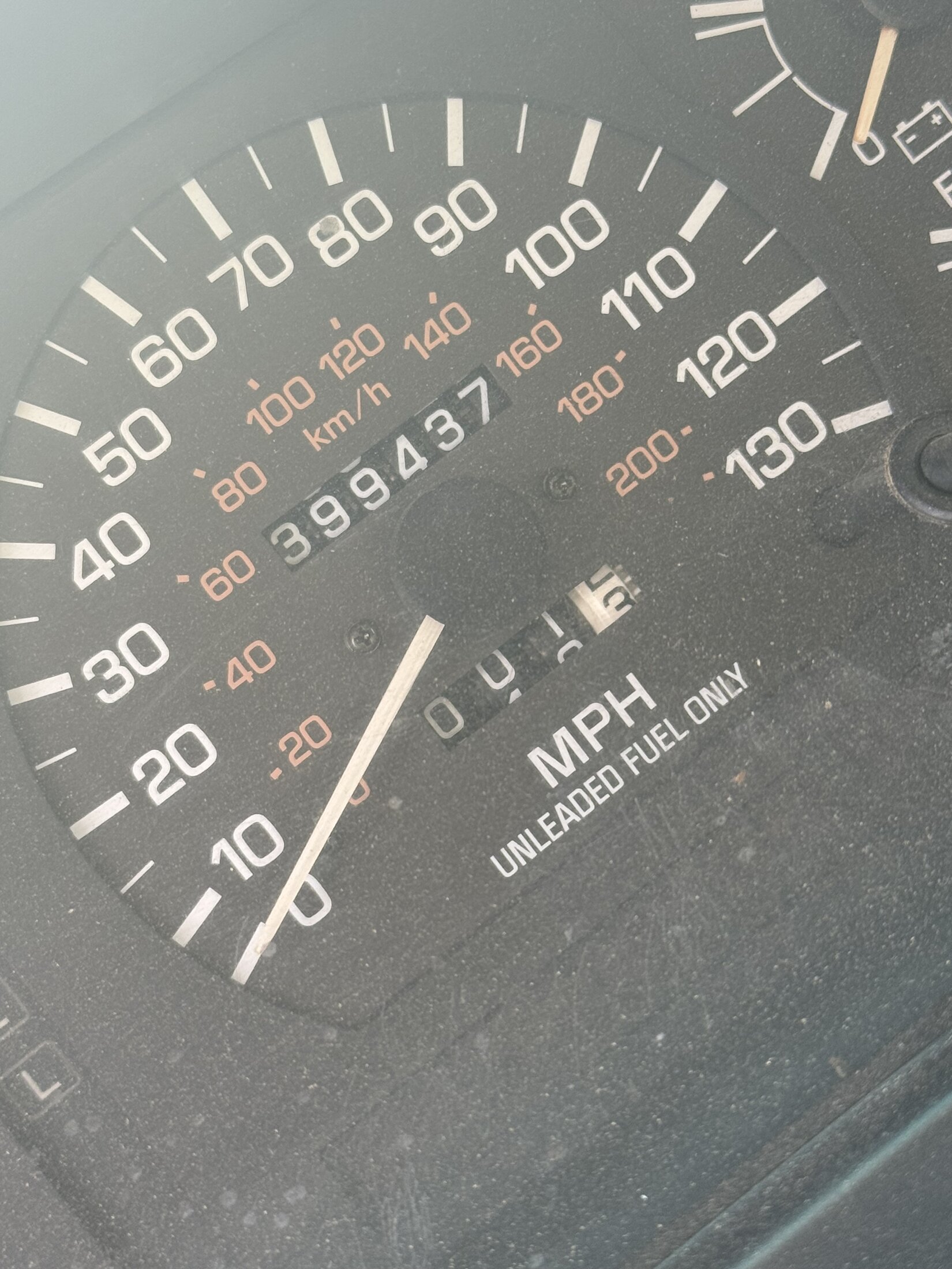

Help me get this ok girl back on the road so she can hit 400k and I can give to my son 😎
