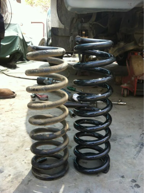

Hi all,
I need help on the front OEM coils on the 90.
I recently put in a new suspension and now I notice that on pot holes I get a very hard down force from the front side.
Is it that the coils sitting at the shop will take time to ease out or do I have wrong/stiffer ones on.
I have no bull bar / winch up front.
I also notice a slight negative camber, enough for the naked eye to catch.
Help help, what to do.
Did you replace the springs and the shock absorbers?
What brand did you use?
Why did you change them - was the front end sagging - if so, there will be a noticeably firmer ride using new suspension parts, even if they were Genuine Parts.
If the camber has changed it suggests a taller stiffer suspension, in which case you need to consider camber correction bushes which will get it back to tolerance, ideally from the same manufacturer, but they are available from others.
