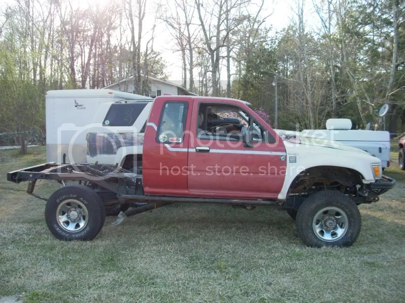

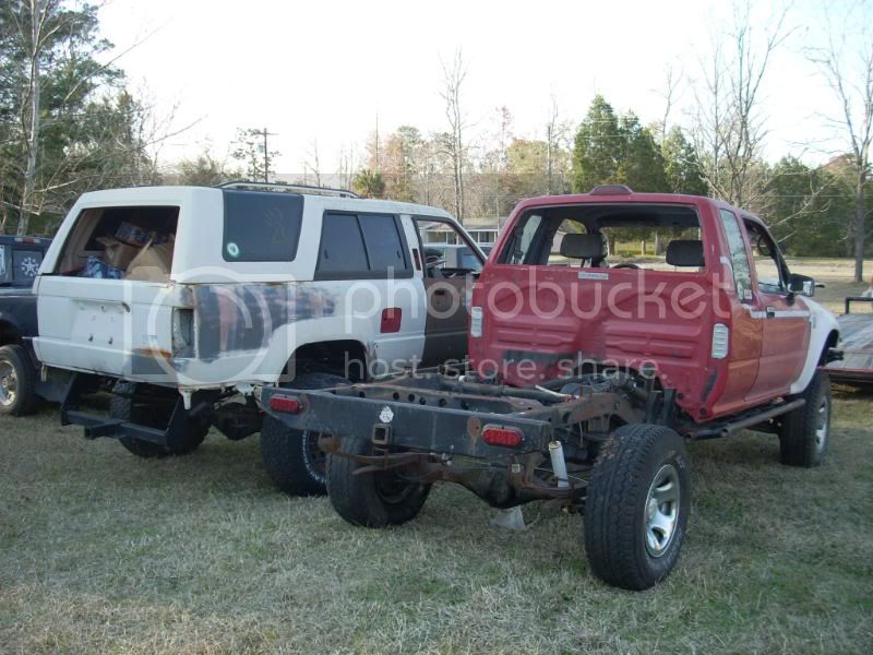

Another day or driving and hauling Toyota's across SC. We picked up Scott's (Greenseaman) old 94 pickup today and enjoyed meeting him and his mom/pop. The truck was actual in better condition then I was expecting but it wouldn't start. I'm thinking it's the starter, well actual I'm hoping it's just the starter. I'll post up some pics later.

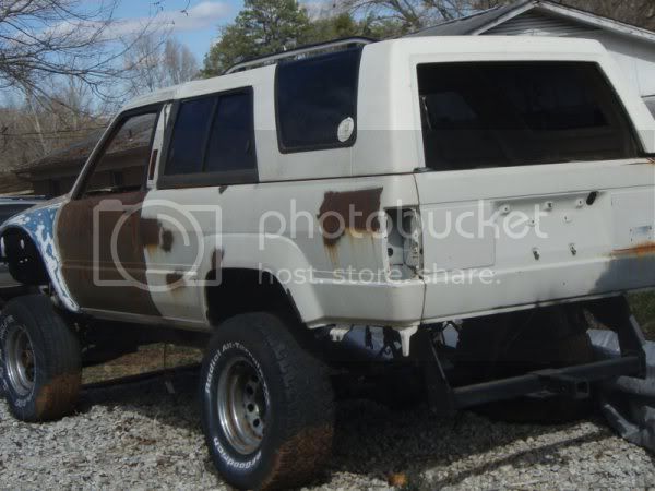

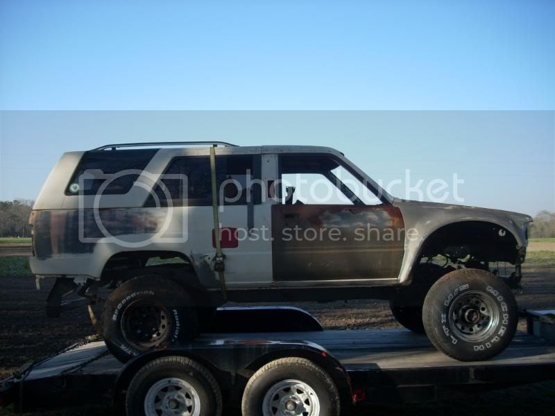

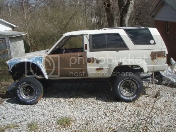

Here's a few pics that I took of the 94 pickup and the 4Runner. This build will move along slowly due to me living 2 hours away. So I will only be able to work on it during the weekends that I'm free to come back home.
From here I'm going to start by sorting out the huge pile of parts that are for the 4Runner. Which is mostly interior stuff, I think I'm going to have to find a another dash because the guy that owned the 4Runner was trying to cover the dash with some gray tweed to match the seats. After I get all the parts sorted I'll some what know what else I'll need to find to put the 4Runner back together. Then I'm going to get the brakes working, for some reason he removed the master cylinder and booster. I also need to find a steering wheel, he had a GT steering wheel but couldn't find the hub for it. Then I'm going to prep the 4Runner's body and have it primed. My mom is friends with a guy that does body work, so I'm hopping he'll paint it for me. It's completely stripped down so now is the best time to have it painted. I also need to find a windsheild and door glass. I could always remove the glass from my brothers rusted out 85 but I would rather not take anything off of it. Before I start pulling the engine out of the pickup I'm going to replace the starter and hope to get it running good enough to drive around the yard. I have a stock 4.10 3rd member that I'll put in the rear axle housing, if needed.
A few of the 4Runner,
The 94 pickup,

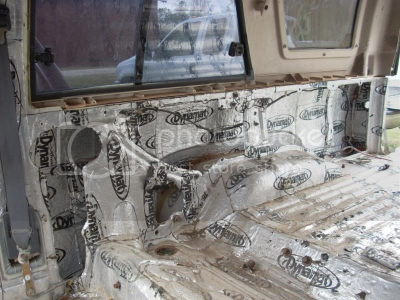

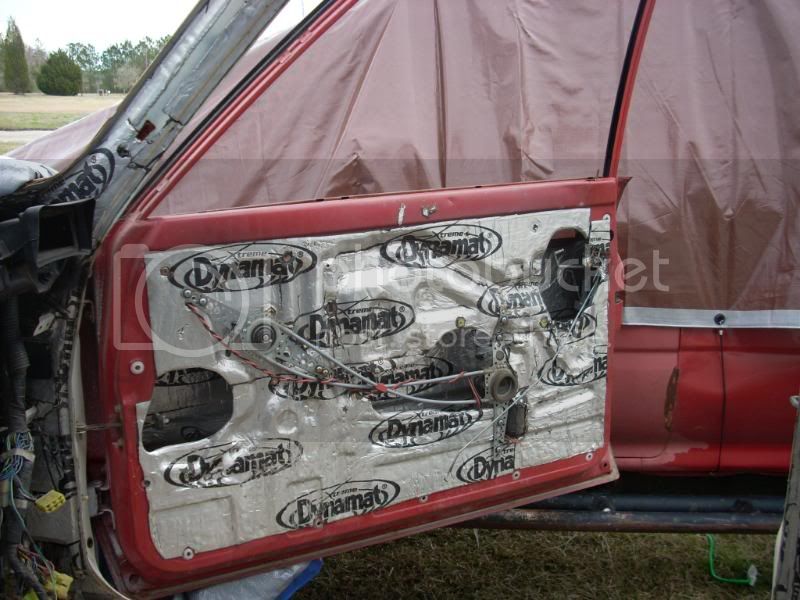

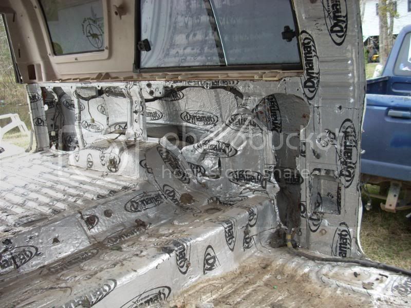

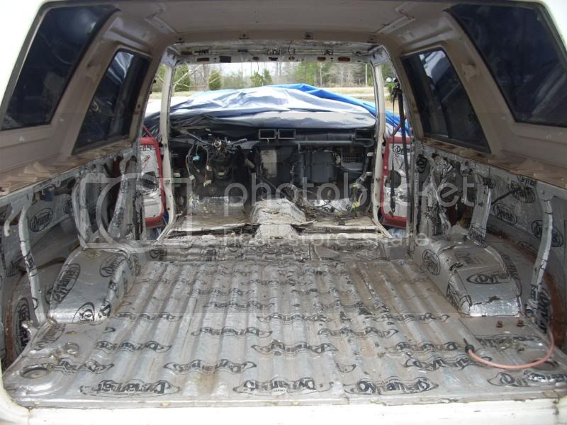

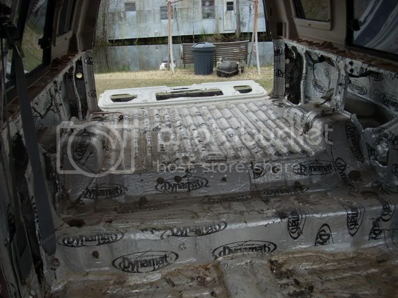

Today I cleaned out and sorted out the parts that came with the 4Runner. I found the door glass and about 90% of the interior, there is also another dash that has been covered in tweed. Took a few pics of the interior and all that dynamating. That stuff is every where, it also makes the body sound as if it's covered in bondo or fiberglass. There is some type aftermarket power window and door locks on the doors but I will have to figure out some switches.
Small world. I bought the ARB from him the night before you were to come get the 4runner.
I wished all that dynamat could have been removed as there is probably as much of it $ wise in that truck as what you paid for it. (I asked if he had anymore and he said no. Your right about his buddies being wasted. They were tanked when I showed up to pickup that bumper, he told me he had other items, but could not get them b/c it was his drinking night. :rolleyes:

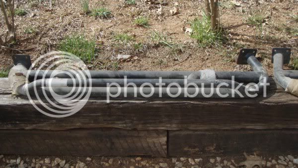

What actual make this crazy, is that I was in Due West last night. I picked up a 89 4Runner for myself to keep or flip (sell), I haven't decided what I'm going to do with it. The only other thing that I had was the "rock crusher bars" as he called them. I wasn't sure about getting them but when I held them up the 4Runner they have this little hoop that goes up alittle higher then th erest of the bar, well that helps with the 3" body lift.

I'm going to be working on getting the 94 pickup started, I hope the 4.3 is in good running condition. I also have a friend of my mom's who does body work coming by this weekend to look at the 4Runner. He's going to paint it for me but he wants to see the condition of it. The last time I talked to my brother we talked about what color he'd like and we decided to go with a gray. I'm going to think cheap with the paint because the 4Runner will be used offroad, so a trip to tractor supply and I found the color I want. It's going to be Massey Ferguson Gray and the removeble top will be a standard black. I hold a friend back in Fl that painted his 4Runner with tractor paint and it came out very good, it actual held up good and didn't sratch easy.
I'll take some pics tomorrow and report back with some good news I hope.
Steven
I didn't take any pictures today but I did get the 94 pickup started. The 4.3 sounds really good with the flowmaster. I drove around the yard and down the road, I even did a little burn out. The power of the 4.3 compared to the 3.0 is cool. I can't wait till I get my 91 4Runner on the road again with the 96 4.3 that I have for it.
I didn't have to change the starter, I'm not sure what the problem was last weekend when I first tried to start it. All I did was turn the key a few times after hooking up the battery, then I started to crank over. It still didn't start, I found out that it had blown fuse for the fuel pump. After I changed the fuse it start right up. I let it idle for a little while and did a sea foam treatment, by sucking up a 1/4 can through the vac line on the brake booster and poured the rest of the can in the gas tank. It start pouring white smoke which is normal and I let it idle for a few minutes till the smoking died down. Then I drove it around the yard some more and started to smell gas. I get out and looked under the truck and I found that I fuel line had a crack in it. It's the hard metal fuel tube but I don't really care since I'll be removing the engine and putting it in the 4Runner. So today was a good day and I got everything done that I wanted to.
