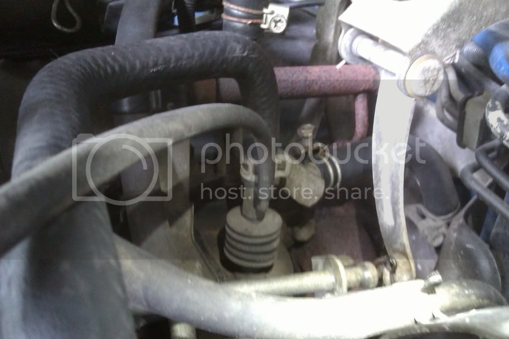

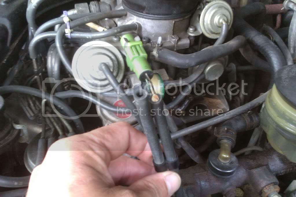

well another day.. problems is back and after pulling on a couple of the vacuum lines i found two that were not connected and one was capped. - yea i know.
the hose on the left connects to the throttle positioner (beside the green plug) where does it route?
the hose that's capped connects here(pic below) where does it route??

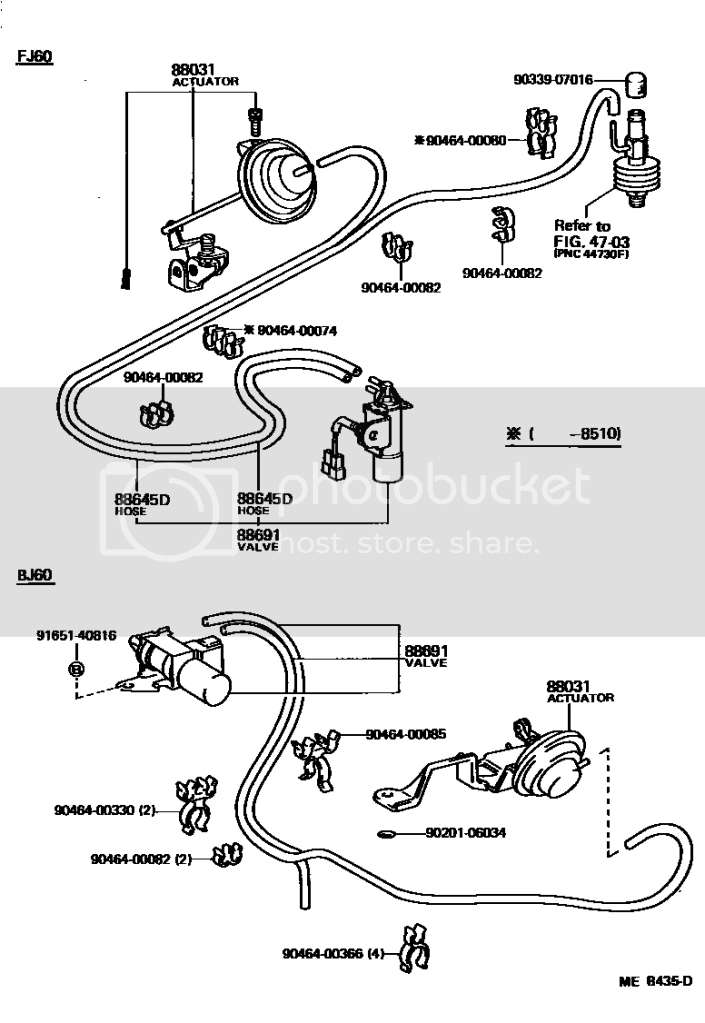

after talking with some folks it looks like these hoses control the idle up speed for the AC- and connect to p/n 88691 VALVE, MAGNET (FOR IDLE UP DEVICE).
Does anyone know where this part is mounted? By the diagram it appears the have a 90 degree clamp so Id assume it mounts to the firewall or wheel well but i cant find it- I did find a female electrical connection on top of the wheel well that's just sitting there.. Is that where it was and someone cut it out? Could this be part of the lunging problem or is this a separate issue? Many thanks..

Ozark, PN 88691 is usually mounted to the vertical inner fender w/ a 6x1 bolt (10mm hex). It does not effect how the truck runs. Only idle quality w/ the AC on is effected.
