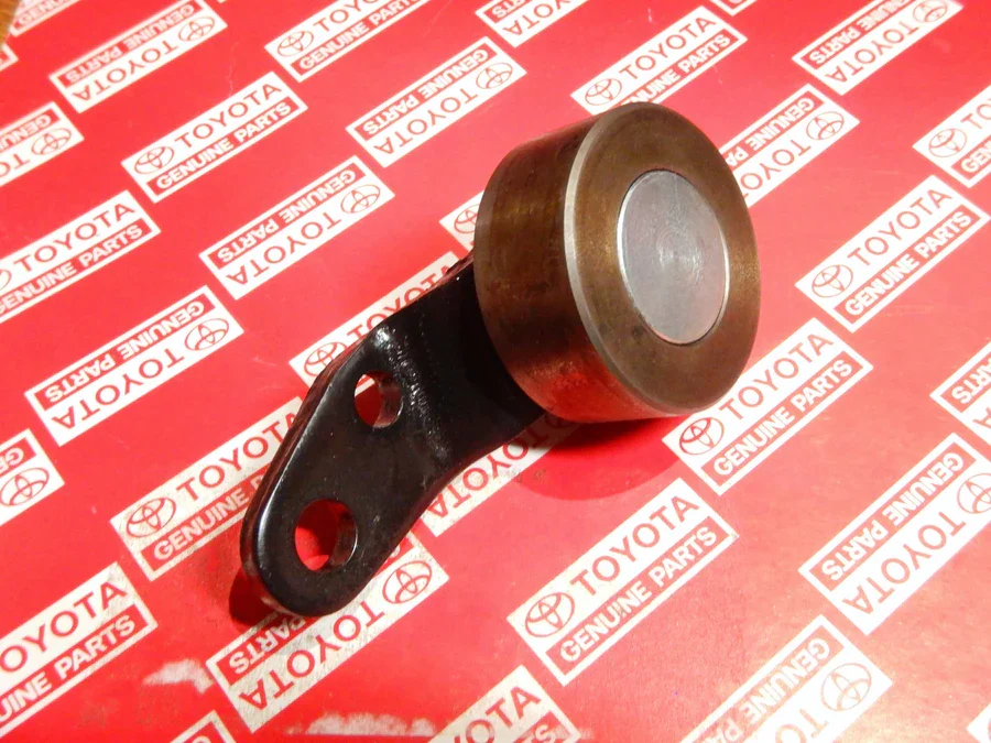

this is the IDLER pully
the air pump would be a tensioner pully there
