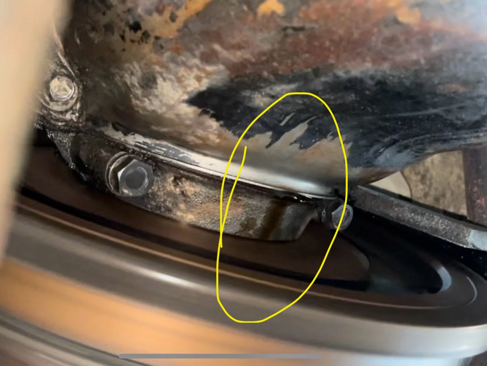

After cleaning the crime scene I decided to watch without the cover on. Sure enough after about 4 minutes of running, the leak is coming from the flywheel side of the crankshaft bearing cap(?).
Attached video shows the leak starting at about the 4:09 mark.
Can this be 100% said it is from the real main seal?

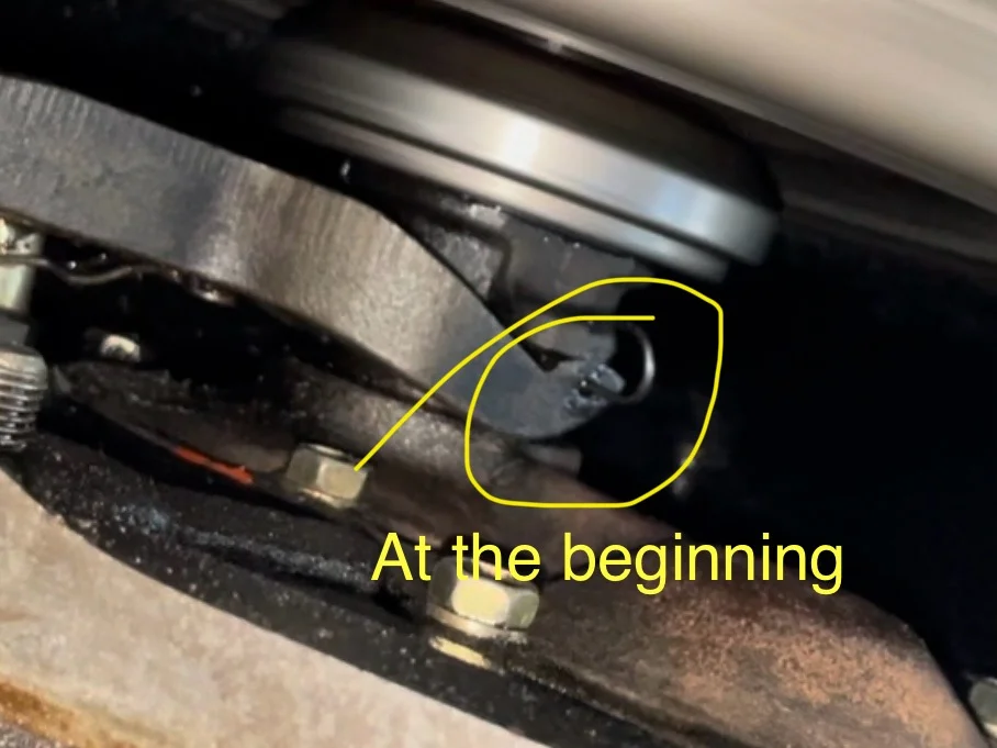

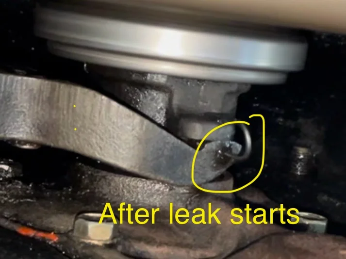

I also took note of the small oil accumulation at the hole where the retaining clip is on the clutch release fork, I’m assuming that is from the RMS also?
And took note of some wobble/ movement at the fork and release bearing assembly. Is that within normal limits?
I was hoping it was the oil pan but I feel that it’s not, although I’ll be replacing that along with the RMS.
Would like some input on verification and/or any additional information.

The clutch actuation fork is nowhere near the end of the crankshaft so any little drips falling from it while engine is running are moving because the engine is vibrating. You can see the fork vibrating as engine is running- activating any wet oil to migrate downwards.
It’s not a question if the rear main crankshaft seal is leaking — of course it is. All 2F engines with this many miles have leaky RMSs.
Is your oil pan gasket weeping? Of course it is. They all do.
Is the transmission input shaft oil seal leaking? Of course it is. They all do. (Which is likely why the clutch fork is wet).
To replace the RMS will require removing the transmission — which sounds daunting if you’ve never done it before, but it you get a proper transmission jack at Harbor Freight (not the cheapest one) it’s a very straightforward job. I’ve done it several times.
