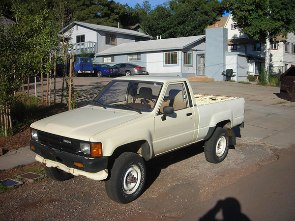

As this is a p/u/work/beater thread...I'll add a bit of my latest acquisition...
1986 Toyota Reg. Cab 4x4 w/22R...purchased for $1,500 from the original owner...203K
For the Expedition Trophy...I'll add....
New tires...235/75R15 Pathfinder radials (cheap!)
2 Wedco NATO gas cans in an Expedition Exchange rack
2 Scepter Water Cans, lashed
20lb. CO2 Tank
Sears X-Cargo top box for the light stuff...
High lift
X-Jack Exhaust jack
Snatch Strap/Shackles
Cheapo tools for the stock tool kit....
Med Kit
Maybe some Hella 4000s....
This stuff is just sittin' in the garage....
