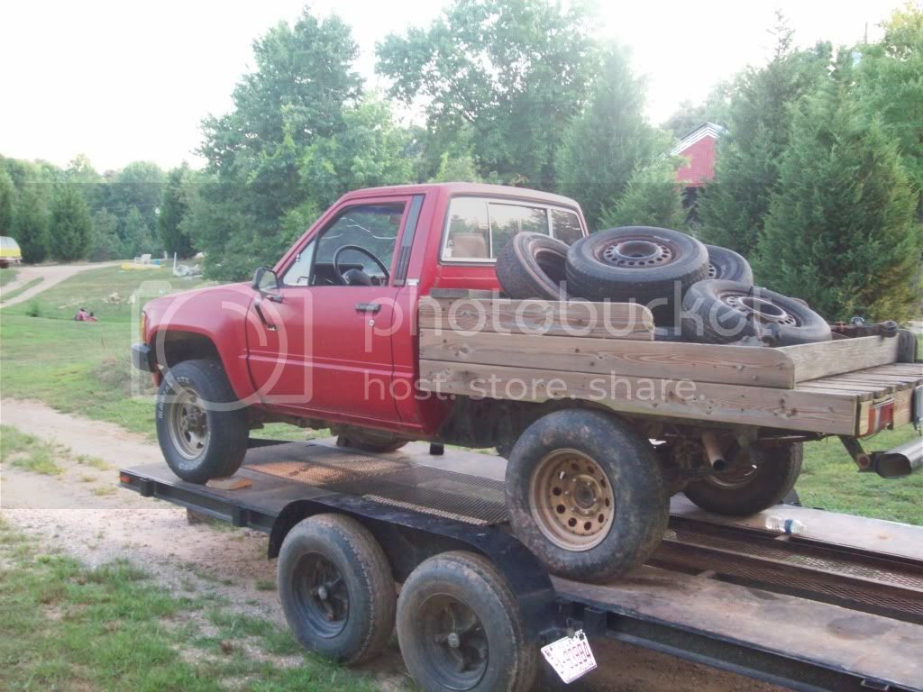

But here is how she started out (as a little farm truck)

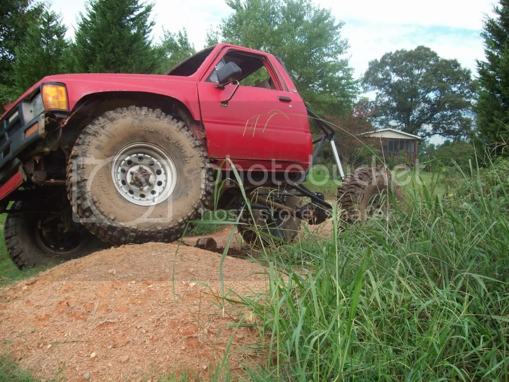

Now after a bit of beating on her. With work done to her & adding some small accessories here & there

Since this picture I have cut the fender wells, sold the km2's & its now sitting on bald boggers, fixed the rear link suspension problems, front trail-gear axle rebuild.
It is open/open & has performed surprisingly well. Have kept up with quite a few well built rigs through some tough trails.

How much is invested in the whole rear set up
Honestly not much, its not done with top quality parts. Works fine for now but will upgrade it to beefier links eventually. If you do the work you can probably knock this link setup for $100 (cheap hiems)

Do you have a crossmember can you plz post more pic or how your 4 link is set up I was looking into doing it
Stock crossmember. Outer Link brackets are mounted where the frame was cut off. A bar is welded in between the frame & the inner link brackets are attached to it. Just recently added alot of support due to it kept ripping the bar welds.
