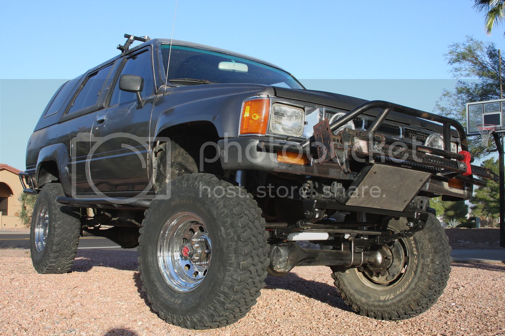

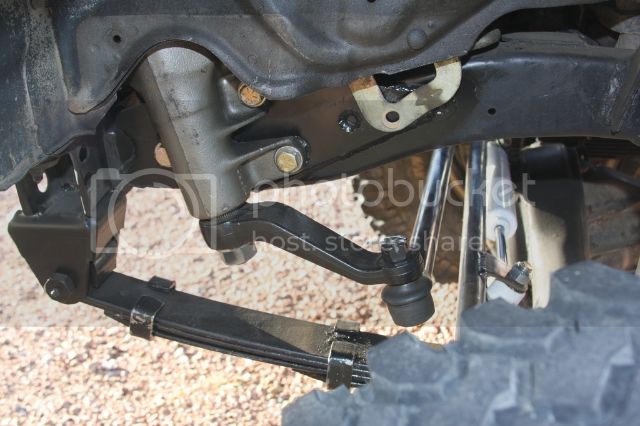

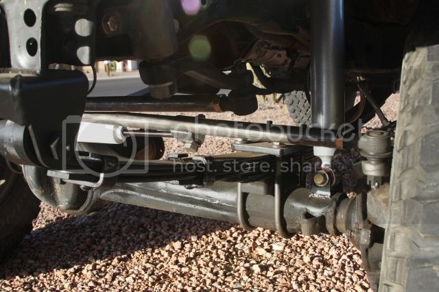

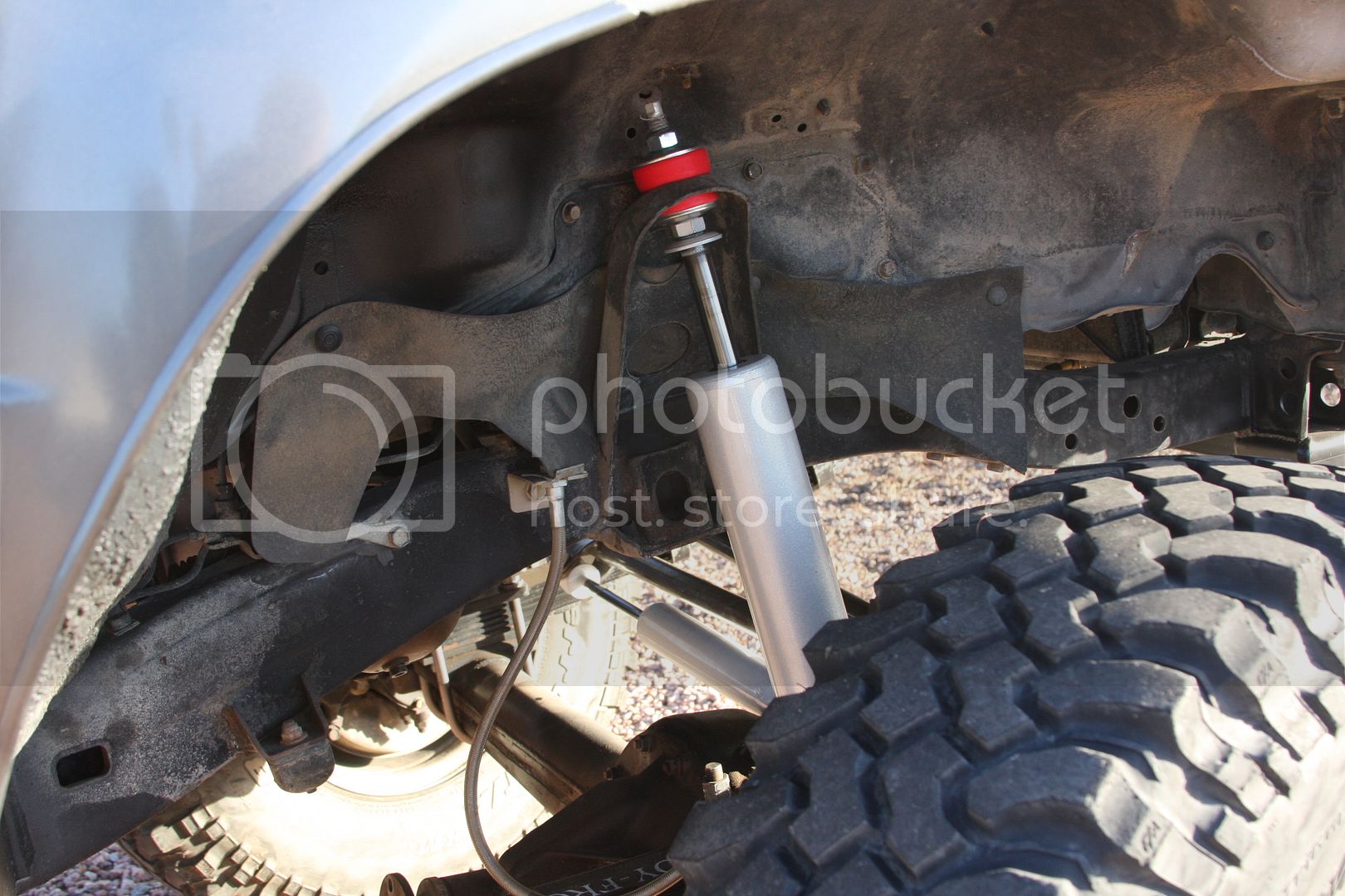

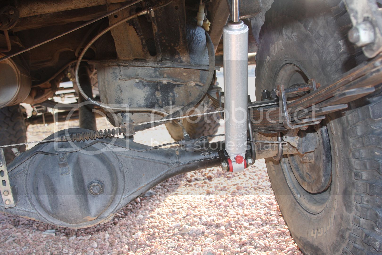

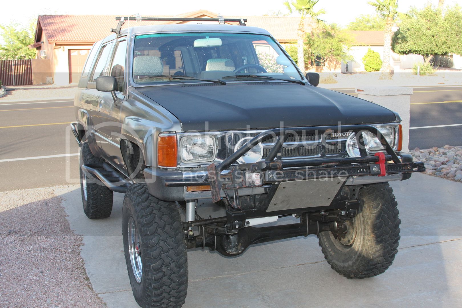

Update time... went ahead and got the AP springs and spring hanger. And the matching rear springs. And new shocks and a Tom Woods driveshaft. And all the little things. Love the way it turned out!
Pictures PLEASE!!!
Patience, Grasshopper.
As requested...
[/URL][/IMG]
It's not staying on the 33x9.50s for ever... plans are 35s at least, and I'm looking for a set of 93-94 FZJ80 wheels. And 4.56 gears. And a tire carrier/bumper. And a better roof rack deal. And either an engine rebuild or swap.
